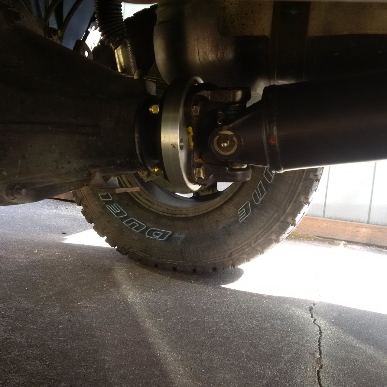

    after i swapped my stock 3-leaf springs with a 4-leaf se t from a 2016 TRD and added a wheeler's progressive AAL, i noticed i had the dreaded grinding from my driveshaft. it sounded awful...like something would snap at any time.
    i read some options on here such as flipping the driveshaft or adding shims or adding a driveline spacer. the last one made the most sense to me so that's what i tried. i ordered a 3/4" spacer from 4crawler.com, installed it in about 15 minutes and it worked! smooth as silk now.
    i suspect the splines were not making optimal contact after the lift. they do now and seem to have plenty of play in either direction for rear axle travel.

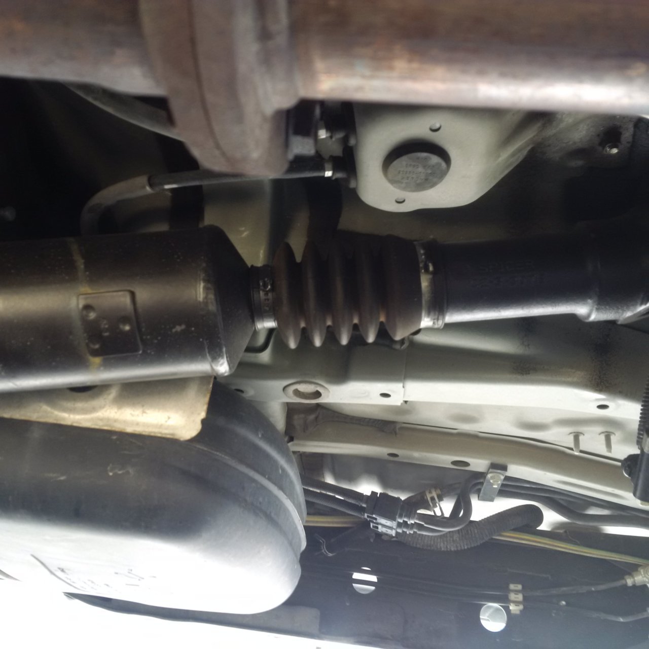

    Strange, your drive shaft looks totally different from mine.
    So this spacer goes between the differential and the drive shaft?

    in my case, yes. the transmission side had studs that would've had to have been removed and longer ones pressed in

    i'd say this is a fix if your slip yoke has separated after you lift the truck and the driveshaft needs to be longer. what i experienced was both vibration and an awful metallic grinding noise, mostly on deceleration.

    When I first joined in 2011 I found all the threads on TW about the regular cab "grinding"noise on deceleration, which I had. After much trial and error, I also came to the same conclusion that the slip joint was too loose like the OP. You can actually feel this if you crawl under and shake the driveshaft back and forth there's a slight "clunk". Spacer is worth it in my opinion, but just be careful about how much reduction in travel the slip joint has after installation.
