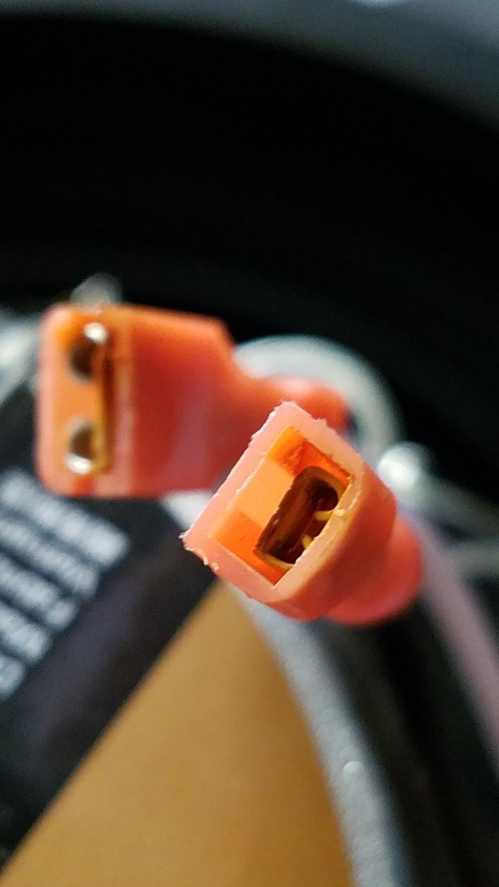

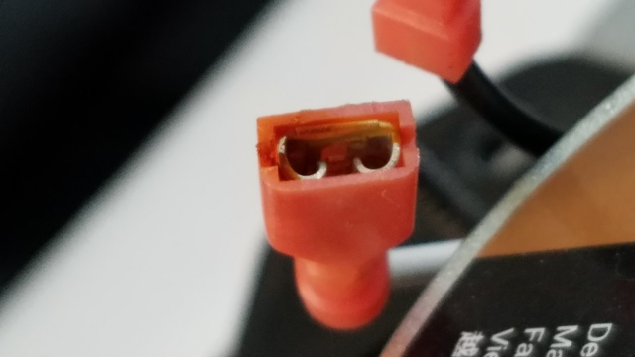

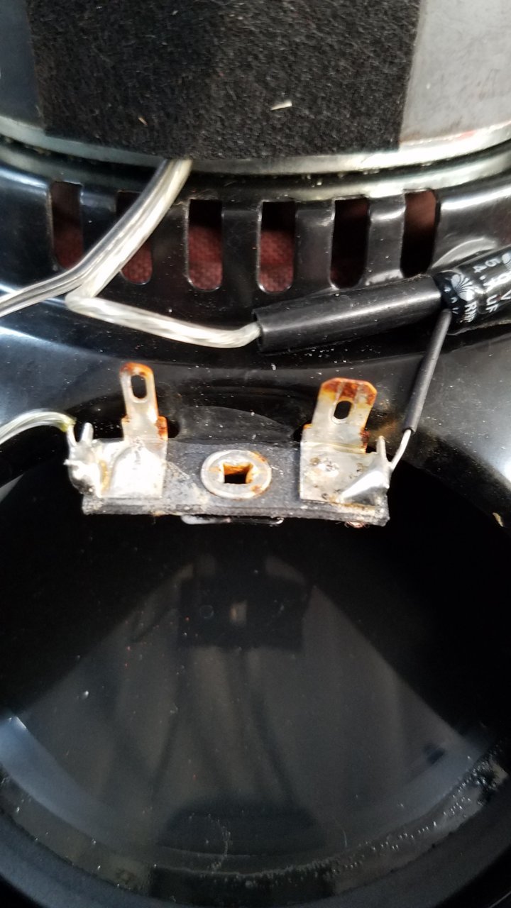

    Update: removed the non-working infinity speaker and connected my o.e. speaker. It worked. When I installed the infinity's, they came with plug and play harnesses. I then ohmed between the toyota connector on the harness and where the spade connects to the speaker. No continuity. I removed the spade connectors from the speaker and found rust. On the speaker terminals and inside the spade connectors. I cleaned the terminals on the speaker than replaced the spade connectors on the harness. Also added dielectric grease. Now everything works. Very rarely have I ever seen rust build up in this area.
