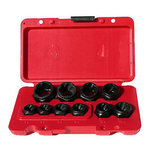

    IMG_1149.jpg There is a bolt removal tool I know craftsman has them sure the other major brands do also

    Any of the sockets made for damaged nuts are a great investment
