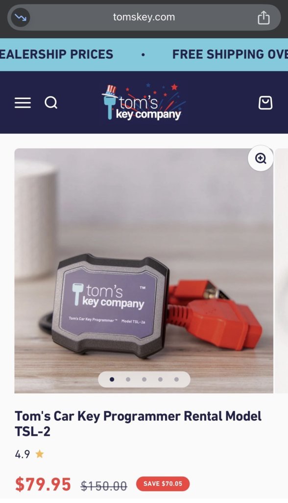

    Tom's Keys programmer
    Tom's Keys claim 4. I've seen 5 on other reports.
    I received 2 fobs and a valet key. I ordered two keys off Amazon that matched the FCC id. The first key I programmed took. Then I programmed the second and it blinked 2x then 3x. When I went to try the first key again it blinked 2x then 3x. Tried to reprogram it and kept getting the same result.
    Phlogiston[QUOTED] likes this.

    So just an update. I had to get the older programmer from Tom's Key. The newer one doesn't allow you to remove or delete key fobs.
    The older programmer comes with a phone and an app (they don't picture it on their website when you buy it but it comes in the box with the OBD2 device).
    I was able to remove every key except the original and then program the new keys. All work without issues. The key fob works, the keys turn in the lock and open the driver door and bed and they all start the truck in the ignition.
    The TSL-2 (the purple box) is the one I needed.
    https://tomskey.com/products/tom-s-car-key-programmer-rental-2nd-generation
    The TSL-1 (orange colored OBD2 device) only lets you program and add keys. You cannot delete keys with this programmer. This programmer doesn't come with the phone and app.
    Also the TechStream software I have, doesnt work because my bare bones Dell laptop doesn't have the proper system resources to run it. Which sucks.

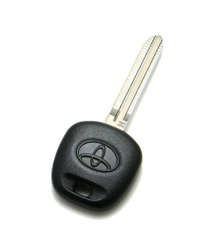

    Do you have a MT with the H key? I have been looking for a valet key for my 2023 TRD Pro with 6MT, but cannot find one and the dealer is no help.

    I have a 6MT, so it does not come with push button start. It has was is known as an "H" Key, which is a conventional fob with lock, unlock, alert, etc., that you put in to the ignition switch to turn on the engine. Is that what you have, and if so how did you get a valet key? The Tacomas with push button start have a fob with a removable metal key that can be used to lock the glove compartment. Then the fob, minus metal key is given to the valet. Which key do you have?

    Named for the "H" stamped on the key.

    My truck came with a valet key and a standard key fob.
    But the main key is an H key and so are the extras I ordered off Amazon.
    This is where I got my replacement keys. I either have 4 or 5 keys total now. Can't remember.
    https://a.co/d/hts3ntY

    All four of my keys are stamped with an "H".
    All four work, all four unlock doors and start the truck. So maybe I don't have a valet key afterall.
    I thought I did.
    So maybe check Tom's keys, Denso and Amazon and ebay for what you need.
