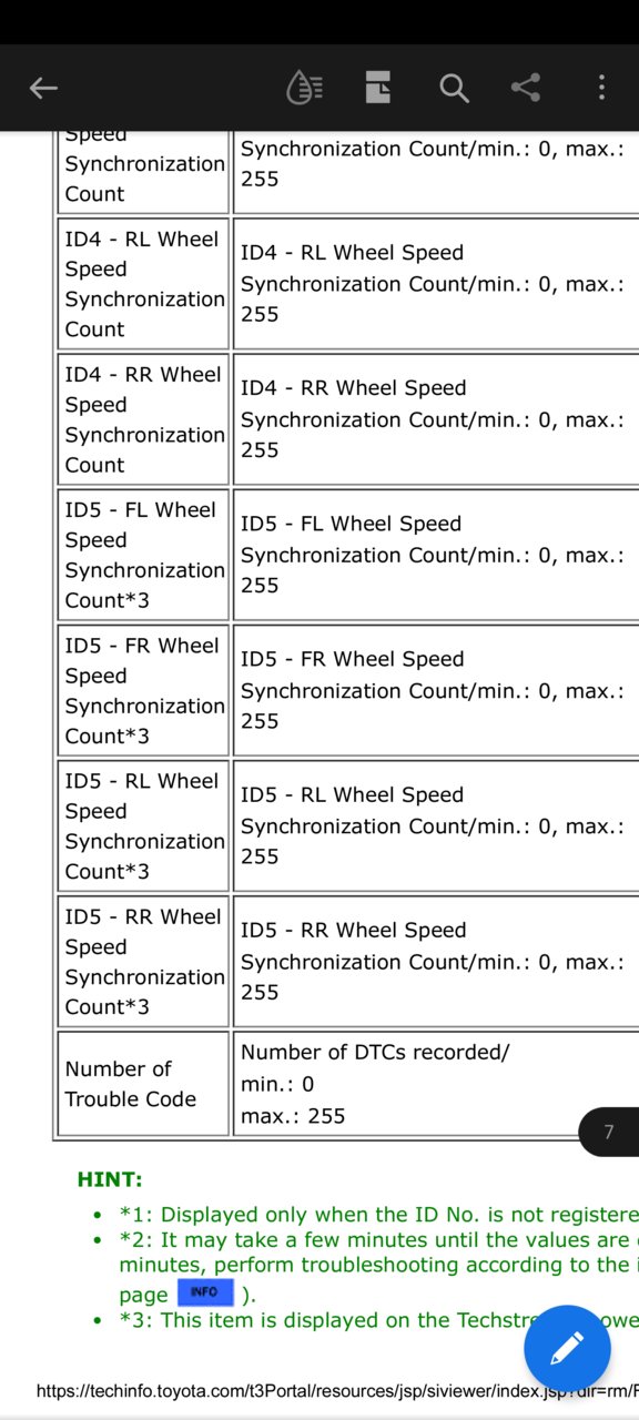

    Bilstein 8112+650lb coils, 8100+Deaver Stage II leaf pack, SPC UCA, DuroBumps, Mobtown 0* sliders W/fill plates, Mobtown Recovery Bar, Radium PVC & CCV Dual Oil Separator Catch Can System, Snugtop Hiliner Sport, ATH bed Stiffeners (cuz bottle openers!) + front corner tie down, Badger plates for Firestone airbag + Relentless U-bolt flip + Daystar cradles, TRD Pro shift knob, TRD Exhaust, HPS Silicone intake tube, Green Filter, TRD Intake Air Accelerator, 265-70-17 Toyo Open Country ATIII on TRD 17" Rockwarrior Cold Forged wheels, TRD alloy front skid, RCI Aluminum transmission & transfer case skids. Much Meso awesomeness, FreshMexicanTaco TacoGarage Camera Controller + DDM, 67 Designs cradles, Banks Pedal Monster + iDash gauge, WarFab Sheridan hitch skid, Ricochet LCA aluminum skids, Rago lower rear shock guards, FN Koning Countersteer 16" spare, OEM T4R 90105-14104 coilover lower mounting eye bolts
    There have been a few people here that have tried it and have had the TPMS system crash.
    The early 2nd Gen do allow a 5th sensor and the later 2nd Gen do not.
    2nd Gen sensors Do Not work in the 3rd Gen trucks, I know this for fact, twice as I bought two sets of wheels off 2nd Gen trucks and spent too much time thinking they would work.

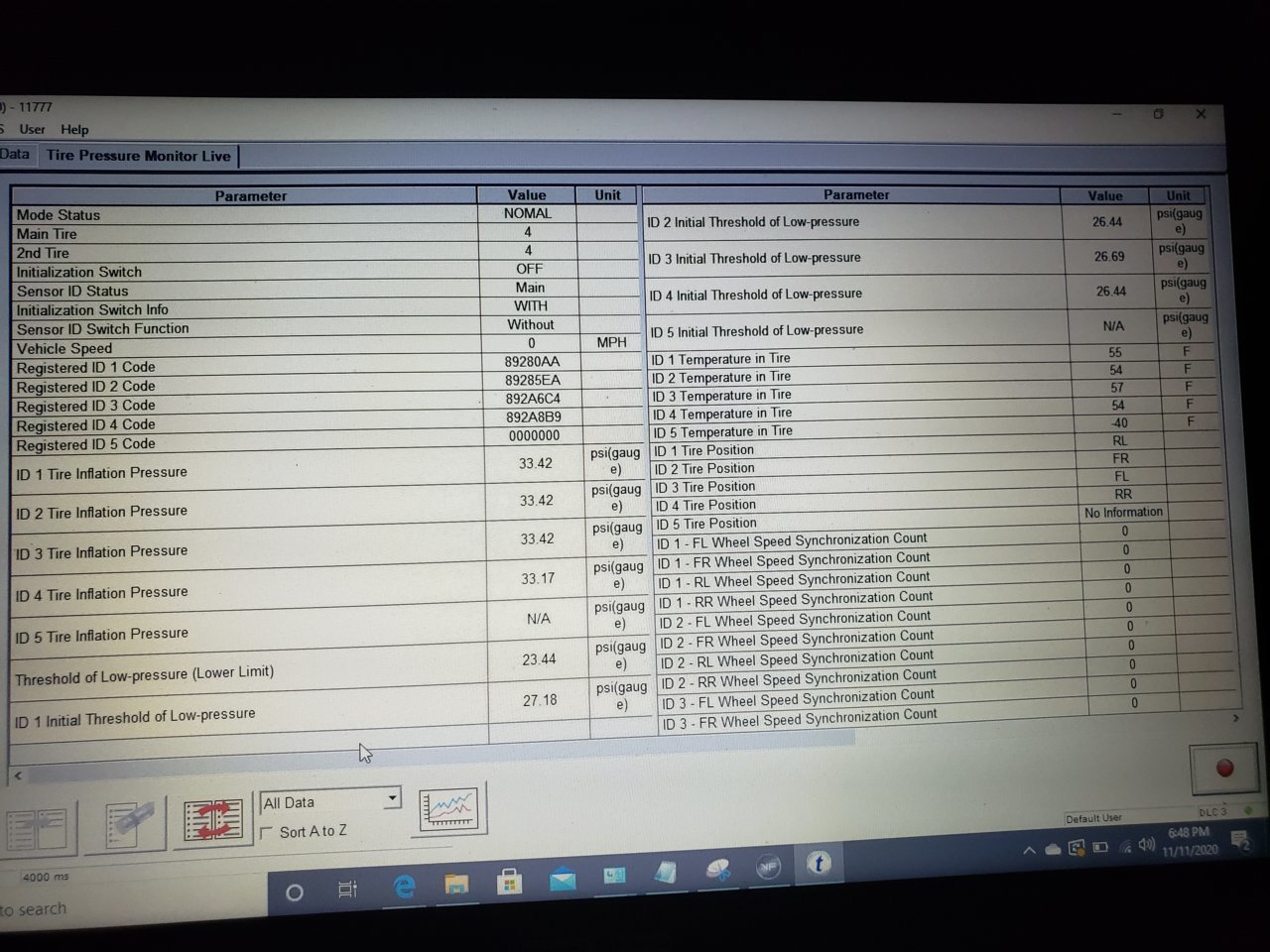

    Your screen picture shows 4 sensors showing temps and pressure. The 5th shows nothing.

    3rd Gen TPMS PCM system only allows 4 IDs to be programmed.

    Cause I don't have 5th sensor programmed.
    Techstream is set to enter 5 sensor IDs.

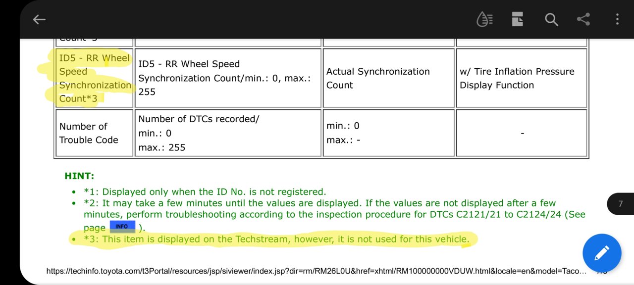

    It is not set up for 5 sensors. That's just Techstream.
    There's an example from the repair manual for the 3rd gen explaining why you see the 5th sensor.
    eurowner and SR-71A like this.

    Yes
    Here's the file. All ID5's have the note that it is not used in the 3rd gen.
    Vlady[QUOTED] and eurowner like this.
