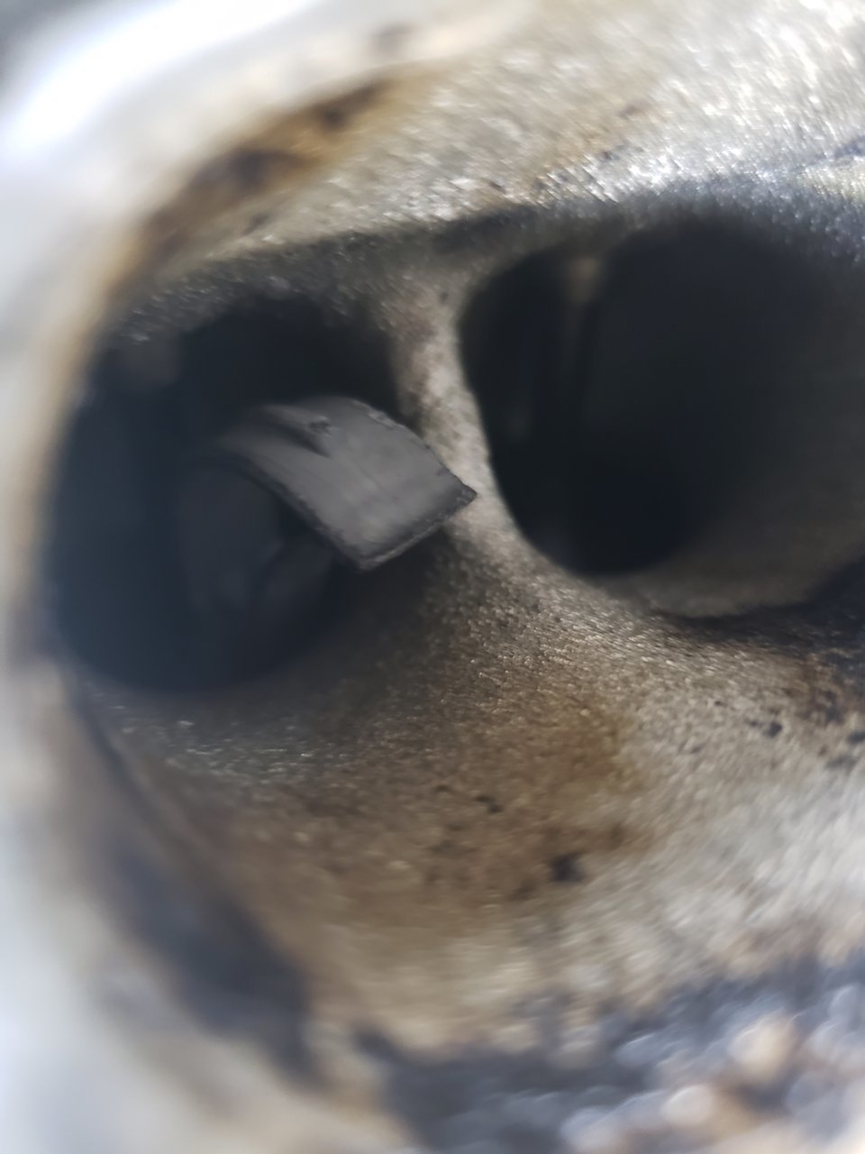

    I dropped broken wiring loom plastic into an intake port once. Engine ran great at first. Then started knocking/misfiring. Large piece of plastic wedged itself between the valve/head and wouldn't allow the valve to close. Took a while to figure that one out. Engine still runs great til this day.

    Ehh. OP I wouldn't keep running it if something is wrong. Not likely to fix itself.

    Yes attempting to start the engine could do harm, depending what your issue is.
    Spark plug wires hooked up correctly?
    Coil packs bolted down?
    Vacuum lines all connected?
    Valve cover bolts all tight? (Since you didn't torque them to spec).
    If everything checks out, then might have to undo all your hard work. Work your way backward until you find the problem.
