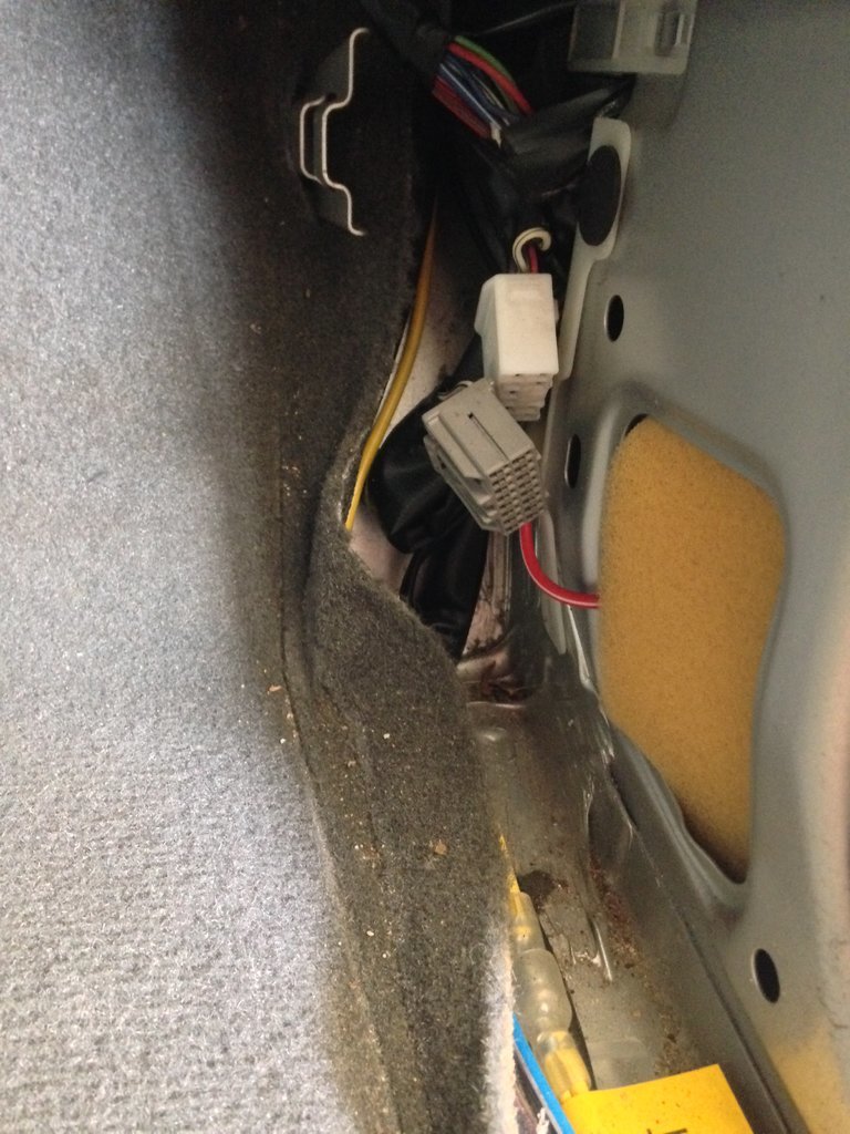

    I checked the kick passenger kick panel but no computer. I'm pretty sure that I have a plug though for cc hookup. It's the only. Plug on the passenger side of engine bay where the acurator would go. What does the little computer plug into behind the kick panel? What else do I need and how hard is it?

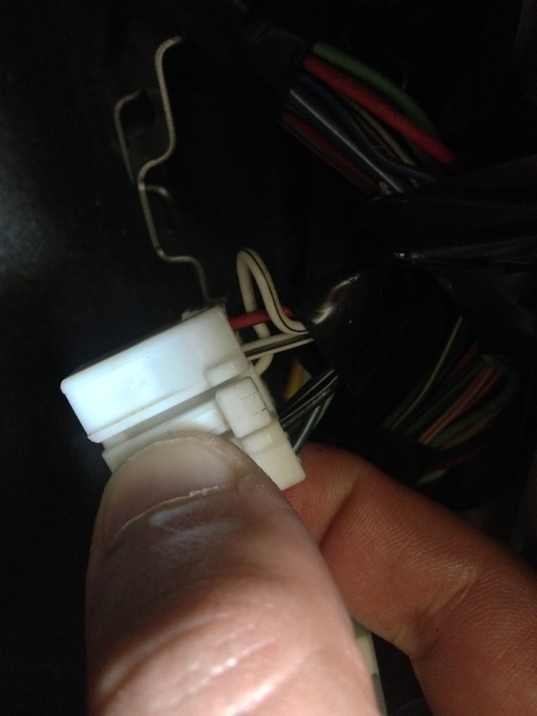

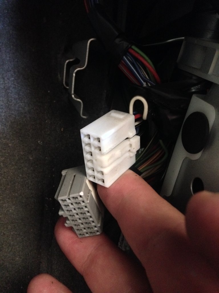

    Under the passenger kicker panel there is a white plug and a grey plug, both are just hanging, do they plug into the module that Is supposed to go under the passenger kick panel?

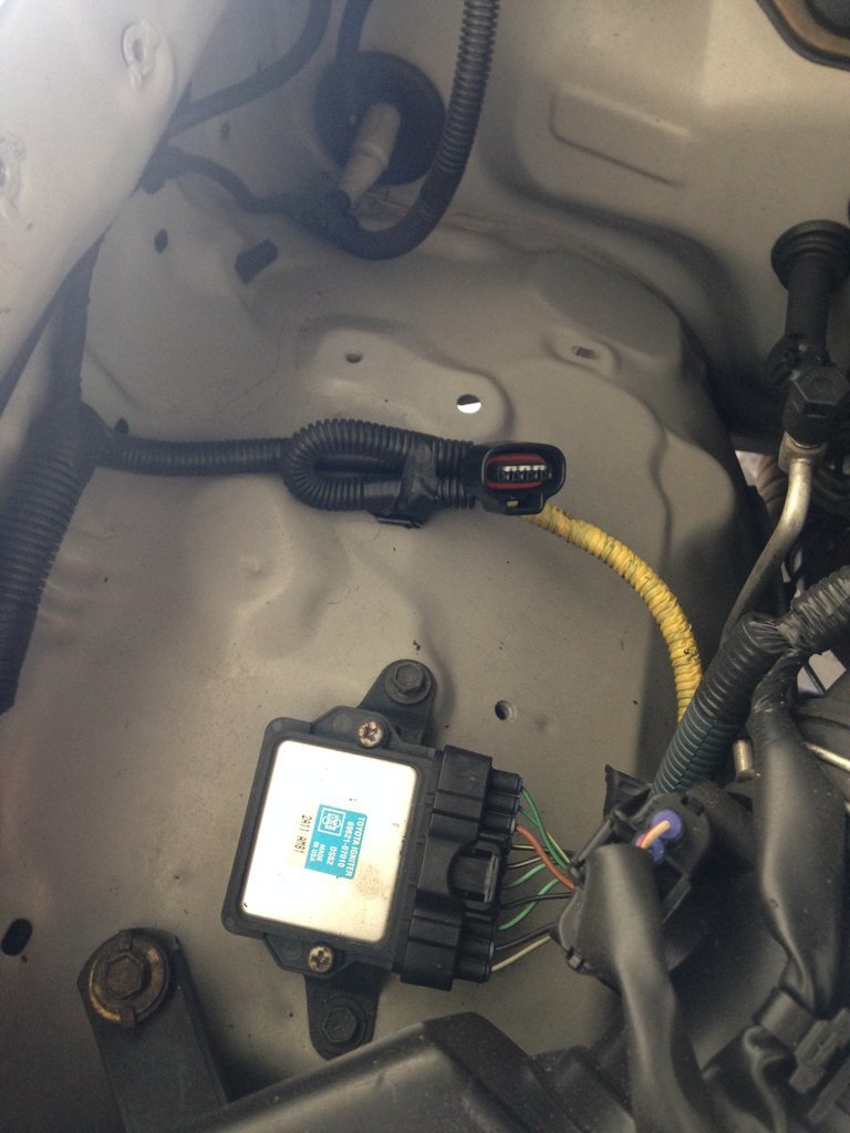

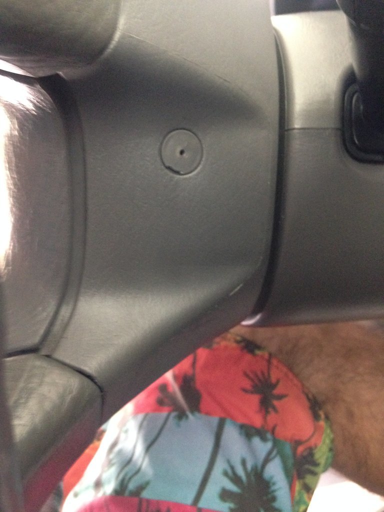

    See the faint line on the right side of steering wheel. Almost looks like a pop out so I can insert the cc physical stalk.
    This is much passenger side engine Bay. Notice the plug.

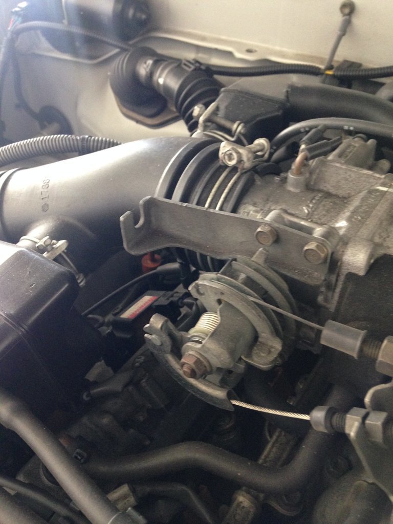

    What's this bracket on the throttle body? Is it for the cc cable?

    Damn it looks like you have the hookups for CC already. The bracket on your engine is for the throttle cable. Take a pic of behind your kick panel.

    I will grab a pic. But I know the module isn't there. Took the panel off earlier, lol. However there are two fuse blocks, one white one grey. Just dangling waiting to be plugged in. How does the cable connect to the throttle body, once I get it?
    So basically I just need to buy the accurator and computer module under kicker panel plug them both in, and that's it? @multimediavault

    Yeah, 2004 is drive by wire'ish. There's still a throttle cable that goes into the firewall but pulling it won't get you full throttle. Electric motor opens the throttle all the way.
    [​IMG]Untitled by chris tsay, on Flickr
    There's also another electrical connector going into the other (not pictured) side of the TB.
    Here's the cutout on the steering wheel as done by the factory. There's a plastic felt flexible cover that keeps it looking tidy:
