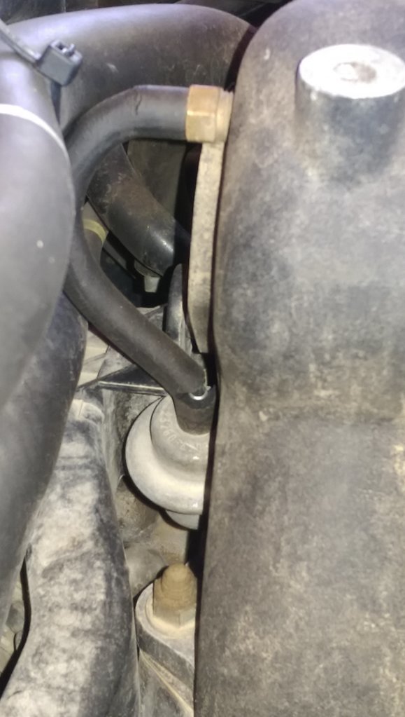

    I think I found the problem....

    Yep, that was it. Replaced it with some spare vacuum hose I had around and the whistle is all gone. Yay!
