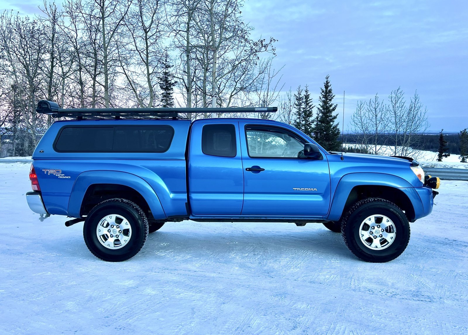

    I went with 5100 in the front with OEM coils set at the 3rd circ clip (1.75”) No issues with my stock UCA and solid Alignment numbers.
    5100 in the rear with an Icon AAL and absolutely love it. zero issues and the rear leafs holding the topper and also allowing me to tow 300 gal of heating oil at roughly 8lbs per gal. Never squats or shows any signs of being taxed. i personally like the stance of the setup as well. this exact setup has lasted me over 100K.
