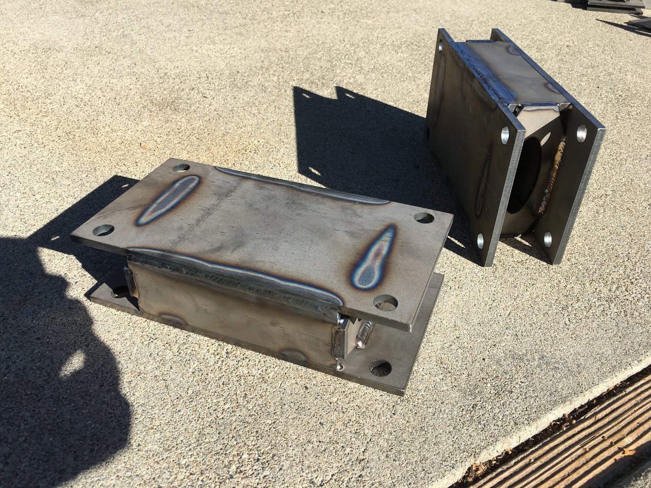

    Examples of Jerry's fine custom fab work. These are for a boat trailer.
    Axle perches. Basically a "lift block" for tor-flex torsion axles. (Axles with no leaf springs!)

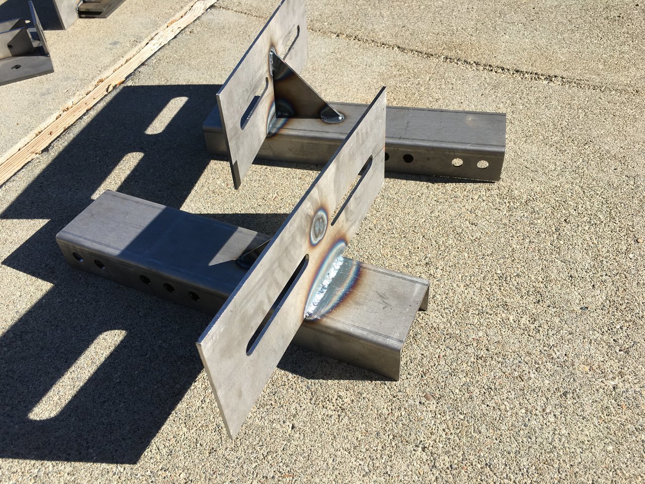

    Custom fender brackets. These let me reposition the fender, so I can move the axle a little further aft to get a little more tongue weight.

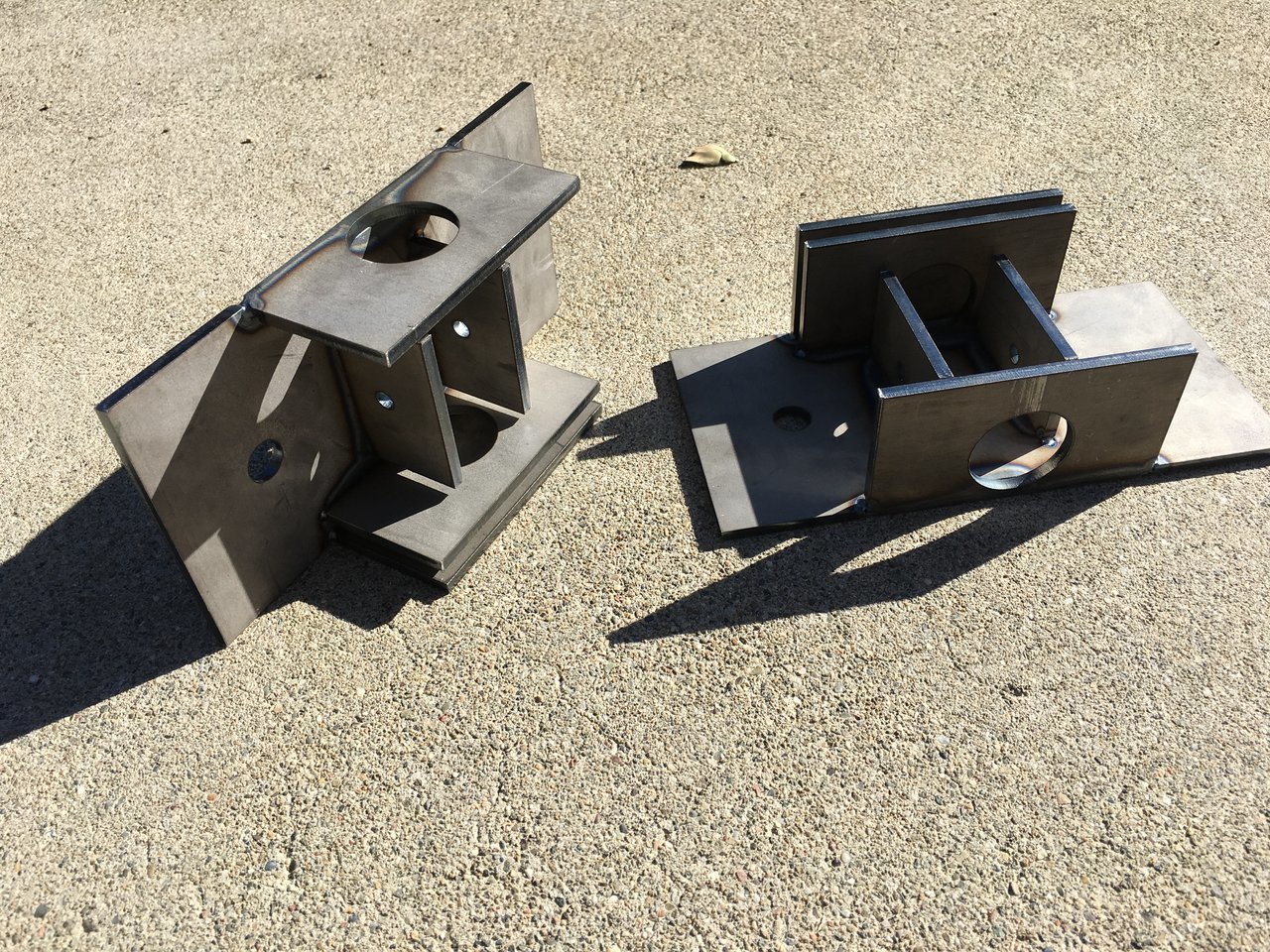

    Goal post mounts let me put on "goal posts" to aid in centering the boat on the trailer during retrieval.

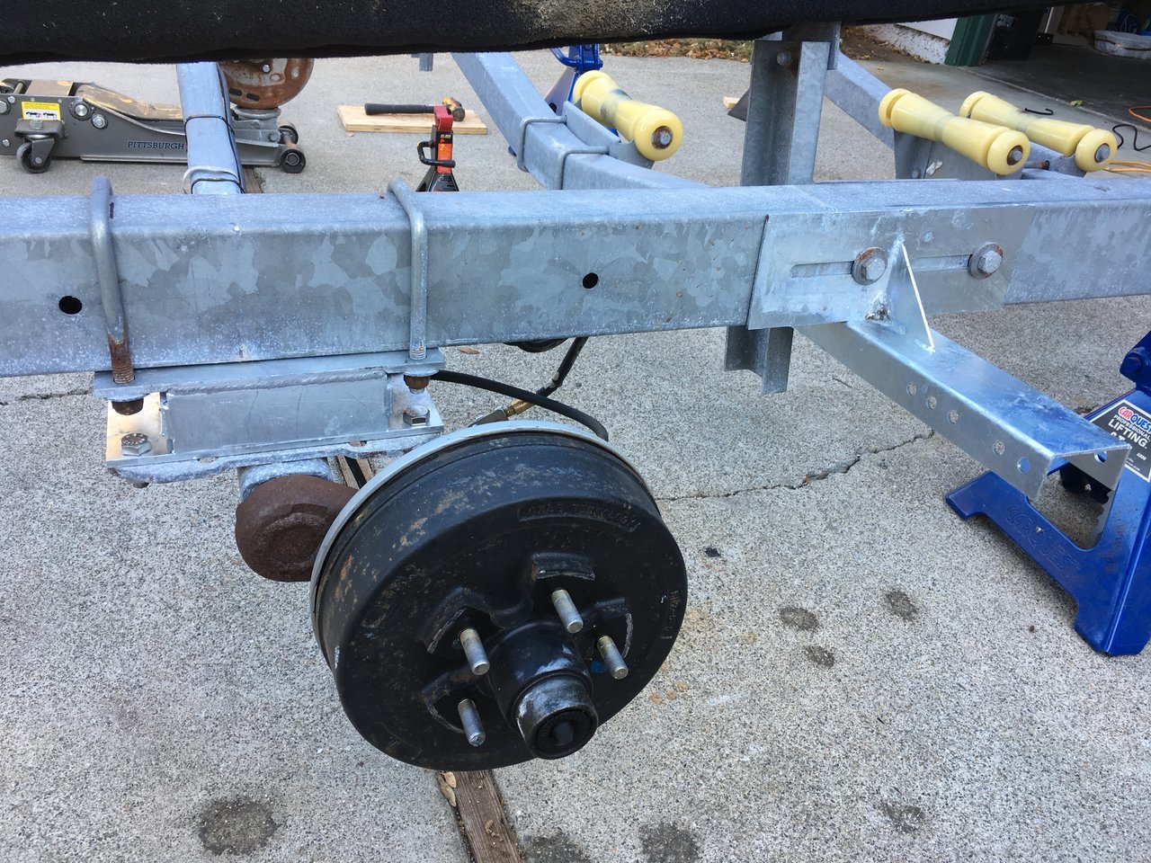

    Installed, after galvanizing: (bolts aren't torqued down yet)

    Looks good Steve glad it worked out.
