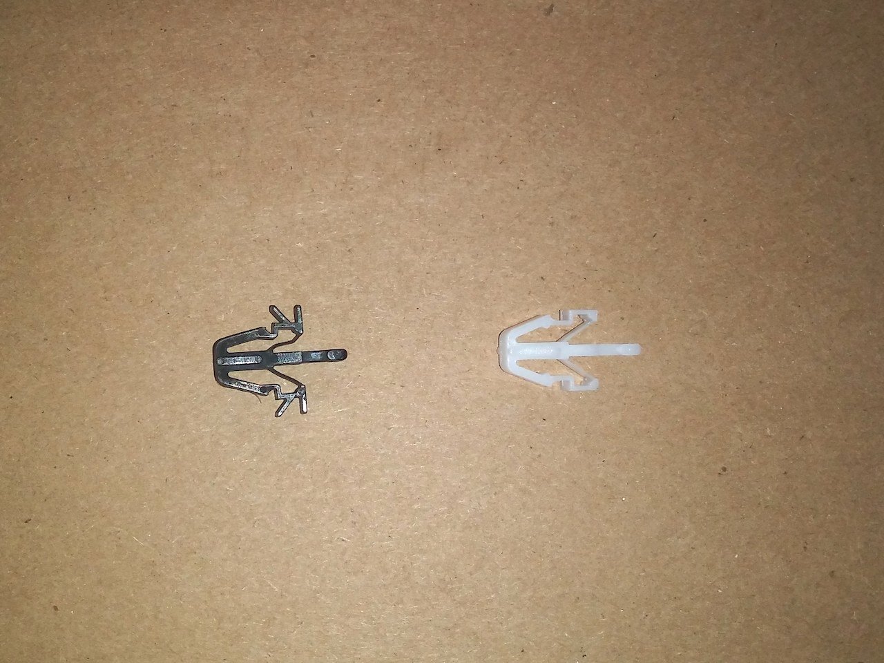

    The old clips removed easily once the grill was popped out. All you have to do is turn them 90 degrees and they are in your hand. I'm going to give a hint on the 2 clips under the headlights. A screwdriver is nearly useless for them. Stick your finger back in there until you feel the 2 ends of each clip and then wiggle your finger in there to spread them. I didn't find that hint in any tutorial on grill removal.
    Something interesting I noticed is the the original grill and the new replacement grill have slightly different clips. Both grills are genuine Toyota. The old clips look more secure to me. I was wondering if anyone else has noticed them or has an opinion on the change.

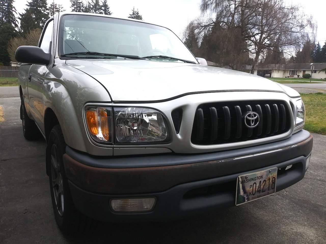

    Some jackass undone!

    Did you rattlecan it or did a shop do it? If the former? What did you use? Looks real good.

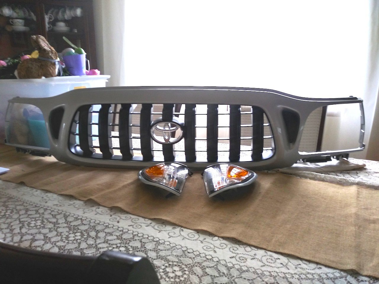

    The grill parts are brand new from Toyota. The silver body color grill set are part numbers:
    5310004250B0 Grill
    8161004090B0 Right Marker
    8162004090B0 Left Marker
    The total cost for all 3 parts from Marysville Toyota was $348.71.
    The headlights are CAPA approved aftermarket and cost $110. They perform a LOT better than the hazy OEM units I had!
