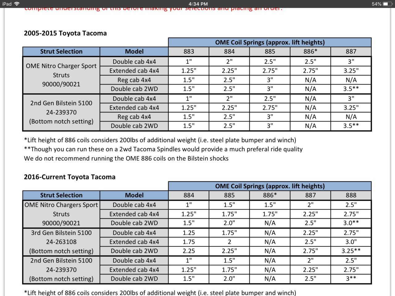

    1. The guy I spoke to said that as of right now I could get 1.75 inches of lift but I could adjust the 5100s to 2 inches. That doesn't seem right to me. Isn't the shock restricted by the coil?

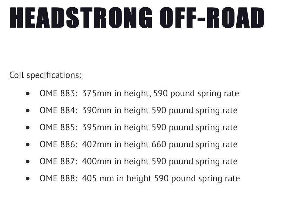

    The 886’s are not recommended for use in 5100’s.
    You might want to look into the 884 or 885 springs.
    With the number and winch you’ll probably want a little over 2” to get down to 2” with weight.
    Refer to the chart above as to what will work best for you.
