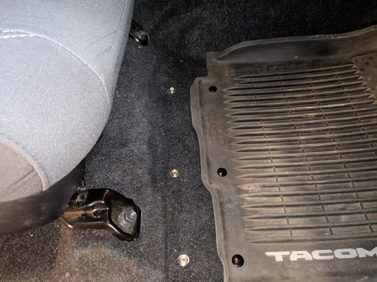

    I've done these many times on riding gear, so it was in my wheelhouse since I wasn't exactly feeling the Eagle Claws and such. I don't know why, but snaps gelled with me.
    If anyone else goes down this rabbit hole, use a 10mm socket and vicegrips to apply pressure before you go hammering on the anvil for the carpet side. It is on the edge of being too thick for typical 'heavy duty' snaps.

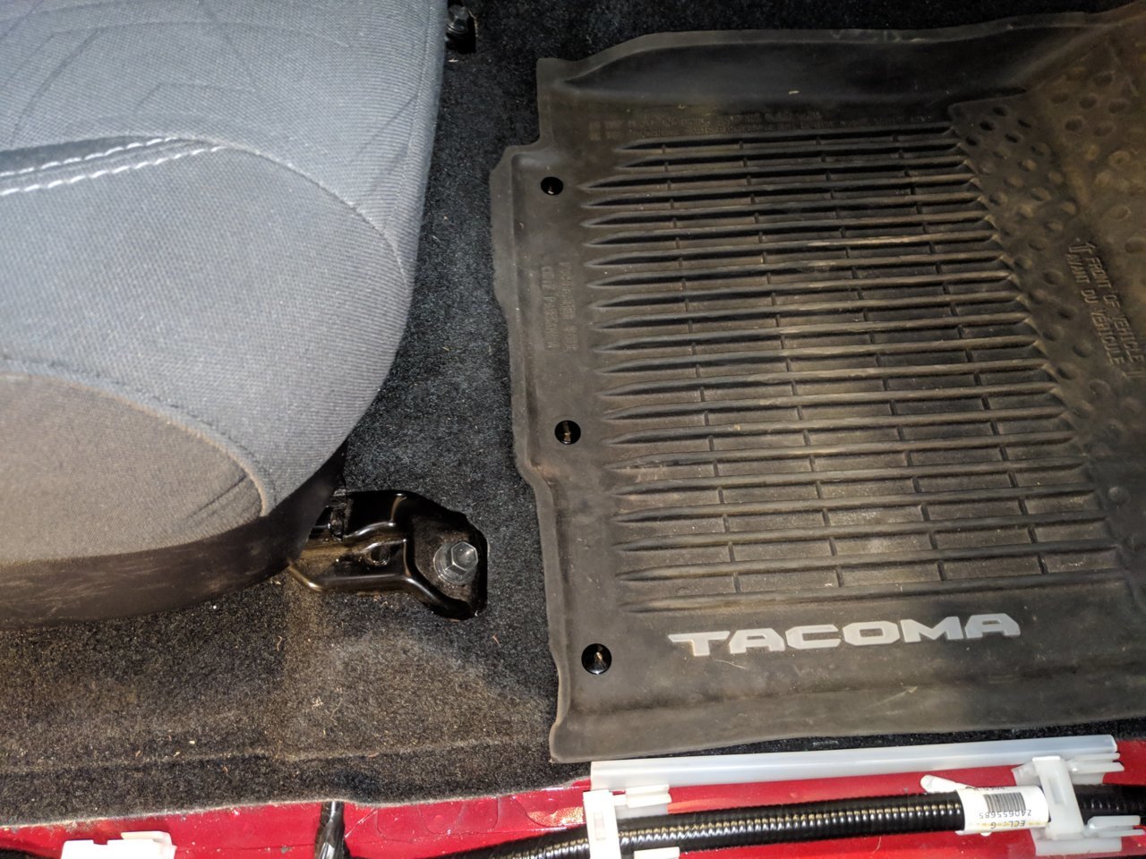

    I did the exact same thing. Find some black snaps on Amazon, they come with the installation tools. Pull back the plastic edge between the carpet and door and you can go under the carpet to install, very easy, and very effective. I only used 2 snaps and have no issues.

    I got the mat where I wanted it and held it in place while I removed the trim. Door trim first, then the kick panel. You need a small, long screwdriver to disengage the carpet clip.
    I would have been happier if I had something under the carpet for the bit to hit, but that would have caused the holes to misalign.
    I used a 1/8in drill bit to make the matching holes in both the mat and carpet. There is thick padding underneath, so if you are careful, you won't nick the cab.
    Once you get through the carpet, ease the drill out as you will pick up a small wad of carpet and pad on the tip.
    I used a phenolic block under the holes to help set the snaps. Like I said in the OP, I also used a 10mm socket with vice grips to push down as much as possible while setting the snap. I found this to be important in the past.
    That was the hard part. The snaps on the mat are a walk in the park by comparison. As a warning, I did get a few scratches as there is both sharp metal and ends of staples under there in some spots. No pain / no gain, right? Might as well leave a DNA sample here and there?
    I used the same bit to ream and clean up the holes in the mat.
    From there, just put the trim back on and enjoy.

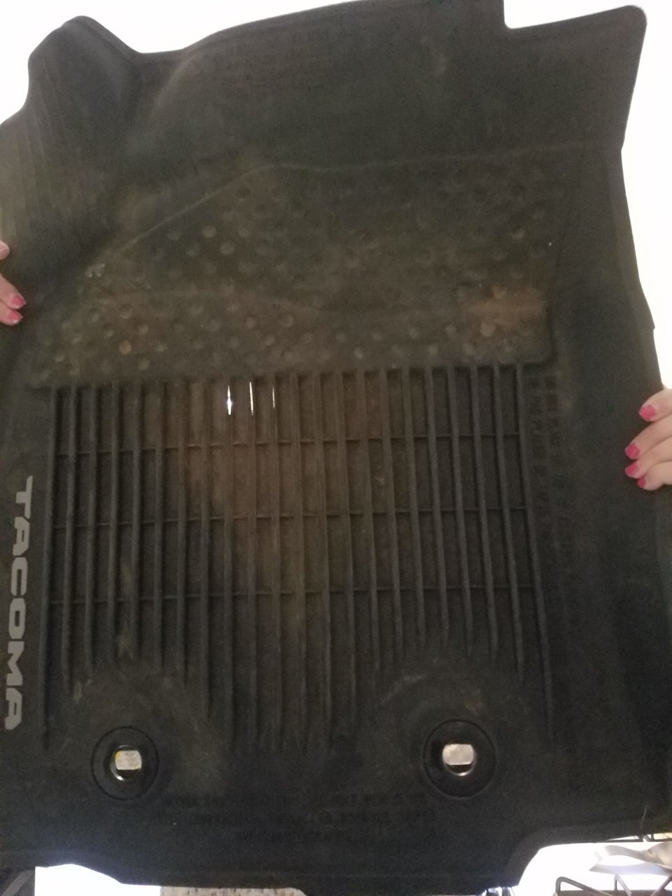

    Get out there and do some driving! :burnrubber:Here's mine after it failed. MT work boot wear :rofl:you'll find yourself in the same situation eventually. Do yourself a favor and just replace both now.
