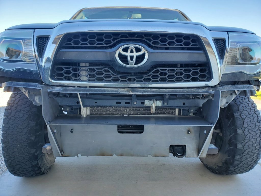

    What lift, alignment numbers, and tire psi are you running? That tire wear is excessive and will get costly fast. At the very least, have an alignment check.

    Looks toed out to me.

    Tire cupping can be caused by poor alignment or worn shocks.
    Low tire pressure will aggravate the problem.

    Agreed. In one of the pics he posted it also looked like the outside tread was in rough (not as bad as inside) shape. Wondering if it's a combination of toe-out and under-inflated...

    I'm at about 34 psi in front and 30 in rear.
    I've had it aligned multiple times and had all my suspension components checked. They said I might have bad shocks (bilstein 5100) they've been on for about 70k now

    More than likely your truck is toe’d in or out to much. Will need an alignment
    it could be excessive camber, but I doubt that.

    What upper control arms do you have?

    They're stock

    I would look at shocks first, then ball joints and tie rods. Assuming they all have 70k on them.... any off roading??

    I offroad a fair amount. I have a gold mining claim in Wickenburg that is on some really rough roads. The truck has 105k miles. The shocks are pushing 70k probably

    That's your problem most likely... but the ball joints, upper and lower can cause this issue as well. Even if it tracks straight and drives fine.
