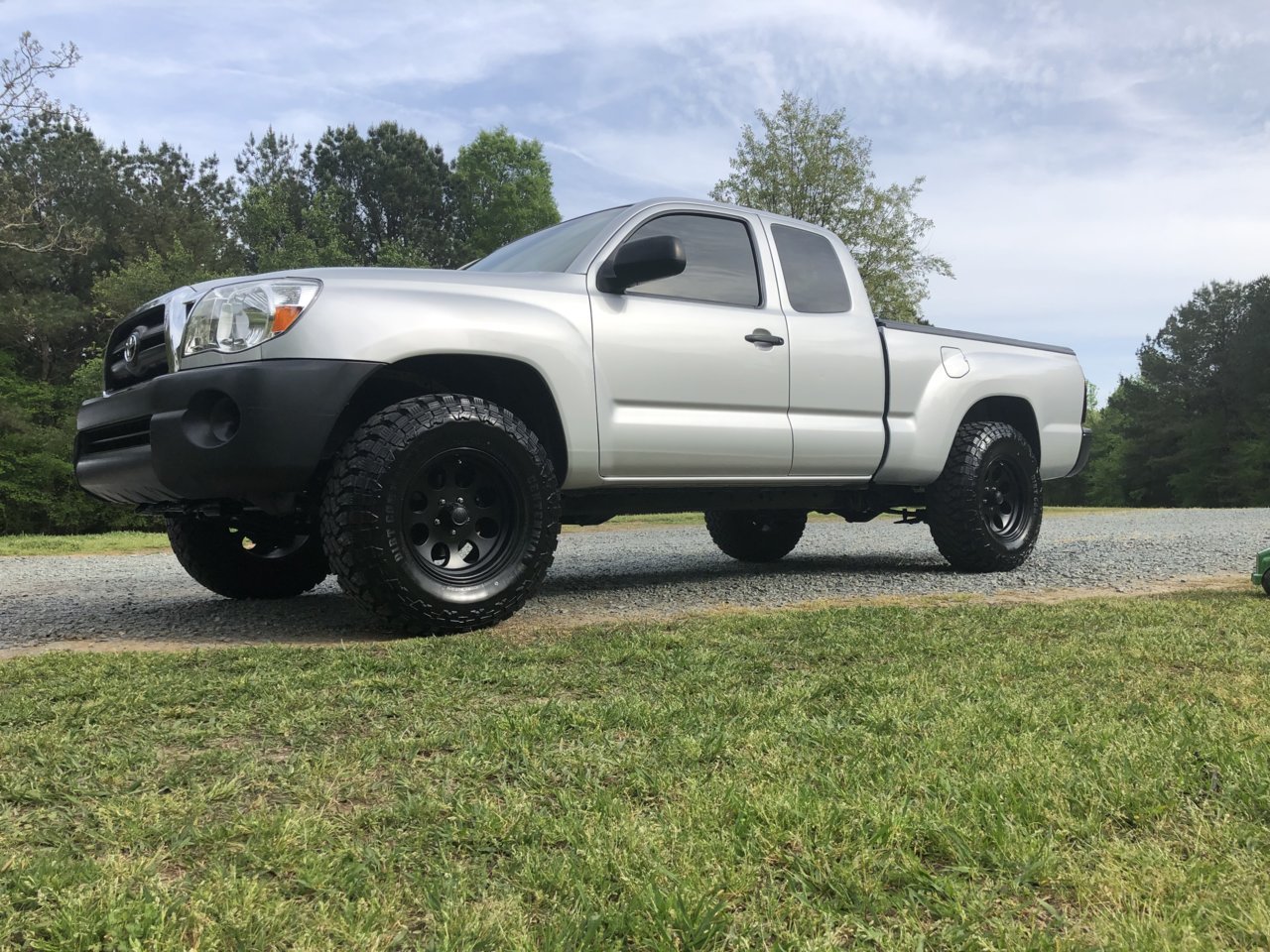

  14. Apr 20, 2019 at 6:09 PM
    Babybluetaco
    Babybluetaco Well-Known Member
    Dec 9, 2018
    #275343
    1,834
    Austin
    Monroe, North Carolina
    09 5 lug
    eBay steel welded spacer up front. Fat bobs add a leaf in the back. Bilstein 5100 6 lug 1” lift rear shocks. 31x10.50-16 on 16x8 ion wheels
