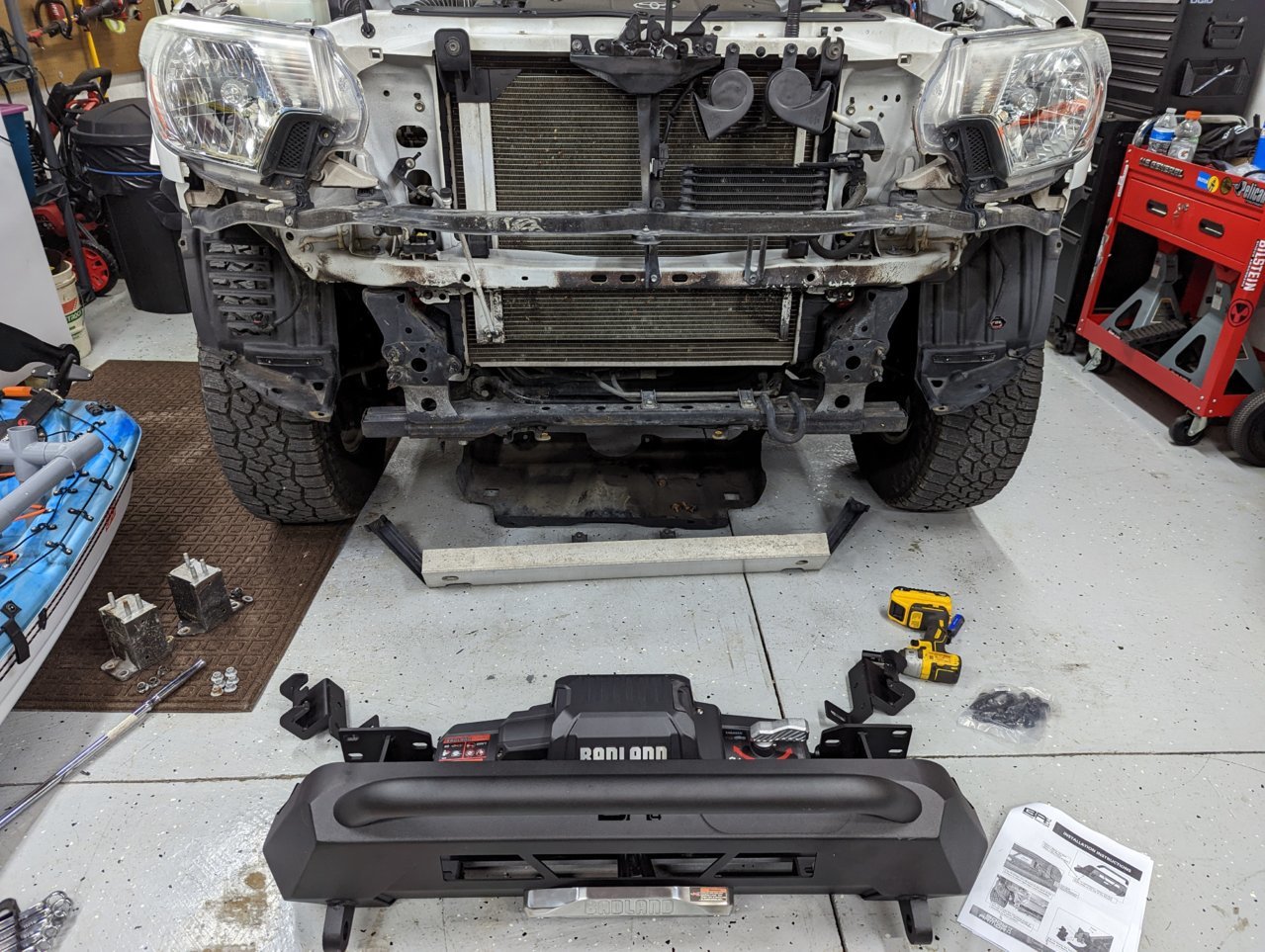

    Toledo, OH here.... If you truly want to keep your truck for a long time, regularly rinse the vehicle with a power washer after driving on brine and salt roads.
    If not, drive through a wash at least once a week during winter. Make sure it has the hot undercarriage wash.
    You can't stop the frame rust, but you can definitely slow it down. Fluid Film is great for this application. If you have the money and the time, POR15 everything you can. Lift the cab, the bed, and remember to get in the frame.
    Pictured is my truck. 2015/70K very heavy use. It was fully undercoated (by a bad company) and still fights rust by what I mentioned above.
    Yes, this was for "high-risk-rust" areas.

    I already have the pressure washer attachment to do that and plan on doing it. I tell myself I'm going to, but we will see when there's 12" of snow in my gravel driveway & I have to grab the pressure washer literally out of the house so the water doesn't freeze inside of it, to go pressure wash the underside of my truck while it's snowing on me lol— Every time I take it out on the roads. I'm definitely going to I care about the damn thing too much, but boy I wish there was an easier way. *Cough cough, that's your cue guys*
    Pretty sweet winch & winch mount/bumper btw, which one is that?

    I know I am a broken record, but besides heading to Canada and getting it done at Canadian Tire or another shop- Fluid Film, Canoil, Woolwax are your best bets without fully disassembling the vehicle. They do make Black Fluid Film and spray kits for the above so it's easier on you.
    Appreciate the compliment. The bumper is a cheap Body Armor hidden winch and it's an apex 12K.
