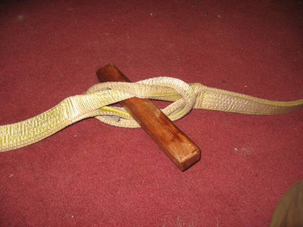

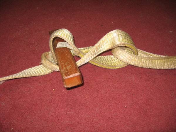

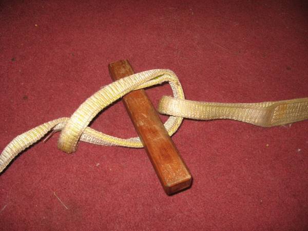

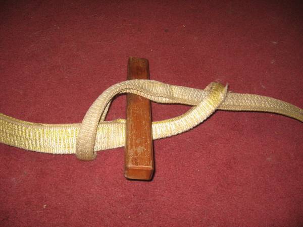

    Well i was wondering how to attach two tow straps together so after a little research i found some really good ways of doing so safely. All that is required is a small piece of hardwood dowel rod. The first two are my favorites with the second one being the easiest. Safe and effective, no knots to undo and no flying shackles to kill anybody.
    [​IMG][​IMG][​IMG][​IMG]

    I have not used any of them yet, just wanted to know JIC and i didnt see any info on here although i didnt use the search func. Hope somebody that doesnt know finds this useful.
    Pics courtesy of the Great lakes four wheel drive Assoc.

    Used the 1st one a couple times, sticks, magazine, whatever...

    I have used 1,3 and 4 a few times!
    also they do make stuff to use other than a pice of wood. i think one of the types of things is called a dog bone or something like that i don’t remember.
