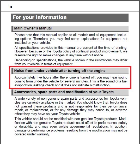

    Fuel evap leak check, per the owners manual...

    Well, there it is. And it was literally 5 hours on the nose when I heard it.
    Thanks Beer:30
