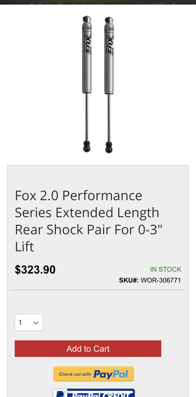

    were these what you had on your truck?

    Ok so yes and no.
    What's funny is, Wheeler's offers that set with 2 different length shocks which would correlate with what our trucks require.
    The length both collapsed and expanded are also similar to Bilstein 5100's, so you can rest assured that they will indeed work with a 2-3" lift.
    Now here's what's funny; the shock replacement for our trucks on Fox website suggests a shock with a similar length to the shorter of the 2 found from Wheeler's which would mean a 7" traveling shock.
    The longer of the 2 found from Wheeler's pair is an 8" traveling shock.
    Since I had ordered via part number, I opted to go with Fox universal shock to ensure the 8.10" of traveling rears. My mistake being that the valving was meant for a heavier truck, etc. I found this out after talking to 2 different people at Fox and 1 person at Wheeler's. When I had asked Wheeler's about the Fox shocks they offer, they told me my feedback mimics that of what other customers have told them.
    So yes, they are essentially valved the same as my universal shocks, and since you're adding a ton of weight they should work fine for your needs.
    However, the direct replacement from the Fox website is valved differently...
