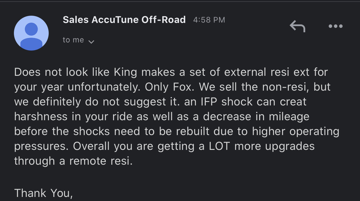

    '04 TRD Tacoma 4x4 DC
    Kings, J59's Total Chaos UCAs Custom skids Sticker mod
    Yeah, I am doing just fine without resis. I never noticed my 5100s fading with my driving style, so the ext 2.5 Kings are even better, didn't see a need for the extra cost of the resis.
    If you run the whoops in the desert flat out all the time, sure, get resis. I'd argue that easily 90% of people out there running resis wouldn't even notice if you replaced them with a 5100 painted blue (or whatever color you like).
    Especially if you aren't hammering on the 2.5's all the time (daily driver), you won't have to rebuild them nearly as often as that guy makes it sound.
