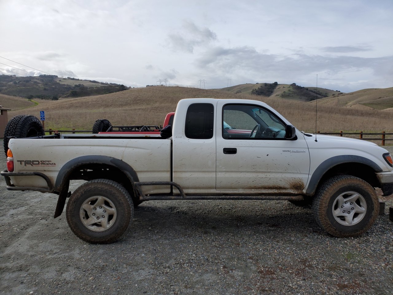

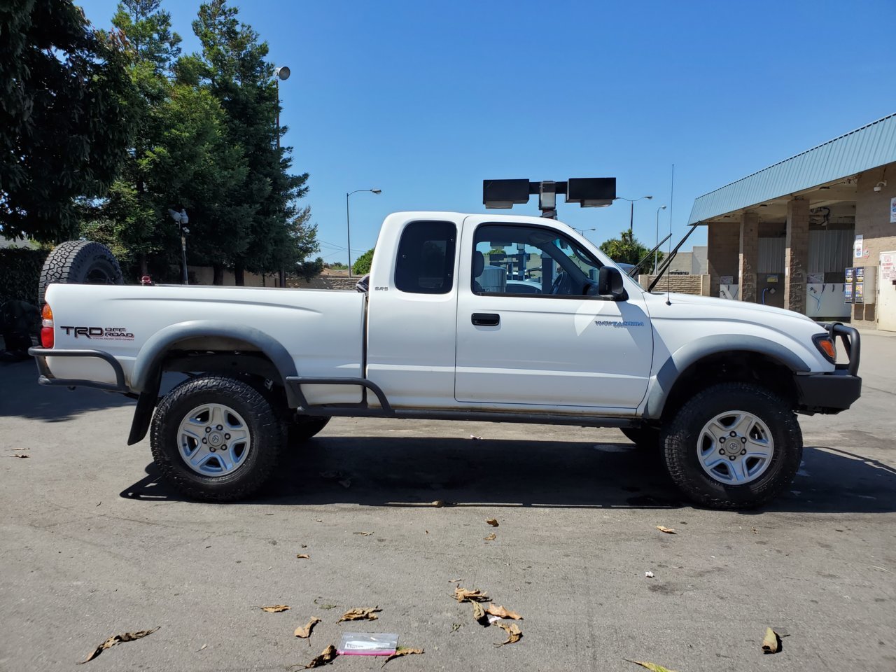

    Few months later and I still have them on my Tacoma.
    Being that you're 4x4, and will run a winch with your bumper, I'd opt for 650lb springs.
    I never put the King's on because they too run 600lb springs like the Fox, and instead will go on my 4R.
    Truck rides nicely (up front, soaks speed bumps crazy smooth at +30mph) but only rides level when I had weight in the rear.
    Here it is with the weight a bedrack and RTT -
    Here it is with no weight in the back -
    Before the ARB, the front sat just a tad higher than it does above. Best 'level' pic I could find with the stock bumper on -

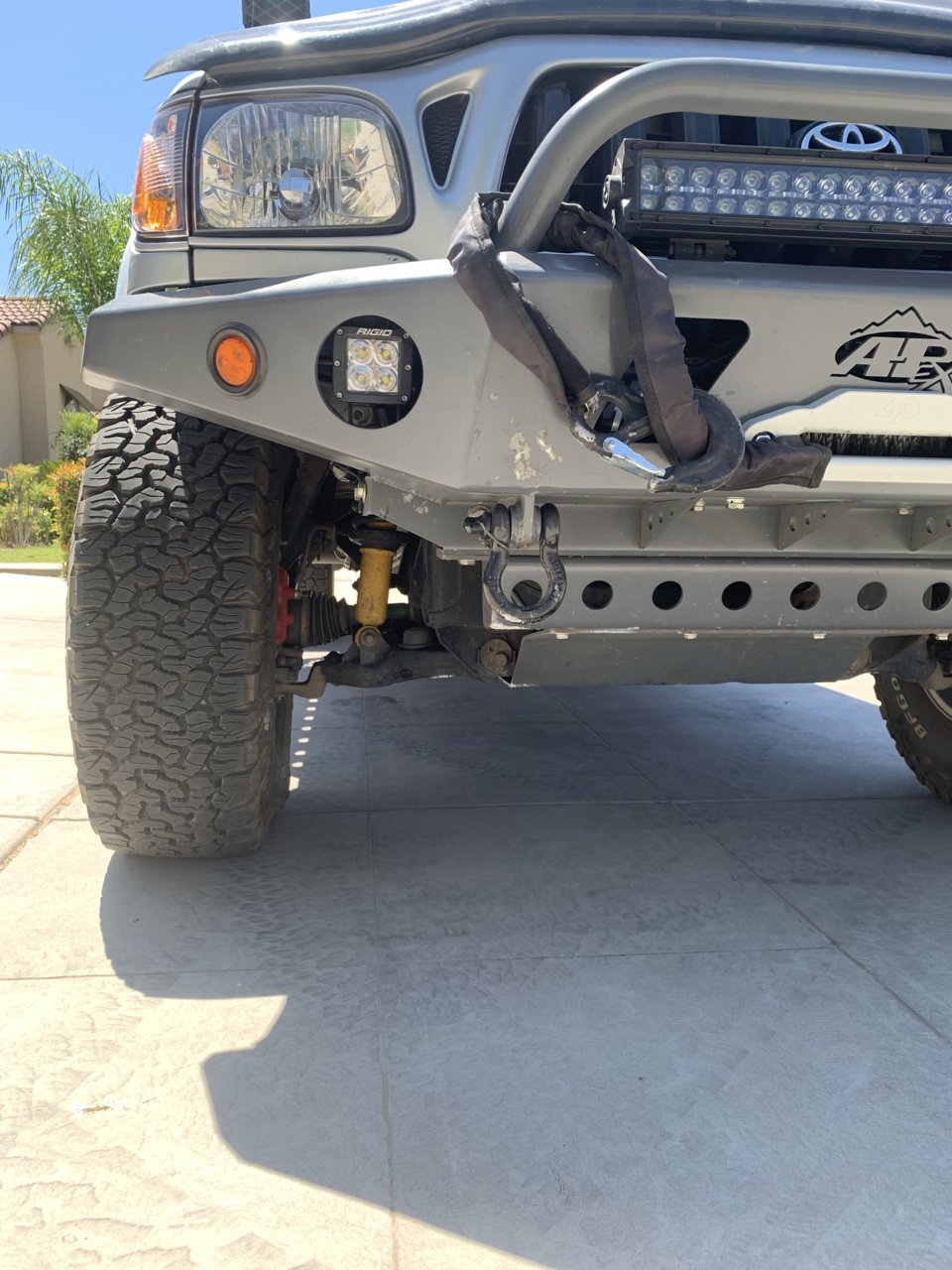

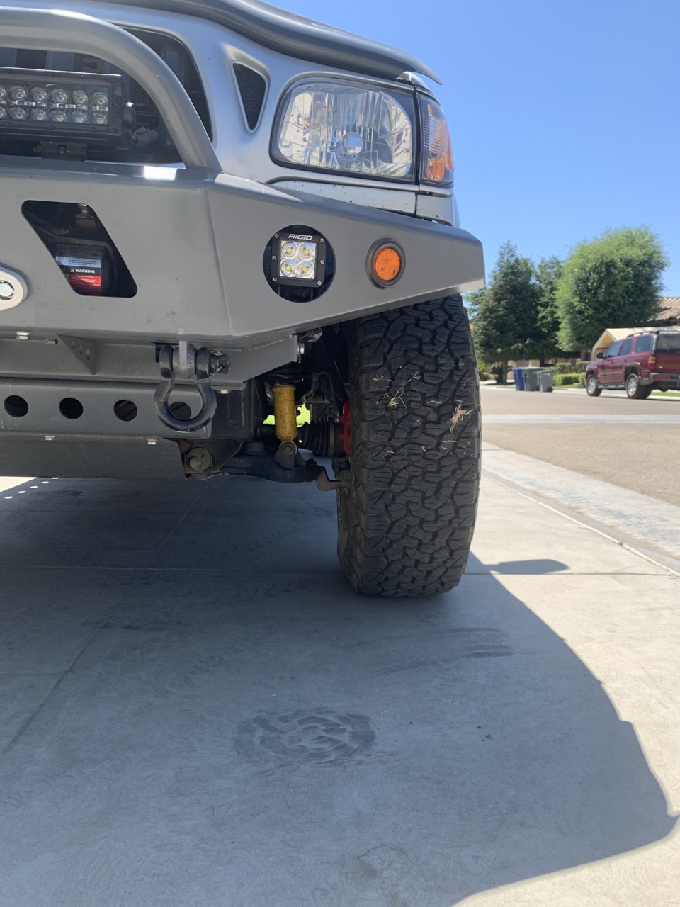

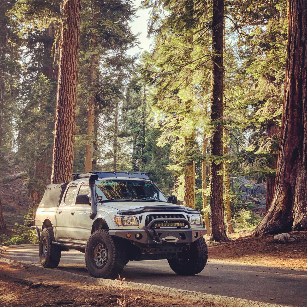

    Good to know. I think I’ll ask for the 650# springs when the time comes. Unless I’m mistaken, the OME w/590# are set, there are no adjustments. My CV boot angle is almost straight with a diff drop. It might just look like I have a decent lift because my fenders are trimmed. I’ve done many trails and obstacles and so far I am pleased with how the OME setup works. However I’m going through the journey with my truck and want to go to the next stage. I want to try 35s next but I know I’ll need to regear and then tub my wheel well to get the clearance I want for certain obstacles. Eventually I might end up with 37” or 40” and a solid axle or LT, it’s all about the journey. Working my way up the build is a fun and good learning experience.
    0C4D5676-1CB8-4AE2-A7FE-045C214831D3.jpg 594A44EA-73E2-4F1D-98DF-227DE6731F26.jpg
