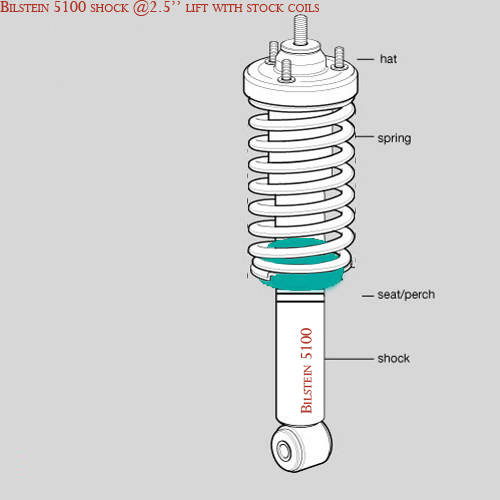

    here's my quick drawing of the bilstein 5100 shock to compare to an in coil spacer.

    i know on the above the coil spacer lift if you hit a good sized bump in the road the shock will bottom out before you hit the bumpstops. causing the shock to fail.

    Well, to have an intelligent discussion you have to start with some basics... and that Tacoma HQ stuff you are referencing is not correct and thus you are starting with bad premise. Over coil spacer damage on down travel? Thats fucking retarded. Explain it. Up travel? Sure.
    Preload spacer causing damage or removing uptravel? Uh... how? Unless you compress the coils till they bind... which Tacoma springs wont. So again... retarded. Minimal change in ride stiffness? Preloading factory springs... especially TRD OR springs which are progressive have a large impact on ride comfort.
    5100 has no loss of uptravel... because like I said its not possible.
    Yes 5100 is a glorified spacer lift with a new shock.
    No 5100 and over coil spacer wont help due to longer shock length because this damage on droop thing is retarded. If it longer compressed it will make the damage on up travel more likely.
  16. Jun 22, 2012 at 1:35 AM

    the reason why there is no loss of up travel is because you say so?
    the reason there is potential damage at full droop with an above coil spacer is because it is trying to force the shock further than it is built to go.
    you need to relax and bring some evidence, we're not battling here, just throwing out ideas.

    Whatever dude revel in your ignorance. I was not criticising you. I was just saying the website you referenced gave bad info. But you seem stuck to it after being told the reality. There is more room in the shock for down travel than needed with an over coil spacer... no room for up travel. But all I have is facts not some pretty picture on a website so physics and geometry must be wrong. If you put a 4" spacer in there the arms would be at full droop... 8" up 0" down. But the shock is fully compressed. 8" of extension and no room to collapse. But the shock is trying to extend further that spec? WTF? Its FULLY COLLAPSED. NO DOWN TRAVEL HAS BEEN USED. Just open your mind and think a little.
    And why no loss of uptravel with 5100? Because coils dont bind before the bump hits.

    Finally, the answer you seek is longer springs and nonprogressive coils.

    Yes... it is a fact. 5100 has no loss of up travel is a goddamned fact. When you hit the bump that is all the uptravel you can have. It can do that. Case closed.
    You said there was not enough room for travel right there. What do you mean you did not say there was not enough room for travel? And saying there is not enough room for downtravel is an outright opposition of the reality... there is excess room for downtravel and not enough room for uptravel.
