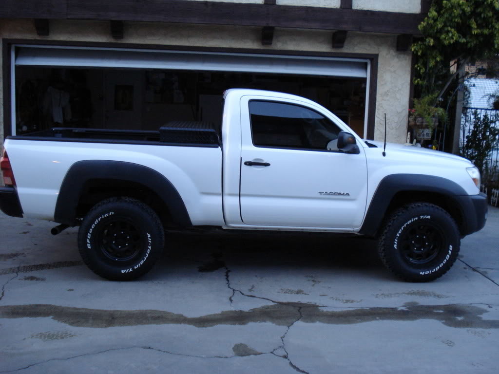

    So if I get 5100's all around...do I need the rear TSB done? I just want to simply level my truck....(notice the back a bit taller)...and what height should I set the billies on the front? :eek: :confused:

    AFAIK, the regular cabs are not qualified for the TSB springs, so the answer would be "No."

    would he need to set the front 5100's at 1.5?

    I would set the front at about 1.5, you should then be just about level.

    I thought it was 1.75"....

    I would definitely go with 2.5 and an AAL (if you can spend an extra $80). :)

    extra 80 bucks no prob...what is a AAL? :confused: does it go in the rear?

    It adds a leaf to your factory leaf pack.

    i think i got it...for sure i now know that the TSB doesn't apply to my regular cab pre runner...so all i would need is the 5100's and the AAL right? :eek:

    Correct! The Wheeler's AAL with your stock springs is basically the same as the suspension TSB for access and double cabs. :thumbsup:

    Well......Not exactly. The TSB leaf pack is a whole 4 leaf pack, with a slightly higher spring rate than the 3 leaf. An AAL in the Stock 3 leaf pack is going to have a higher spring rate than the TSB pack, as the TSB pack uses slightly thinner leaf. ;)

    but i should be ok right? :eek:

    Ok, same concept. Sorta. :D
    But yes, you'll be just fine!
