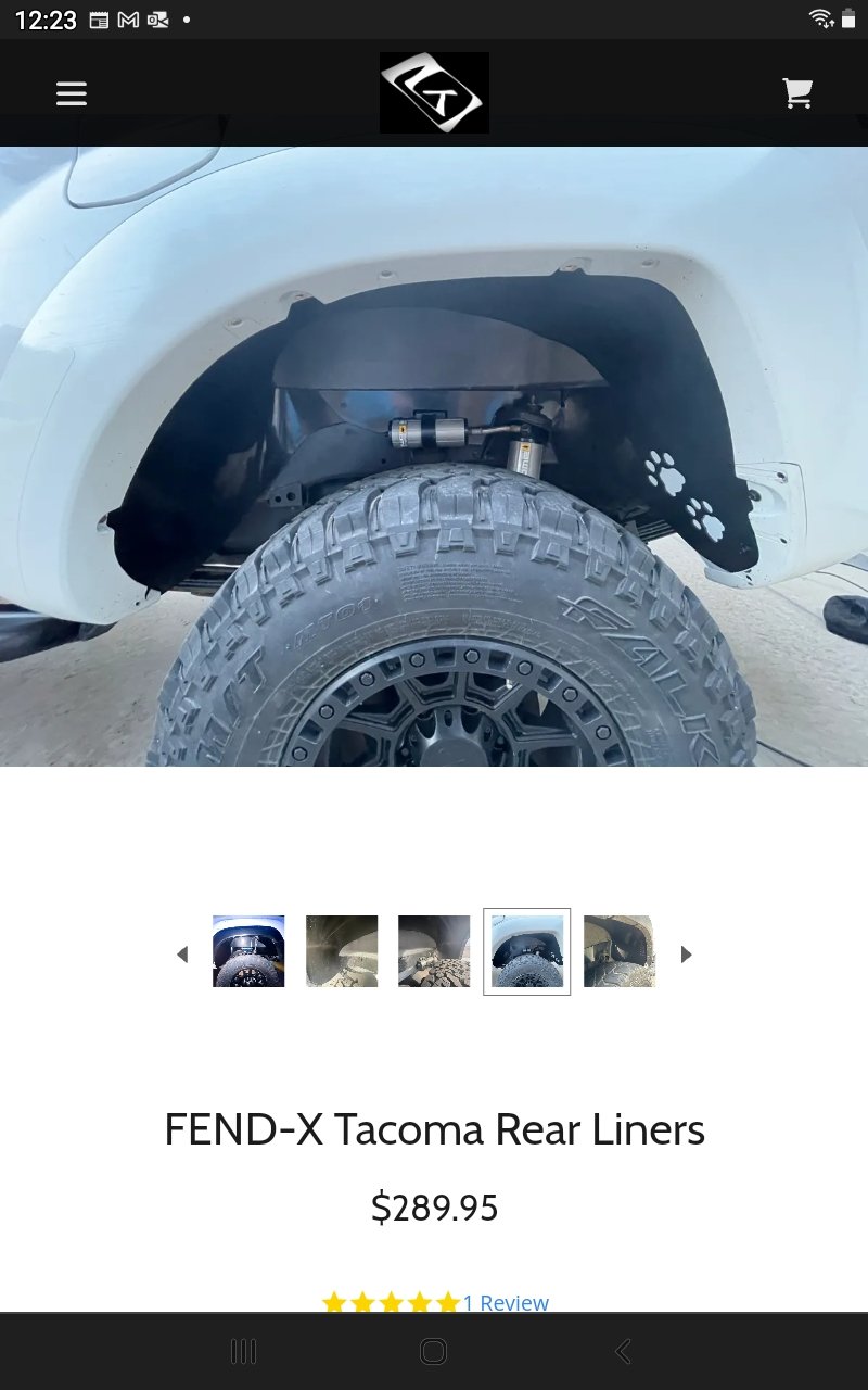

    Has anyone thought about adding rear wheel well liners and adding a piece of 1/4" hardened steel on the inside to slow down the drilling process?
