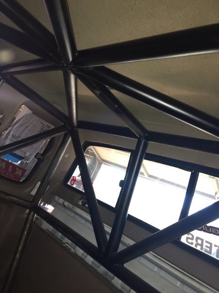

    So today Jeff sent me this picture :eek: he said he has gotten the interior back but this was clearly before and the cage is black. Can't wait to go and drive my truck again. Almost been a year and I'm dying to do stupid things in it:bikewhoops:

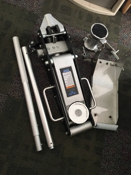

    Decided since I am going for the "race truck" idea but still street truck guess I needed a real jack for the truck
    Hopefully only a few more months the truck will be down:fingerscrossed:

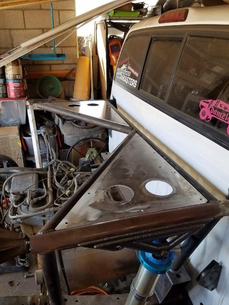

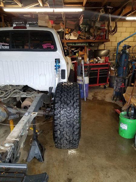

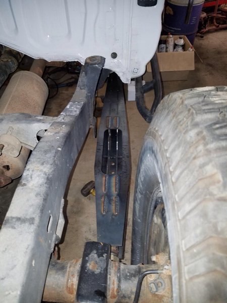

    Lots of mocking up.nothing is final but slowly getting there:bananadance:

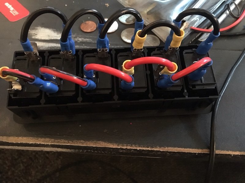

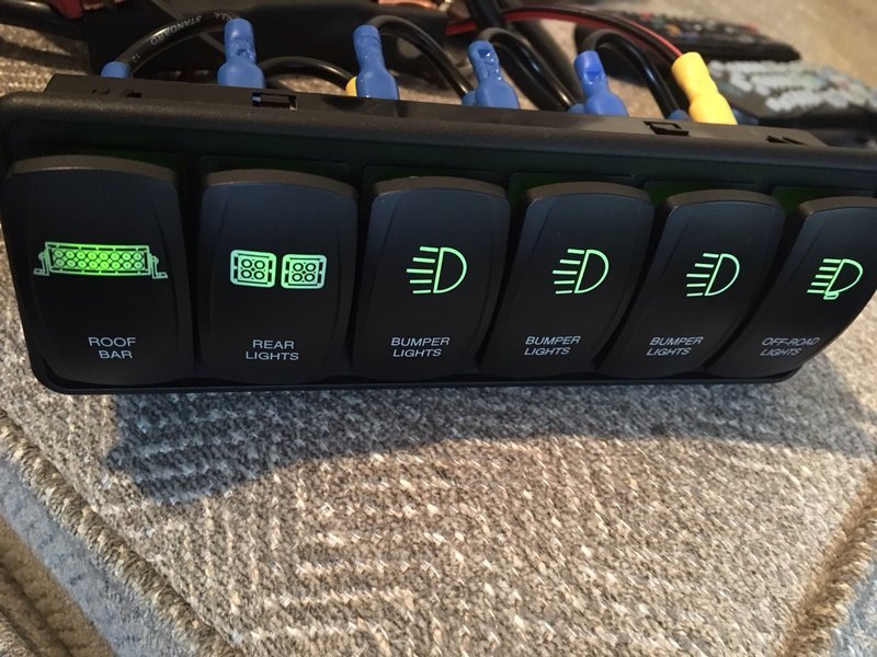

    Decided to do some crappy wiring. Not pretty but will do just fine...

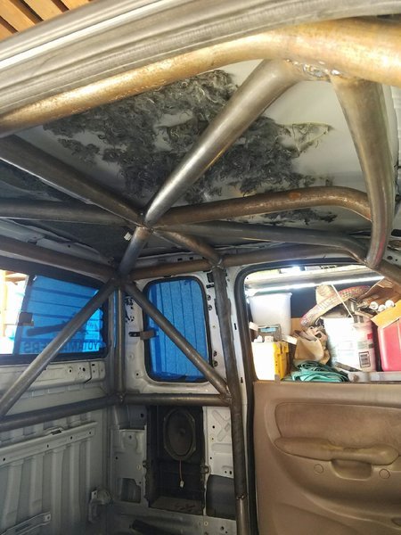

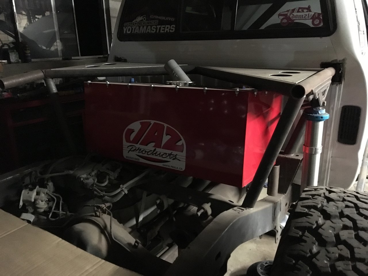

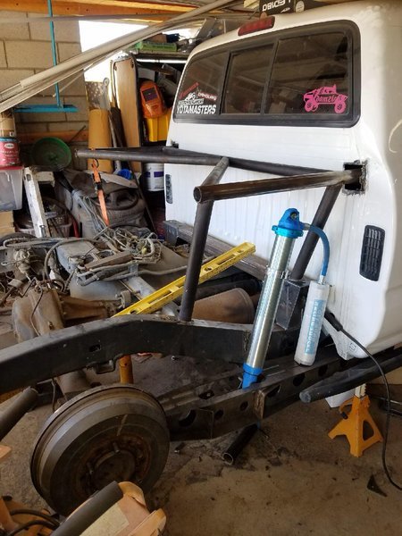

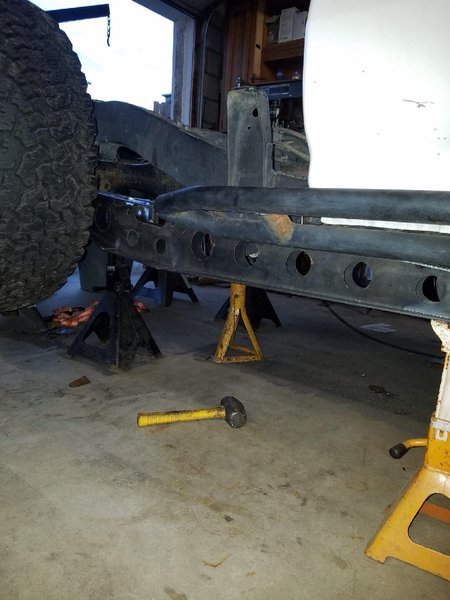

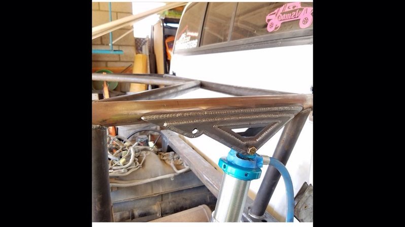

    Some bed cage work from some time ago. Not having the traditional tubes from the roof. Coming under the bed line. Wanting it to be as sleeper as possible

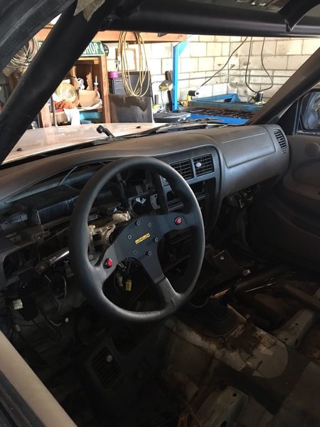

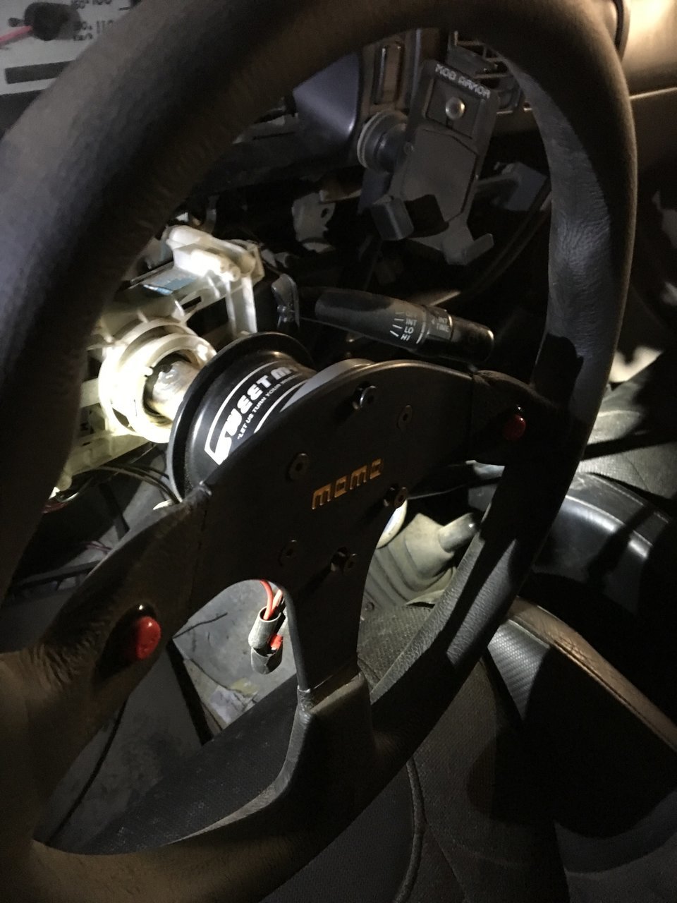

    Interior is like 90-95% done:dancingbacon:
    Decided why not go full dummy wanna be trophy truck

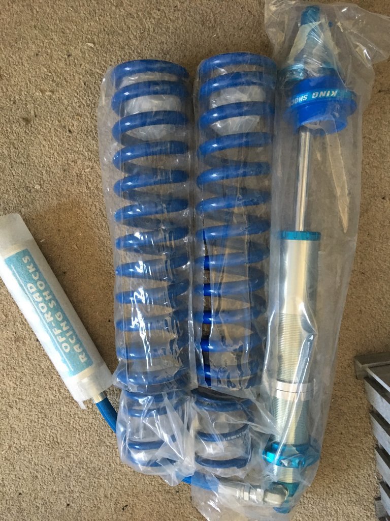

    Literally everything is for sale. 3600 for everything 3k without shocks 650 for shocks alone.would like to try and sell everything if possible
    King 8" 2.5 coil overs unknown valving (sold)
    Camburg 3.5 kit(10k miles) with newer ball joints(maybe 2k miles) truck has been sitting for over a year

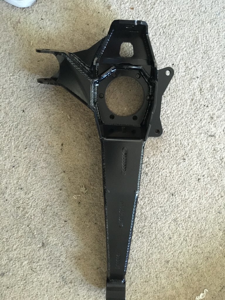

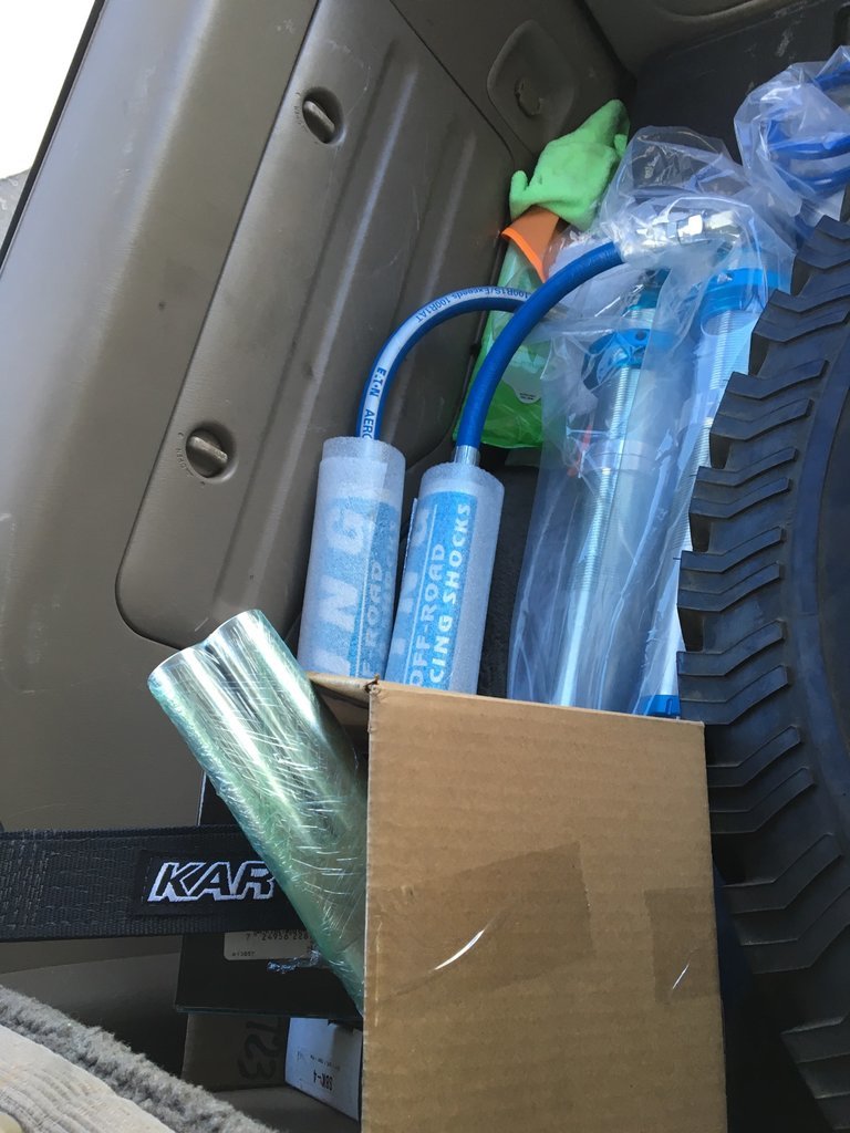

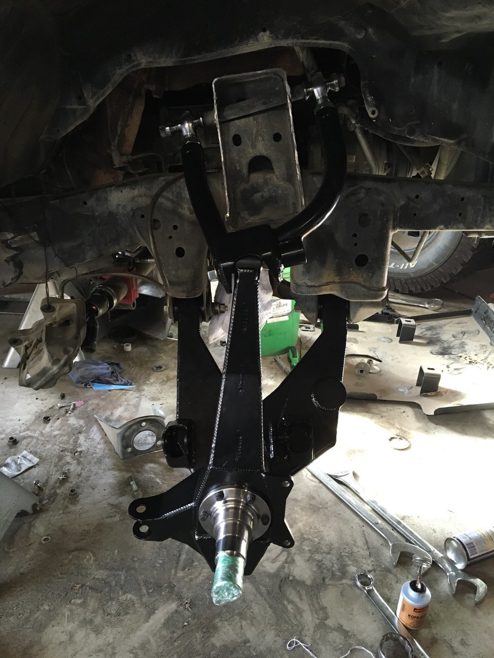

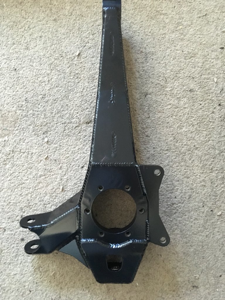

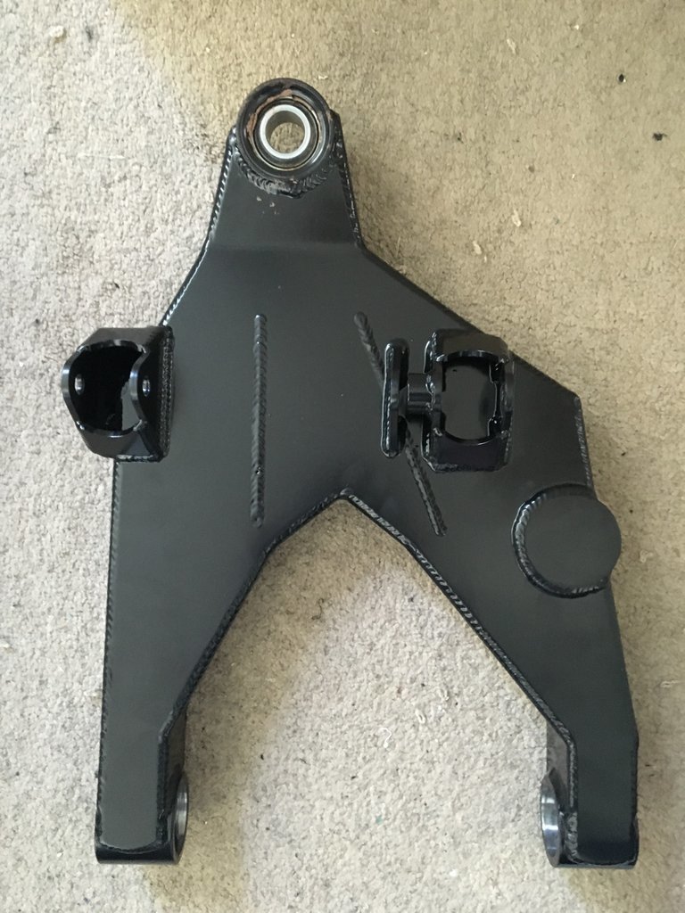

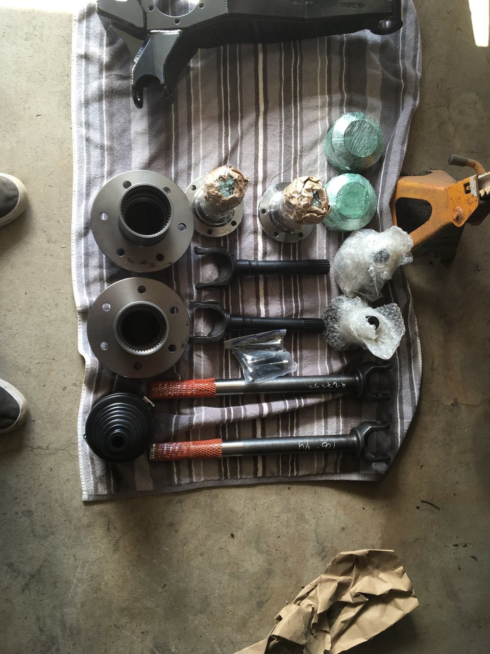

    So I actually got my kit,shocks, upgraded steering.just waiting for my axles now.and talk about beefy.the spindles are freaking badass.cant wait until this project is own it's own weight and I can finally rip it in the dirt again.not so good of pictures because I was in a hurry and needed to put it away until I can get out to jeffs place

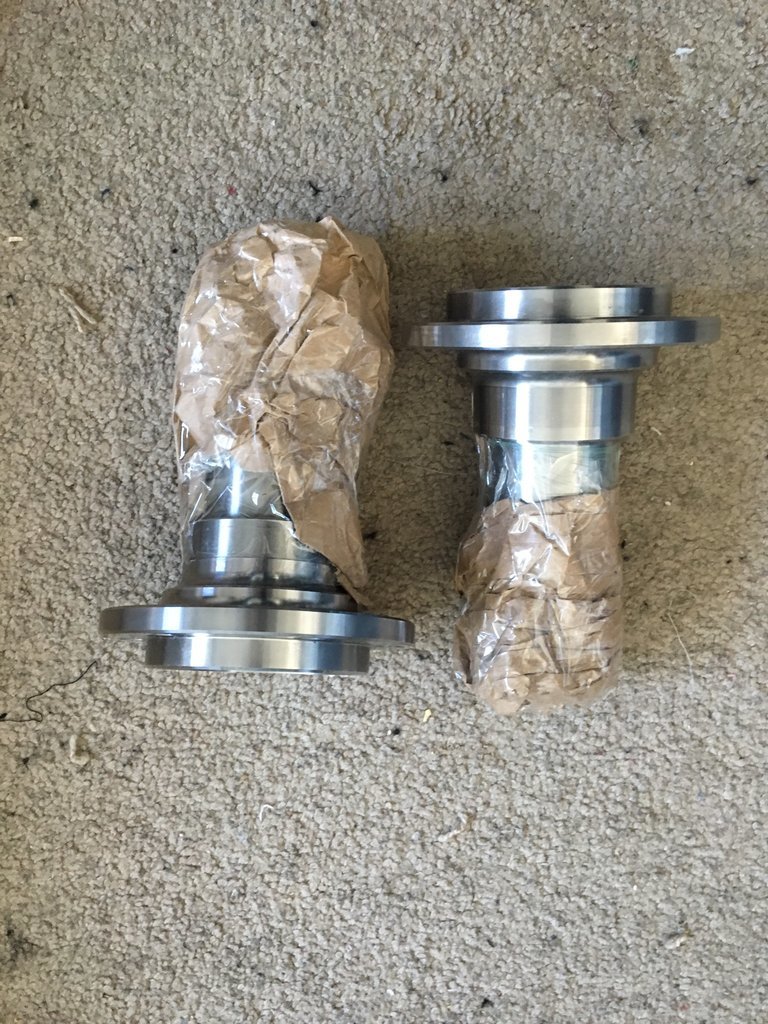

    d44 hubs. Still have boxes and bags full of parts as well.

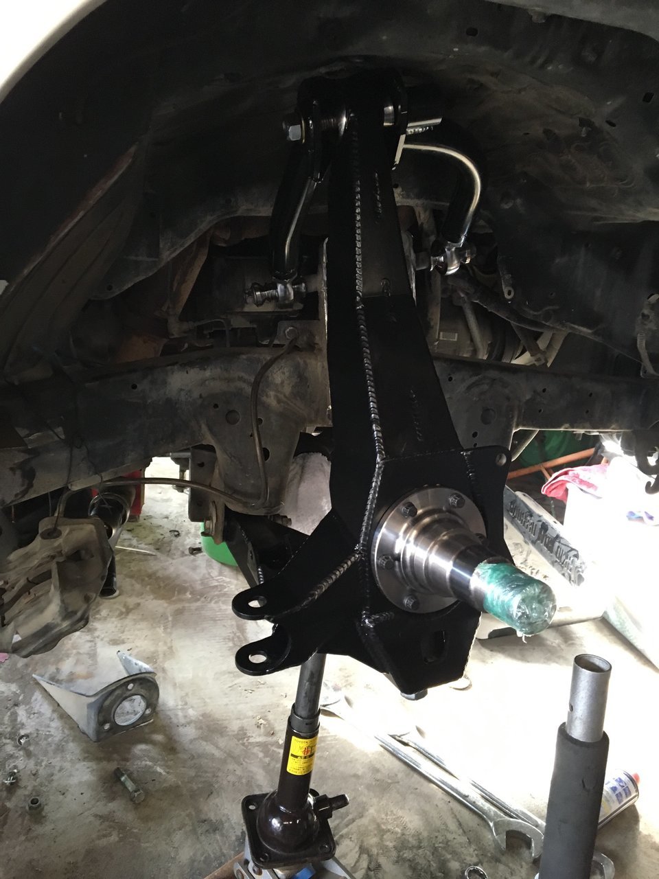

    Got my kit and did a mock up. With out cutting fender well,which will happen was 17.5 metal to metal. So after everything shooting for a clean bumped and strapped at 17 after fire wall and fender well is cut. Have to build my axles then go back out so we can get it ready for true cycling. Solo motorsports was amazing customer service and crazy amazing quality of work

    I'm curious how those axles do because from the looks of it they aren't a true CV axle.

    Am I wrong? The U-joint creates a variable angular velocity at the wheel causing vibration. I'm guessing that's why they use manual hubs.

    Lol doesn’t cause vibration. It is used to get more travel

    Yea it's got cv one side and the spindle side is the u-joint to be able to pull more travel. When I talk to solo he said I will never have binding problems with the axles. Unless I pass a good 20" which I don't see happening. If it's even possible
