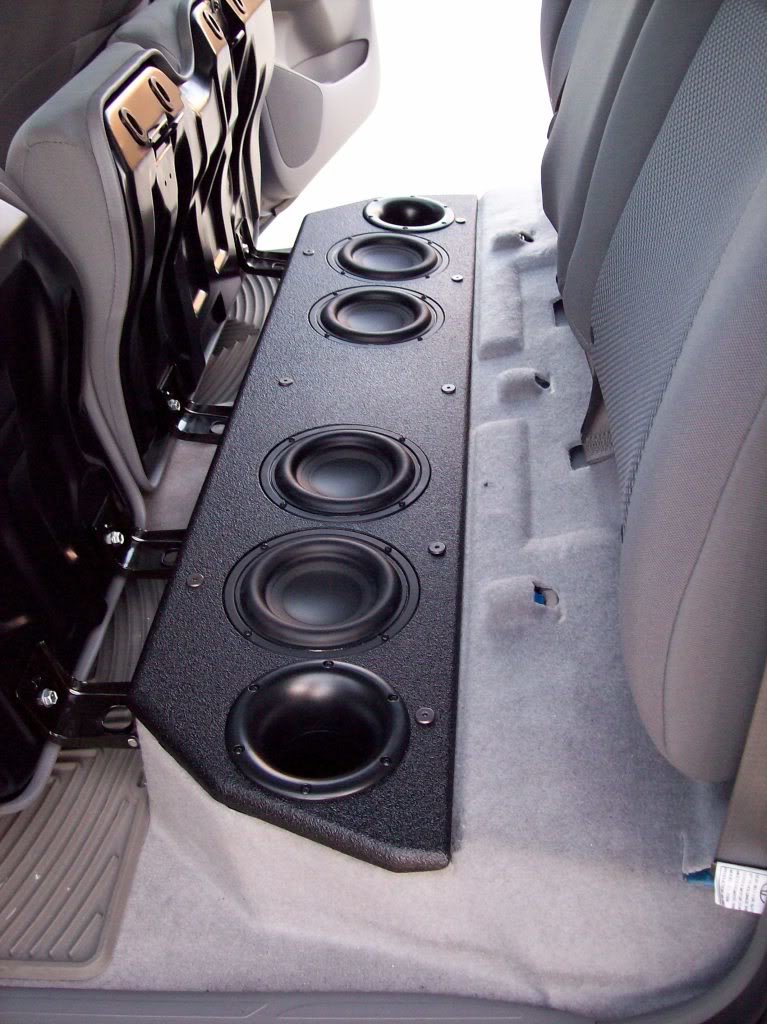

    fit perfectly under the back sit of a double cab? Anyone remember who this was. I tried to search but no luck. What type of sub was it.

    If it was me you were thinking of....try and forget it b/c it's never gonna happen

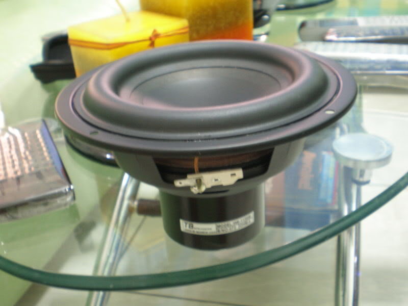

    TOP SECRET BUILD? Can u say "TANG BAND!!!???"
    http://www.parts-express.com/pe/showdetl.cfm?Partnumber=264-832
    this may not be the exact speaker Italystylion is using but it's pretty darn close. U can try Partsexpress.com. Everything audio related is available there.
    Even if this is not the exact sub, it's got 4.5 stars out of 5 stars from 55 different reviewers!!! I'd say it's worth a try.

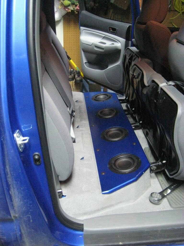

    For those wondering....yes that's the same speaker I used. The Tang Band 6.5" subs are fantastic. The space is just too small for 4 of them in a ported box. The port schematic is just too insane. Even with two 3" ports I still get port chuffing and I'm looking to get rid of that. I'll be going with a dual ported 8" sub setup possibly by the spring.
    The reason I say that no one else will likely ever do it is the amount of work involved in doing it. Trust me when I say the road is long and it's quite rough.

    What about goign to a sealed enclosure?

    Tried that first. I want ported response (proper response) with a lower tuning. The FS on the subs is a little higher so a lower tuning really helps yield a nice response curve.
