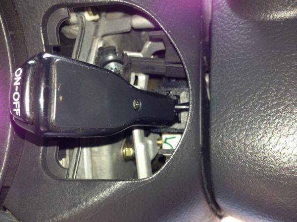

    So you want someone to take out the screw on the back of the stick? This one?

    If you dare lol. There are two prongs attached to the side the screw is going into. There is a spring and a 3 pronged piece of copper on the inside as well that I have no idea which way they are placed in there. If you can get a good picture of how the spring and piece of copper go in, you'de be helping myself out, and at least one other member. I'd hate for you to mess yours up though, so if you have a warranty, no problem. Other than that, be careful.

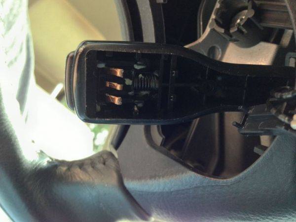

    I replied on your old post, but I will copy it here too. Have you really been trying to fix this for 2 YEARS?!
    Anyhow...
    Take some better pictures and I am sure I can figure that out. Also, if possible, hold that little E shaped piece up to the switch housing.
    I think all that switch does is momentarily connect the 2 wires going into it, like a momentary SPST switch.
    That copper piece would be moved by the button on the end to come in contact with the 2 pads that the wires are attached to.
    As far as the orientation of that little copper contact, it is hard to see how it fits in the switch housing so I can't help with that without some better pics. I think the spring would contact the longer center prong of the copper piece so that the on/off button would be spring loaded. (you push the button which pushes the contact to touch the pads on the wires. The spring pushes it all back when you let your finger off.)
    I have a 1st Gen, otherwise I would have taken mine apart already. :p

    Here's one with a flash and one without. I couldn't decide which one showed up better. If you click on the picture, that'll take you to my gallery where you can click on the picture again and it'll be nice and big. Do that and turn the brightness on your monitor all the way up. And maybe zoom in as well. ;) Hope this helps!

    That looks great Collin! I can definitely work with that. The copper peice looks a little different than mine, which is maybe why mine popped apart, but I can see how it goes together. The wife has the Taco right now but I'll give it a try as soon as she gets home. Thanks!
