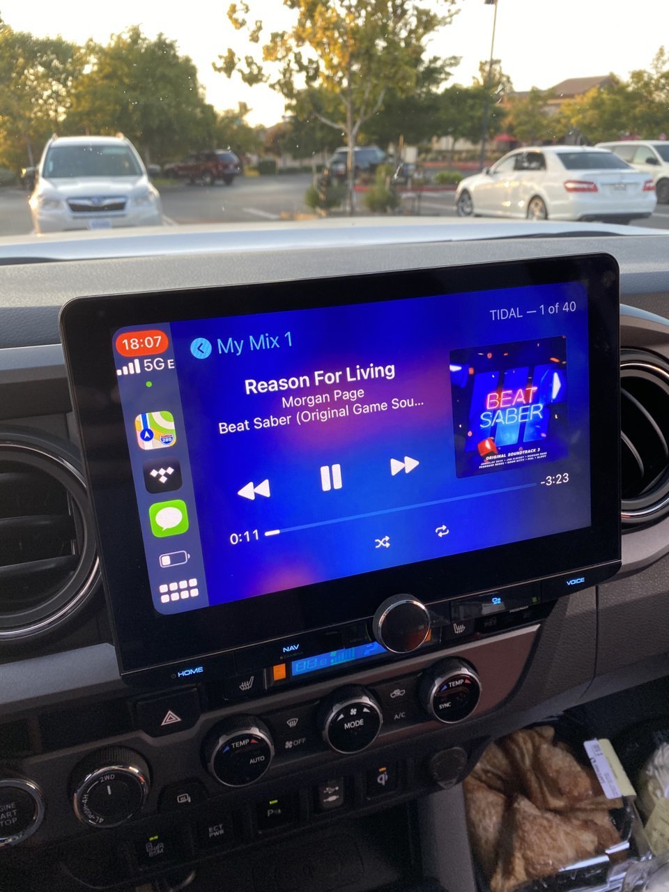

    I’ve been looking at the Stinger Heigh10 pretty seriously, I really love the flush look. I watched a video last night on the Stinger and there is some concern from me about the preamp voltage and some distortion issues. I feel like the Kenwoods are probably better sounding units audio-wise as they have a proven track record over the years and I’ve owned others that rocked out.
    I’m still not 100% sold on the floating style HU, however. Isn’t there a big gap behind the screen and dash that could fill up with dust and dead bugs and stuff lol? Also since it sticks out between the two middle air vents does it interfere with the airflow from the right vent towards the drivers side? (If that makes sense)
    And one last thing: Are any of the native Tacoma functions lost with this unit? Like will the radio info still show on the drivers screen, etc?
    ** edit - will using the idatalink Maestro module allow the HU use my OEM JBL speakers, sub, and amp without any special modifications? It should be plug and play right? I’m happy with the speaker system I currently have in the truck

    I can't answer all of this but I can say for sure the radio info will populate on the cluster screen for song playing. Maestro keeps that working. The compass tab will not work, but mine never had anything from the factory there anyways so I didn't care.
    One of the main purposes of the Maestro is to adapt factory amps and all that type of stuff, so you should have no issues. The Maestro should keep the amp working which should in turn keep the speakers working. iDataLink gives you different wiring diagrams for w/ or w/o JBL.

    5V Preout is awesome. But the Heigh10 does do optical I think. I have a 22 with JBL now and I’m still probably going to swap.
    The gap is big, but it’s not really noticeable in any place you would look. Like you have to be up against the dash to notice it. It doesn’t really effect flow since those vents normally aim to the seats direct or straight up in the air.
    The main point of the Maestro is to be able to keep the OEM settings. You can still mess with locks, lights etc. but it will be a tad cumbersome compared factory HU.
    As for the display on Speedo. I think you do lose the direction arrows, but music still shows up. Let’s say it doesn’t look weird with whatever was removed in the audio tab.
    yes still works with JBL. Make sure you get the right Toyota harness and flash right!
