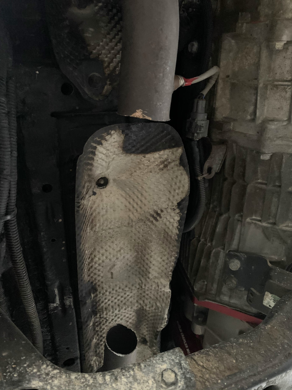

    Well, actually it seems slightly faster (reduced back pressure?) - maybe I'm imagining it...but I'm not imagining the awful and extremely loud aftermarket exhaust sound in the cab.
    Anyone parting out a 2nd gen 4.0L taco and have a spare catalytic converter?

    Ha. Didn’t even get the good cat. Sensor may still work without tripping a CEL. Throw in a decent car there, from an exhaust shop, done. Sensors don’t read that cat anyway.

    Wow, didn’t know I was actually lucky...the check engine light still came on though. I called Napa and O’Riley they both want between $4-500 for a cat. The local exhaust shop wants $400, install included. Anyone know of a good online source? If I can get the rusty flanges apart I’ll just weld it on myself.

    Just get an off the shelf cat which is made for our trucks and get it welded in there. Hopefully you are not based out of CA otherwise they might make a big deal at emissions inspection time, otherwise you are good. Those are secondaries and so their only function are to be "clean up cats." The primaries are the ones which are the big deal.
