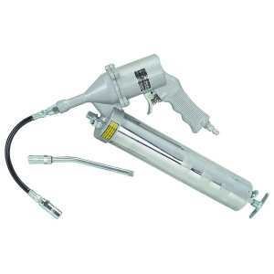

    This is my guilty little pleasure
    I don't need an air powered grease gun, but I sure do like it. Especially, for greasing those hard to get to zerks. Like getting to those fittings in the middle of the u-joint, while lying on your back, where you can't really see what you're doing. For $20 bucks its not too expensive.

    Info & part number on this grease gun please...
