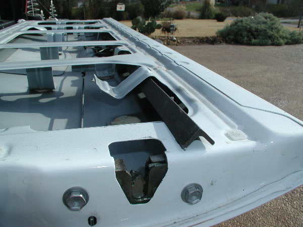

    Anybody mind taking some interior pics of the tailgate? I wanna compare my own to the updated one.
    Also, anybody have a Gater Saver?
    My tailgate all taken apart.
    The interior supports, which are an utter joke.

    Da Hui....I've got pics over on TN of the internals after the TSB was done. It's in that 400 page thread on the tailgate TSB thread if you want to search for it.

    I have been thinking about reinforcing my own.
    Interesting. Thanks for the pics.
    I have decided on going this route. Getting the TSB and having a shop around here get me some metal and place that inside the tailgate as well (a big sheet as proposed) like they do with the gator savers. This truck is gonna be mine for a long time, I have no intentions on living with the flimsy current tailgate.

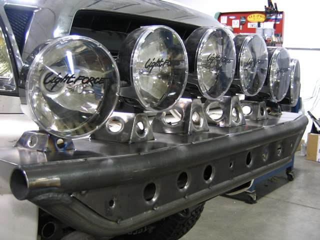

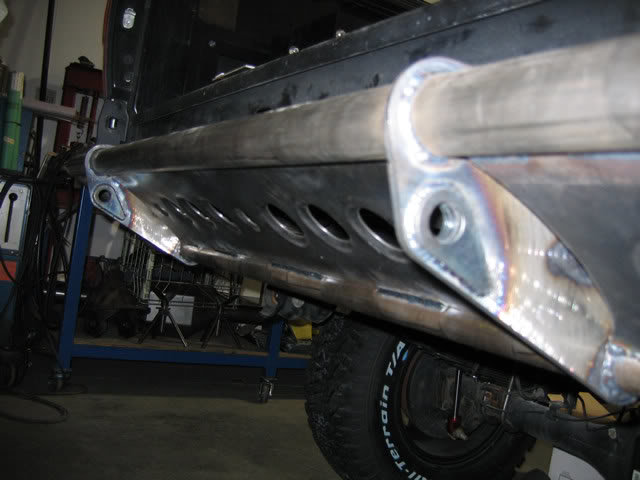

    The holes will obviously reduce weight, but when the edge of the holes are dimpled they add structural rigidity to the piece. Plain sheet metal becomes more difficult to bend and twist while at the same time being lighter.
    Dimple died holes also look pretty badass, which never hurts. :p
    Rear bumper plate:

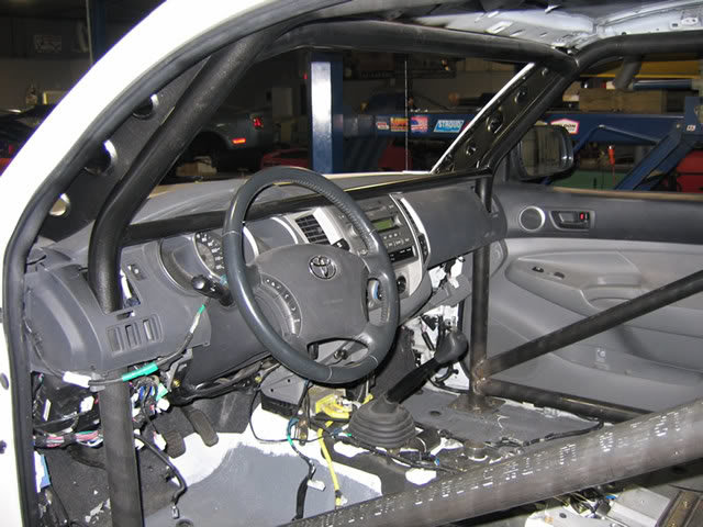

    Check the plates that tie the cage into the A-pillars:
    My front bumper is also covered with the things.
