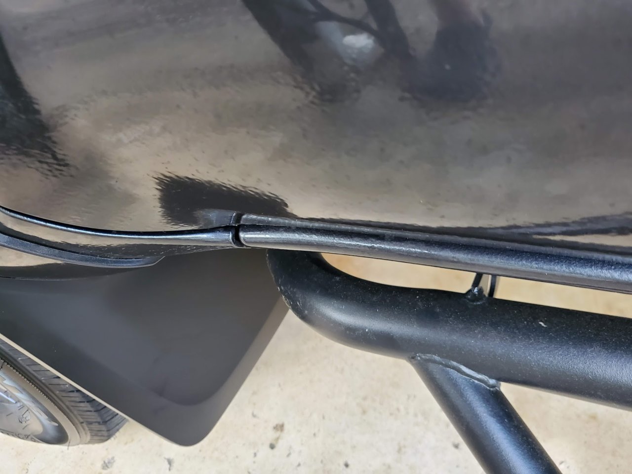

    This may not be new so bear with me. I was at the dealer yesterday picking up my 2021 Limited and, while looking it over, noticed the that the area along the lower sides of the truck had what I thought was a horrible "orange peel" paint job. The salesman quickly told me that it was "rubberized" primer in that area to help prevent paint chipping from road debris. (I don't believe everything a car salesman tells me so I'm a little suspect.) I'll try to add a picture of it later today.

    Yup, keeps rock chips down, Toyota has been doing this for years.

    Been common on various marquee models since at least the '90's.
    My '96 Miata had it, my '13 Tacoma has it.

    Painter here. Rocker Texture down low of body panels. Prevents chipping etc.

    I honestly think that rubberized texture is the best thing they could do to the rockers. Works great.

    As others have written, that's a rocker panel antichip coating, meant to reduce stone damage to steel body panels. It's applied after the body goes through e-coat/uniprime. It's typically applied after the e-coat is baked, and used to be made of a PVC plastisol (very tiny particles of PVC mixed with an oily "plasticizer", some fillers, and other additives). The coating is usually baked before the body goes down the paint line for topcoating.
    Some manufacturers also used to apply a urethane antichip coating to the leading edge of the hood, again before topcoating.
    Been there, done that...in my past career, I was an engineer for a large manufacturer of PVC plastisols, and got the opportunity to visit assembly plants in the US, Canada, and Japan.
