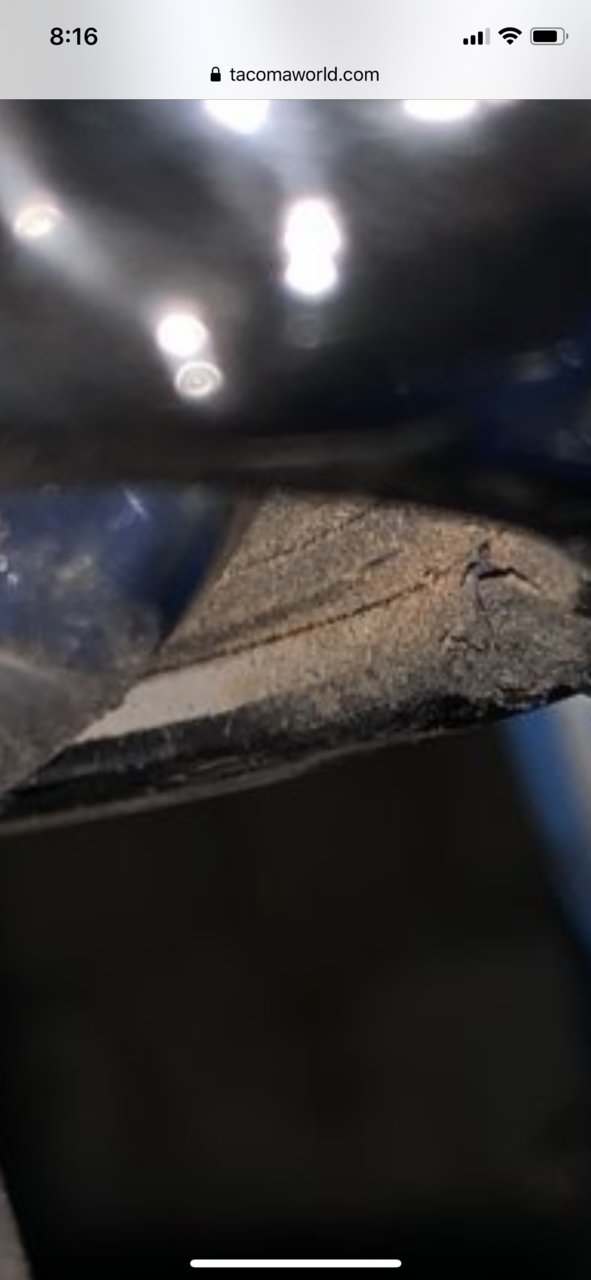

    Pretty sure that this photo he already posted verifies it. I’m not seeing the uniball race seated in the cup properly ?

    hmmm, hard to say. Need more pics!

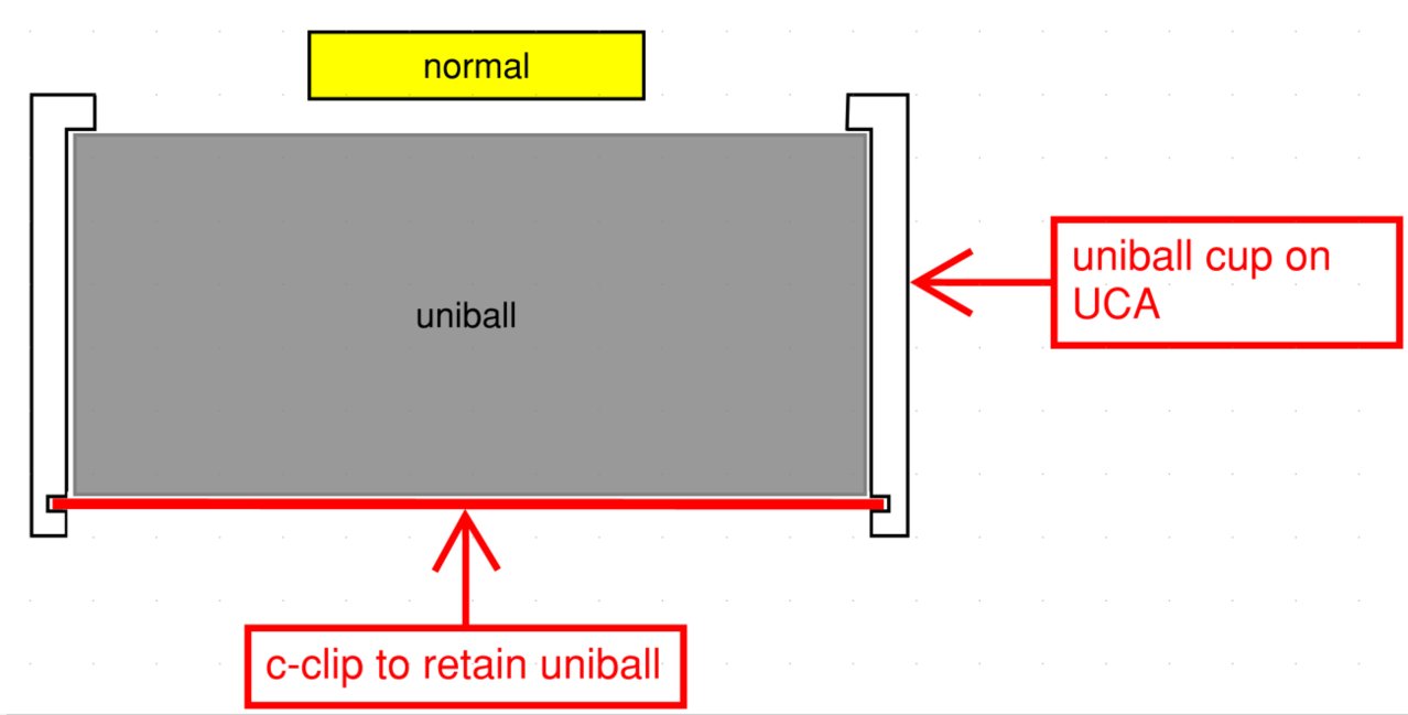

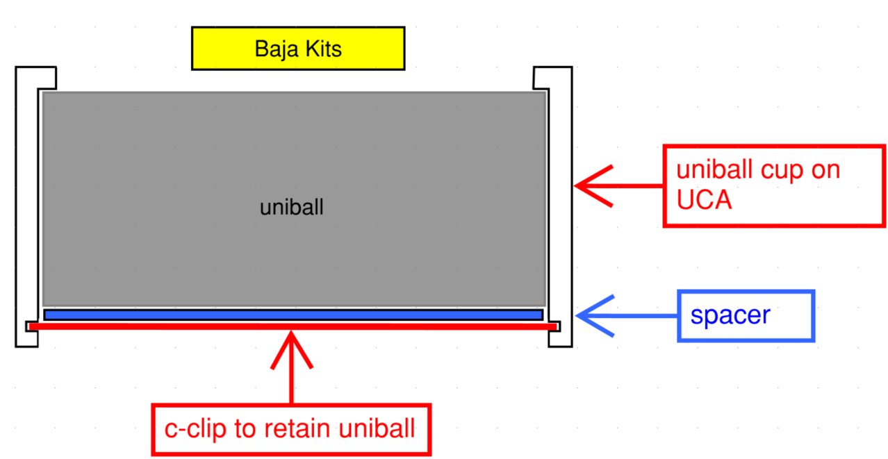

    @Clifford12 From your response I don't think that you understood the potential issue with the Baja kits uniball cup on the UCA. Glad that you found your loose bolt but just want to make sure that you understand the issue that was being described. Baja Kits had a couple of issues previously with customers trucks self destructing while driving and there was a thread that was blowing them up pretty bad... They chimed in and said that their uniball cup uses a spacer ( that nobody else does ) between the uniball itself and the c-clip that holds the uniball in the uniball cup. It devolved into quite a TW verbal shit show with folks challenging the logic of the spacer as it seemed an unnecessary potential fit issue and failure point etc.
    The first sketch shows a cut away view of a normal uniball cup with a uniball inside it and the c-clip that sits in the groove inside the cup to secure the uniball.
    The second sketch shows what Baja kits was doing, if that spacer is not there movement will occur as the uniball slips up and down inside the cup and then the clip will fail.
