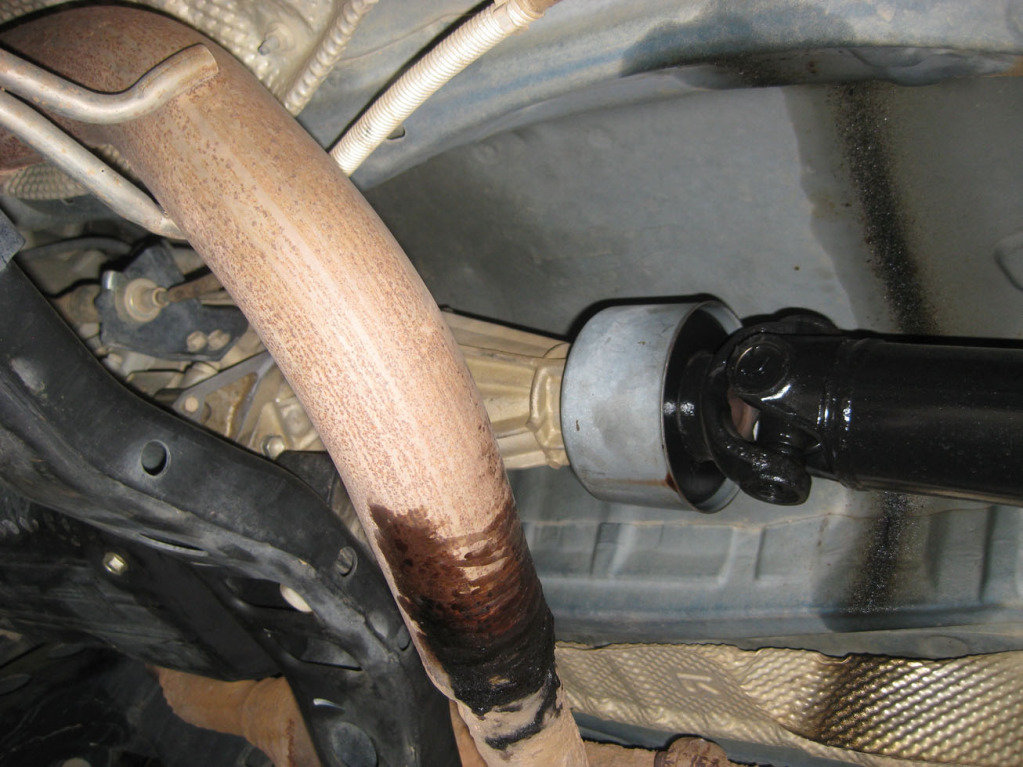

    I have a 2005 Tacoma TRD. Found a leak on my driveway after a 6 hour highway ride (no 4X4).
    What do you think is leaking. I have checked power steering fluid, engine oil, break fluid and coolant and all appear to be fine.
    Any thoughs? The first photo is trouble light no flash on the camera, the second is with the camera flash no trouble light.
    Thanks for any thoughts
    Malfunct10n

    Looks like an oil leak. Possible a valve cover gasket. Put some pieces of white paper underneath the car so you can see what color the fluid is, it might need to be there over night.

    Check front engine front cover. Above power steering pump, and underneath it. Got mine done under warranty before it really started to leak. Use search button there's a TSB for that.

    I have been monitoring it for a few days now, and it does look like engine oil. But because the dipstick is not showing any reduction in fluid I have begun to second guess my assessment. I can see some fluid on the inner wheel well (I thought it might have blown there from the wind on the highway) but I don't see where it is coming from...

    could it be..... oil catch. if u recently had an oil change done, one of two things may have happened. 1- they may have left a small oil catch/container right below the oil filter housing, after driving for a while and rubbing on several parts (fan, belt) or just fell, it may have spilled the residual oil. 2- while doing the oil change, they may have not removed the little oil drain plug on the oil filter housing, plug came loose and spilled residual old oil.
    also, it may be the diff breather tube. i doubt it would leak/blow out that much but its worth a look.
    just remove the skid plate and try to trace oil from source.
    just my $.02

    What's it smell like. ATF and gear oil have distinct smells.

    You could add this stuff we use in the shop called Tracer Dye.It can be added to any
    fluid.Once installed,you drive vehicle normally, and about a week later ,or 1k miles
    you use a uv light.The leak will glow bright green.If added to oil,and nothing shows
    when you check with the light,you just eliminated the engine.It can also be added to your air conditioning system (with a special tool) due to the pressure.

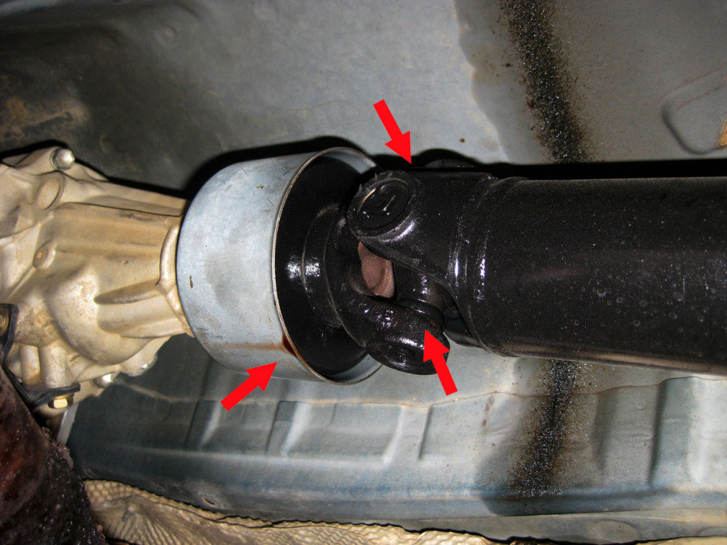

    I have a leak around the tranny case. Can't confirm since I'm not a very good at these stuff. Does anyone know what it is? See the pic of where I have red arrows pointed. I'm guessing is tranny oil that's leaking. My transmission have been shifting rather rough when cold during the first 5-10 min driving. It's especially rough shifting down when I'm coming to a rolling stop from 4th to 2nd. It's fine after driving for 15 min once its warm.
    Any thoughts or help would be appreciated. Once I am able to get an idea of what is causing the leak, I'm going to take it to a shop and make sure what they tell me makes sense.

    Check your front diff breathers in the engine bay. Mine have burped a bunch of oil on more than one occasion. Made a freaking mess under the truck, checked the fluid level... was fine both times. Oil will start at the little caps and go down the 2 tubes

    Isn't the front Diff breather a bit far from where that oil is? :notsure:

    Do you smell that burning @ all when driving?...........Looks like the oils gets into those knuckles and then throws it around while spinning. As for all the grit in it, it has to be dirt.

    The output shaft seal is leaking on the tail of the tranny. If you drive it like that much longer, you will toast the tranny. (Sounds like you're low on fluid)

    Ok from your description it seems you lost too much ATF and now are simply killing transmission. So you need to stop driving and add some fluid first before tranny simply implodes.. then replace leaky seal .:confused::rolleyes:
    ah I was late ... :)

    No, mine was all over... check the hoses on the top of the diff too... could have come off the little bracket with the 2 nipples
