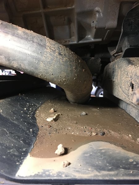

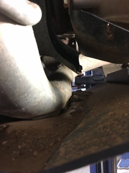

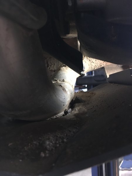

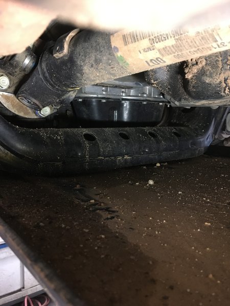

  20. Jan 19, 2017 at 3:44 PM
    #20
    Dudeman86
    Dudeman86 [OP] Well-Known Member
    Jun 5, 2016
    #188820
    799
    Scottsdale, AZ
    2016 Black DCLB OR
    Pics from the dealer. No idea I had that much mud under there
