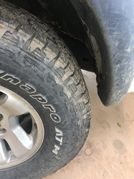

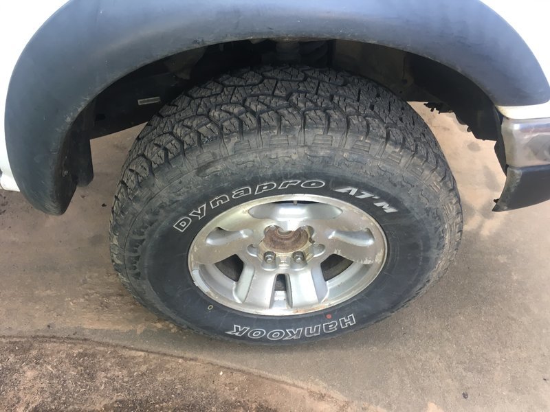

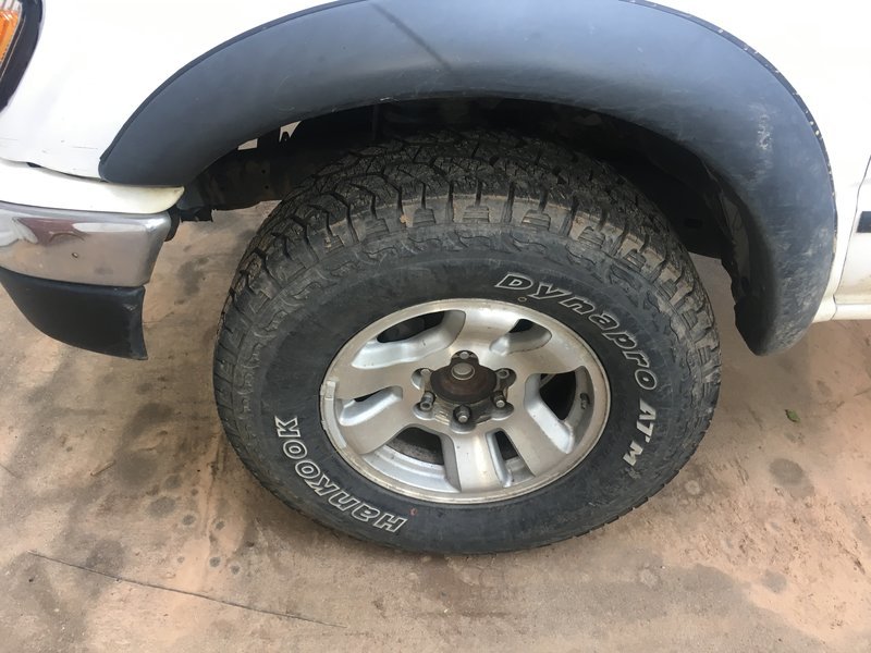

    Hit deer last year on driver side and i fixed the fender and bumper myself after that incident everytime i pull to thhe left my front driver tire always rubbing pinch weld sometimes really hard when i hit bump,also noticed the the wheel is not really in the center between fender gap (photo attached)
    Went to alignment shop twice and they said everything okay,went to auto shop they said they cant help me
    Does anybody experience rhis before and know what was wrong with it?
    Maybe just bent arms or bushings? I looked under and everything seems right
    Also steering wheel pulls to the left
    Driver side close up
    Driver side
    Passenger side for comparison

    more than likely a control arm is just ever to slightly tweaked, that or your frame was tweaked a bit with the deer hit....

    Looks like your control arm is a little jacked. Shoot by a body shop and have them take a look. Should be a simple fix.

    Since it pulls to the left, that's a pretty good indication that the left side has less caster than the right. A lower control arm that's bent back will decrease caster. If there's more camber on the left, that would make it pull to the left also, but from your pics, and description, I'm pretty sure the lower control arm is bent back. Find a better alignment shop. There's no way you can have the wheel pushed back that far and have acceptable front end alignment.

    I know pictures can be misleading, but looking at the pictures, his wheel that got hit, is definitely a couple inches farter back then it should be.
    that is not about any sort of adjustment out of whack, that is bent parts under there
