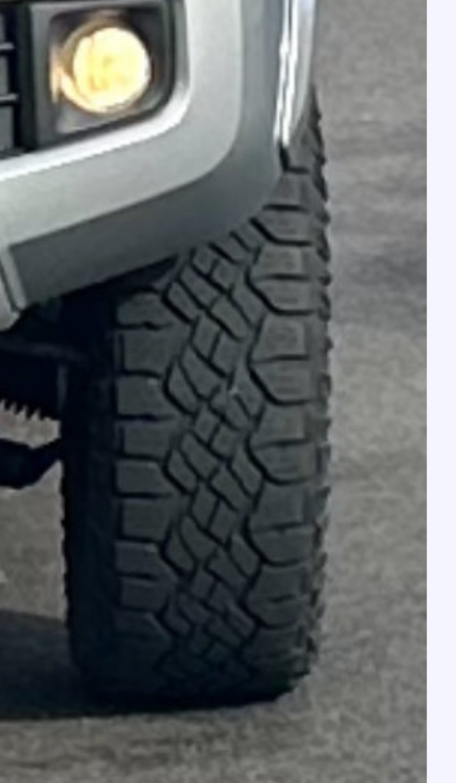

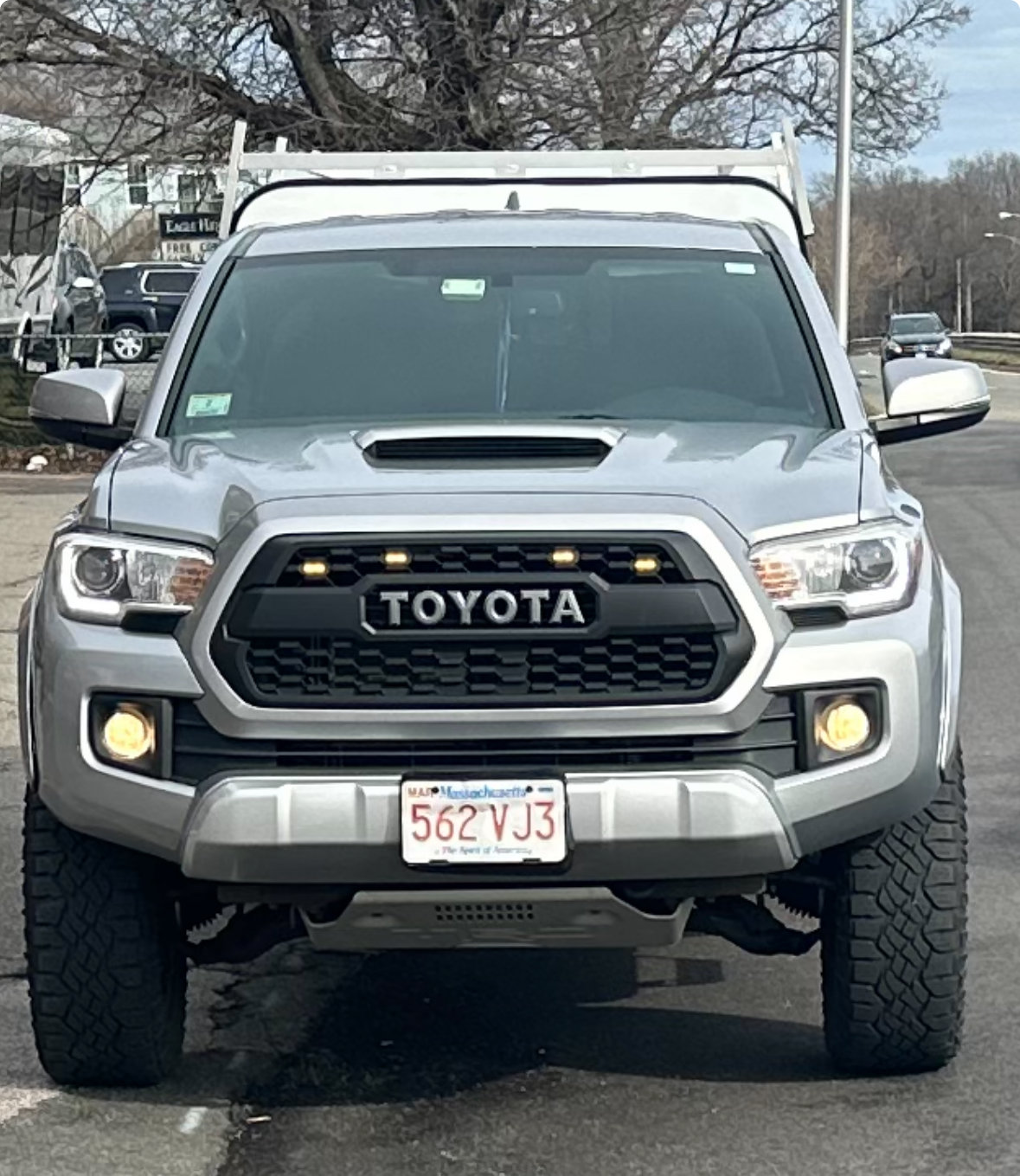

    IMG_2597.jpg Last summer I was at the crappiest boat ramp ever trying to park my boat trailer. At 2mph or less I hit a rock sticking out of the wall with drivers side wheel turned, popped my Duratrac tire. Put the spare tire on to get home and all the sensors were going off and I had drivers tire screeching all the way home. Truck had to go into Auto Body for a claim and while there I had the situation addressed. New upper and lower control arm. Got the truck back and the tire squeeks and skids taken a right. Looking at the tires with wheels straight? The Drivers side is off.
    What else can be changed?
    thanks in advance.

    Drivers side tire is definitely facing out.

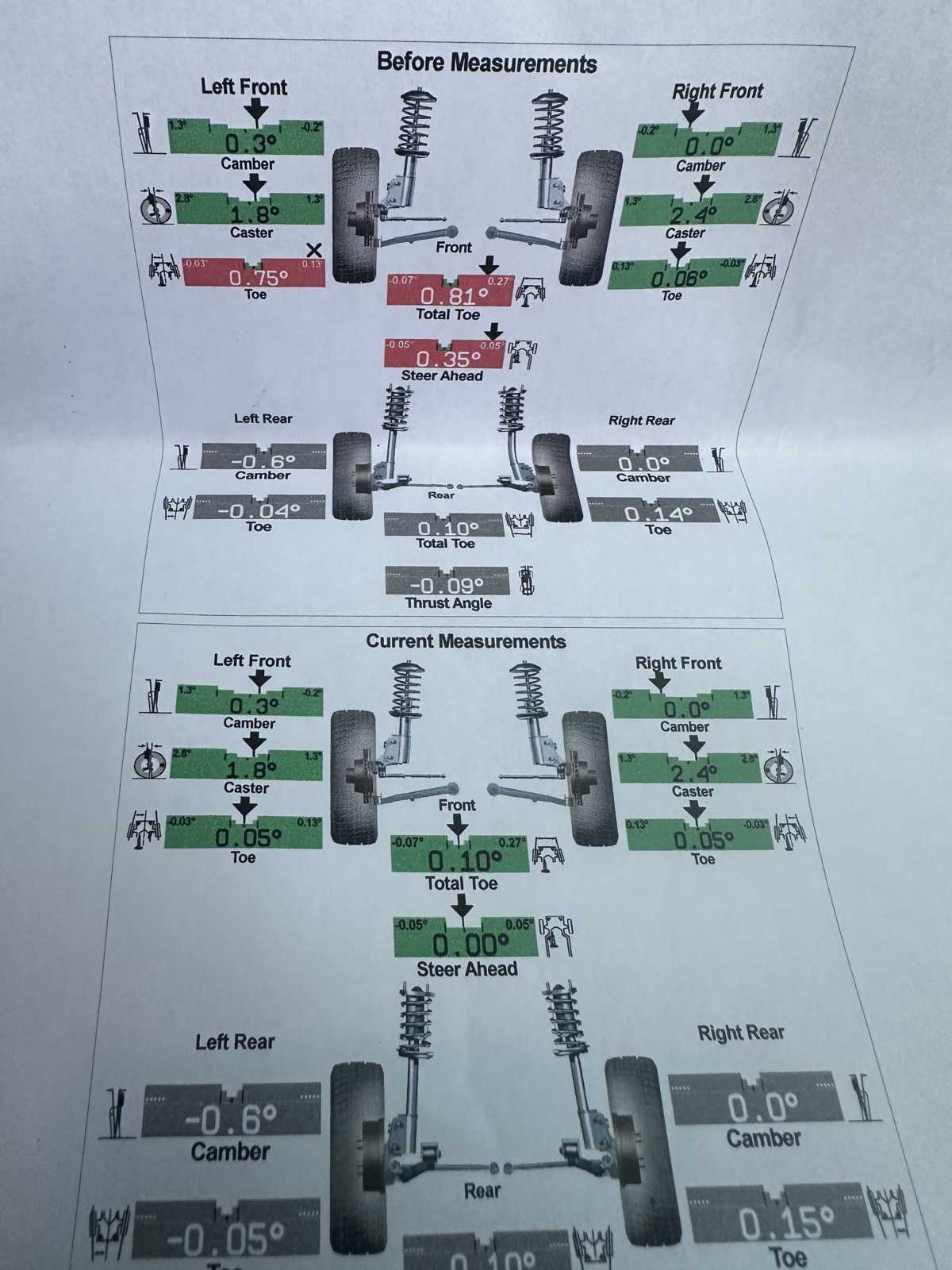

    Had the alignment done. Nothing noted as a problem. I will see if I can find the numbers.

    IMG_2602.jpg Here are the numbers.

    well the pictures don’t match the numbers.. how does it drive?
    Any chance of bringing it back to the alignment shop?

    Looks like your toe was all messed up after the body shop work, which is no surprise , but they got it back in spec. I’d send it.

    This alignment was done after the upper and lower control arms were swapped. I did the alignment it because of the tires screeching on right hand turns. Didn't help.

    Thanks for the insight guys. To me it seems like if the spindle was bad or any other part it should show up on the alignment report. We can all clearly see the tire drivers side is looking the other way.

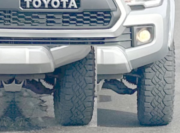

    I mirrored your passenger tire in the photo and put it next to the driver's side tire. One of them is off, not sure which one:
