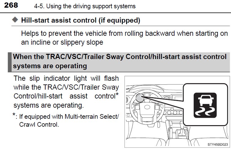

    My Tacoma an 4Runner both do this. It's the HAC (Hill Start Assis Control). It uses the ABS system to reduce how much it rolls backwards on a hill. It is not intended to completely prevent it from rolling back. It is described in the manual. Totally normal.

    From the OM:

    Makes sense. I was going to say it almost sounds like it’s engaging the crawl control.
