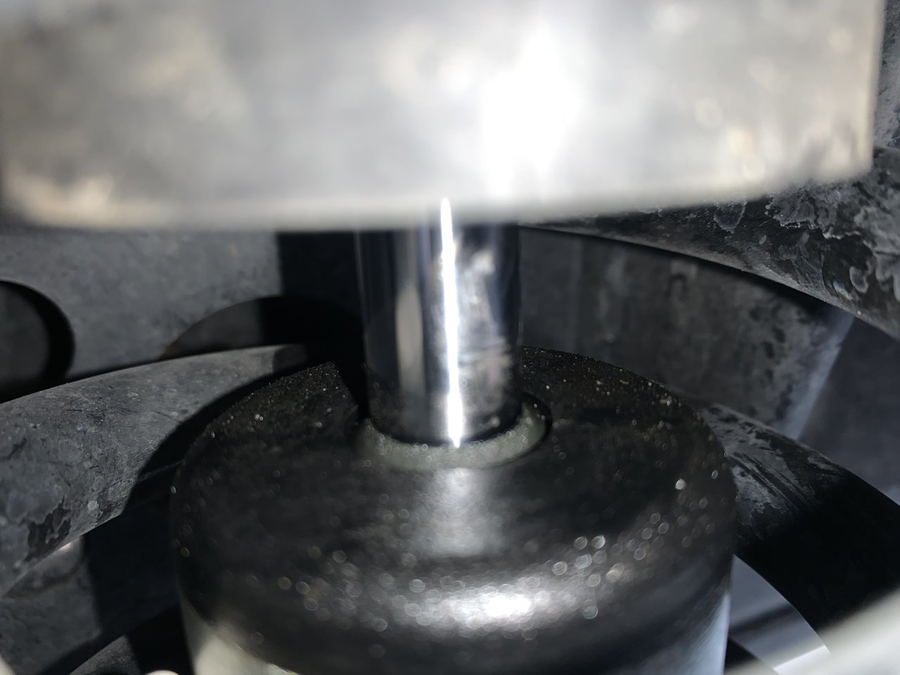

    Alright, it’s diagnose day.
    @Squeaky Penguin i don’t see anything? This is at full droop

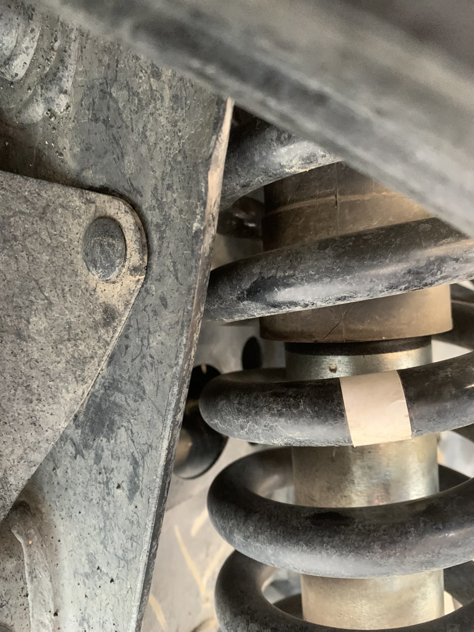

    SoCal
    18' DCSB TRD OR 4x4
    Interesting, the drivers side doesn’t even expose the shaft at full droop. C5B31819-8B8F-4F8A-85A1-A950B36BA562.jpg

    I bet if you remove the top nut that inner shaft would pop right out. The limiter is Broken on the inside it looks like.

    Can't tell from that picture, could be on the back side too. Maybe measure from the lower shock bolt the the coilbucket side to side and compare.
    The shocks are the downtravel limiter (in most cases) on these front ends. If one side droops more than the other, it has to be the shock. Guaranteed that one is toast.
