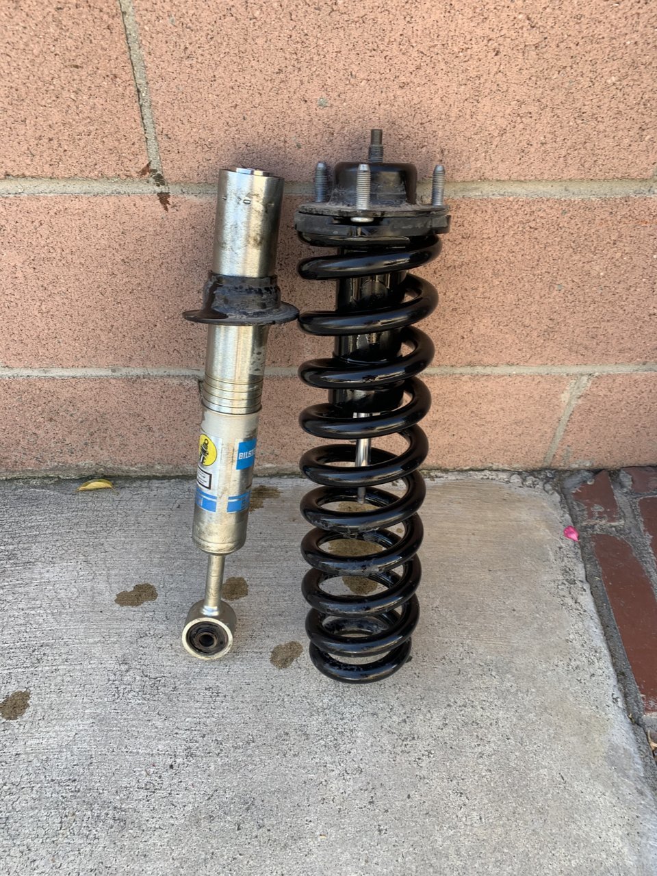

    Is the top nut gone?

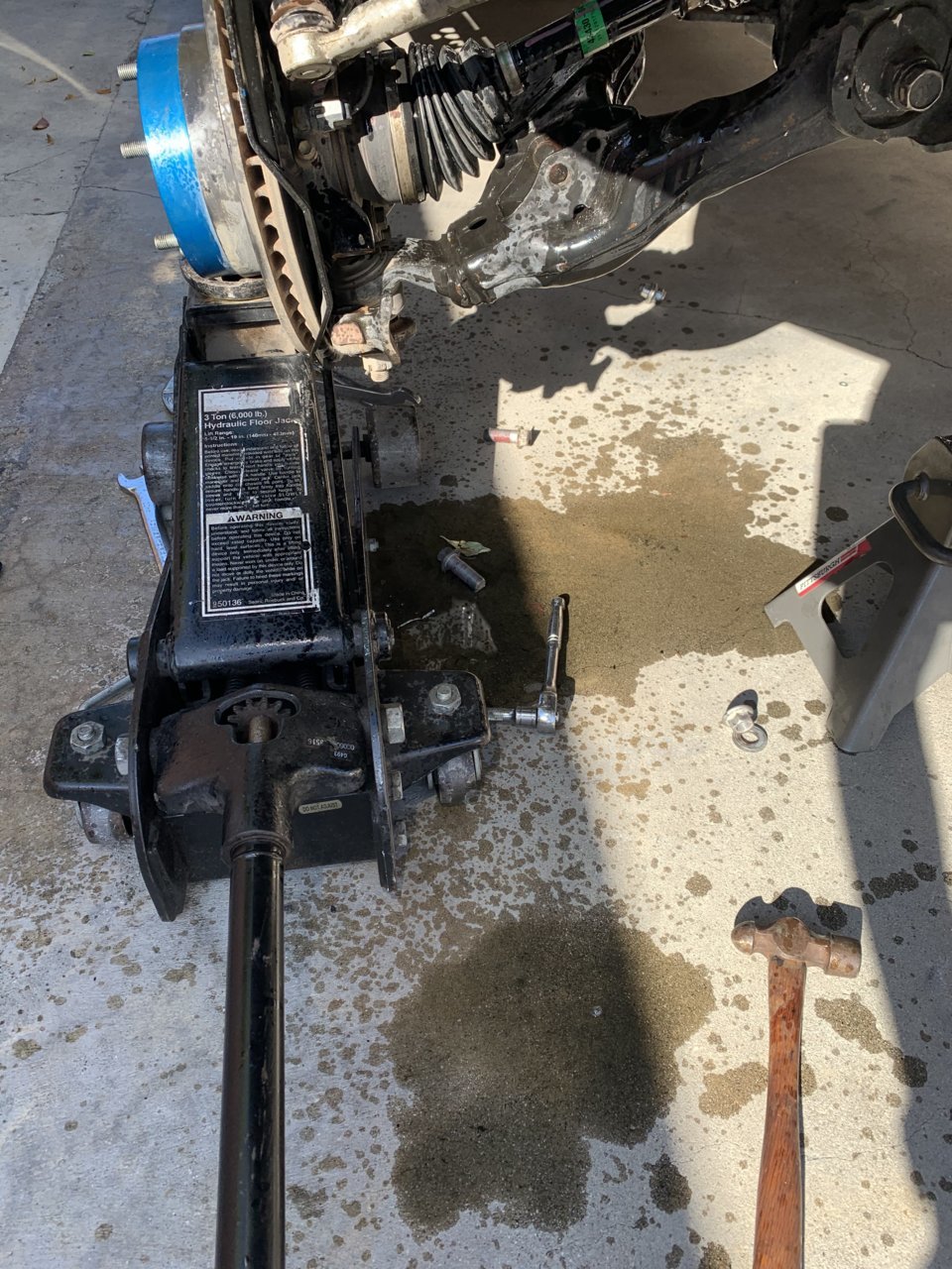

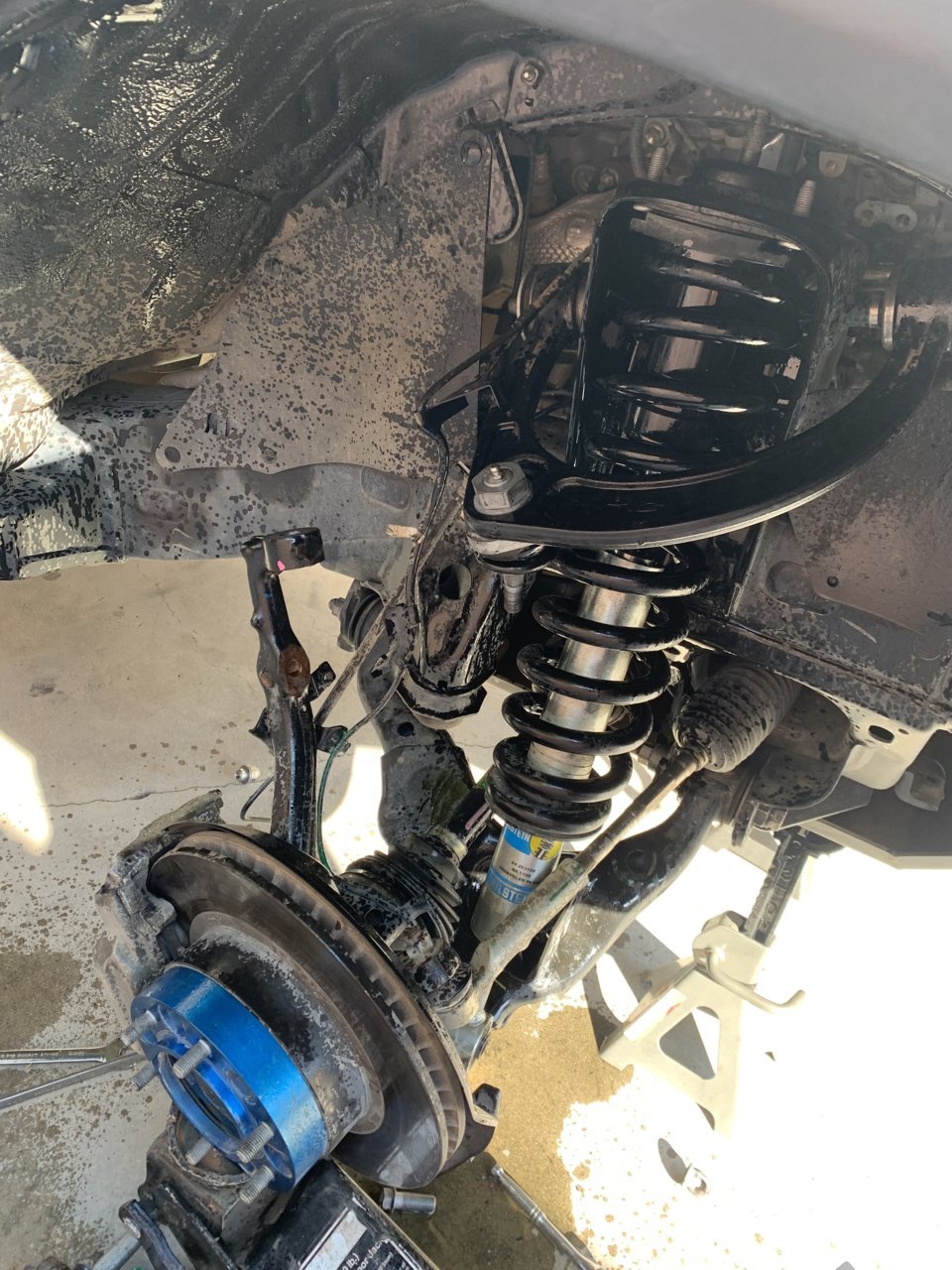

    well... that settles that. Dam thing exploded fluid all over me lol.

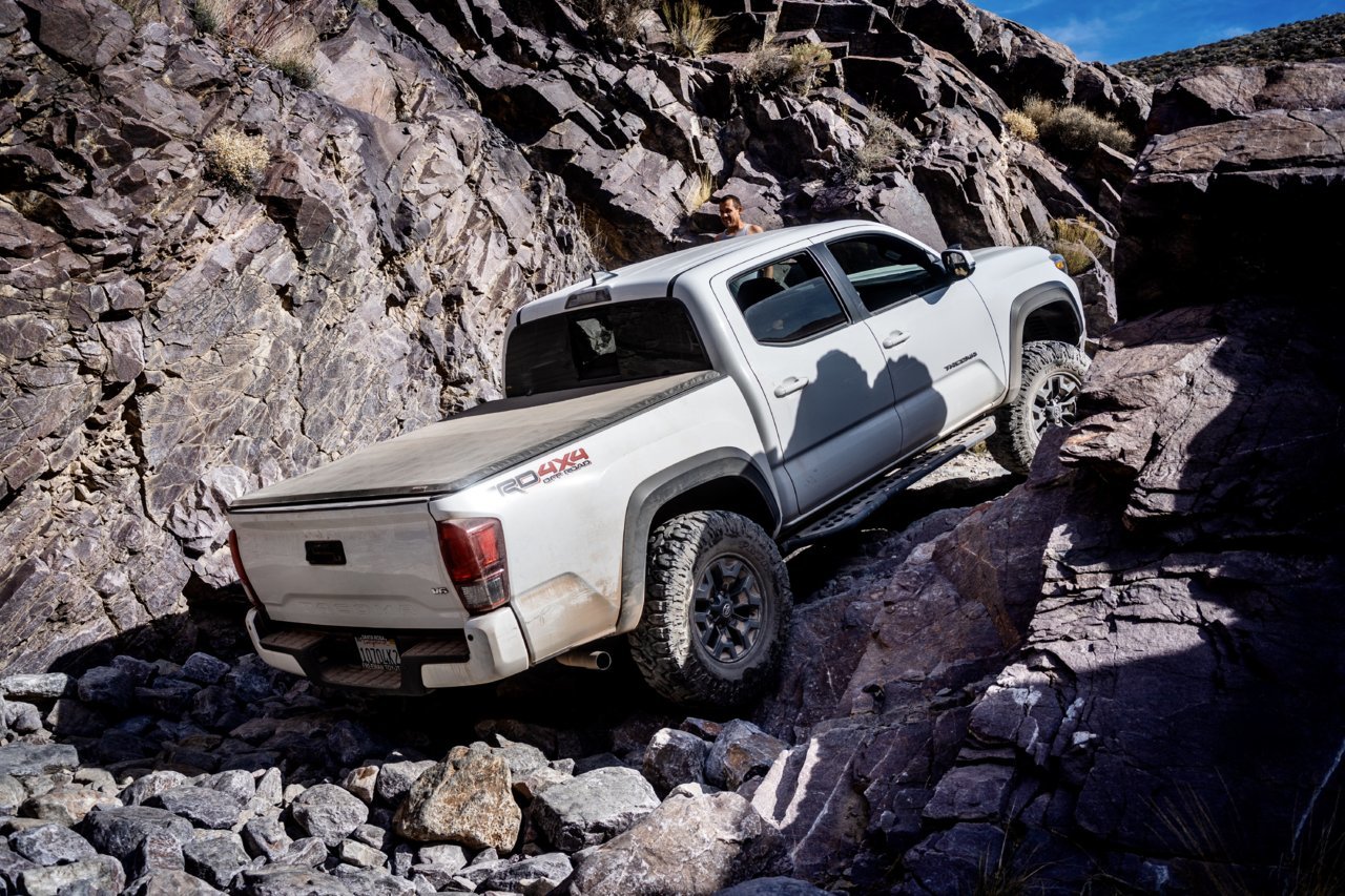

    I guess it’s time to upload the rock crawling photo that probably blew it up lol.

    I know you found out the shock is toast but I'm still wondering if that SPC ball joint got rotated when it got knocked loose like you said...if you tightened it back down with it rotated in a different position than it was before then you're going to have a whack alignment on that side. I knocked my SPC ball joint loose on a trail once and it cause the ball joint to slide inward all the way so that my camber was wayyyy off. Didn't rotate itself though. Anyway that could be a part of your problem aside from the shock issue. Compare it to the orientation of the ball joint on the other side, should be the same.
    It's worth it to check the torque on the SPC top nut every once in awhile if you're hard on your truck, if it's any less than 150 ft/lbs it'll come loose
    Fishallday and Taconator_[OP] like this.

    The joint didn’t rotate, but it did pinch the boot so I’ll probably just replace it. I think I’ll just torque them before any major trail, don’t want that happening again lol.
    I’ll shoot them an email and if it’s a hassle I’ll leave it be. Now I gotta see what route I go with the shocks, been eyeballing fox 2.5s.

    Triple check your outer CV boot on that side, as it looks like there is s split in it, in your picture...
