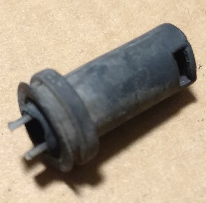

    Speaking of starters, I was messing with my battery cables over the weekend and I knocked off two brittle plastic pieces covering holes on the bottom of my Denso starter. They don't appear to serve any purpose except to cover the holes. Anyone have a recommendation?

    Possibly the breather? Was it brittle plastic that used to be rubber? When I did my contacts over the weekend the breather was still pliable... So I'm not sure which pieces you're talking about.

    Two of these snapped off when I was fiddling around down there. Probably are fossilized rubber pieces.
