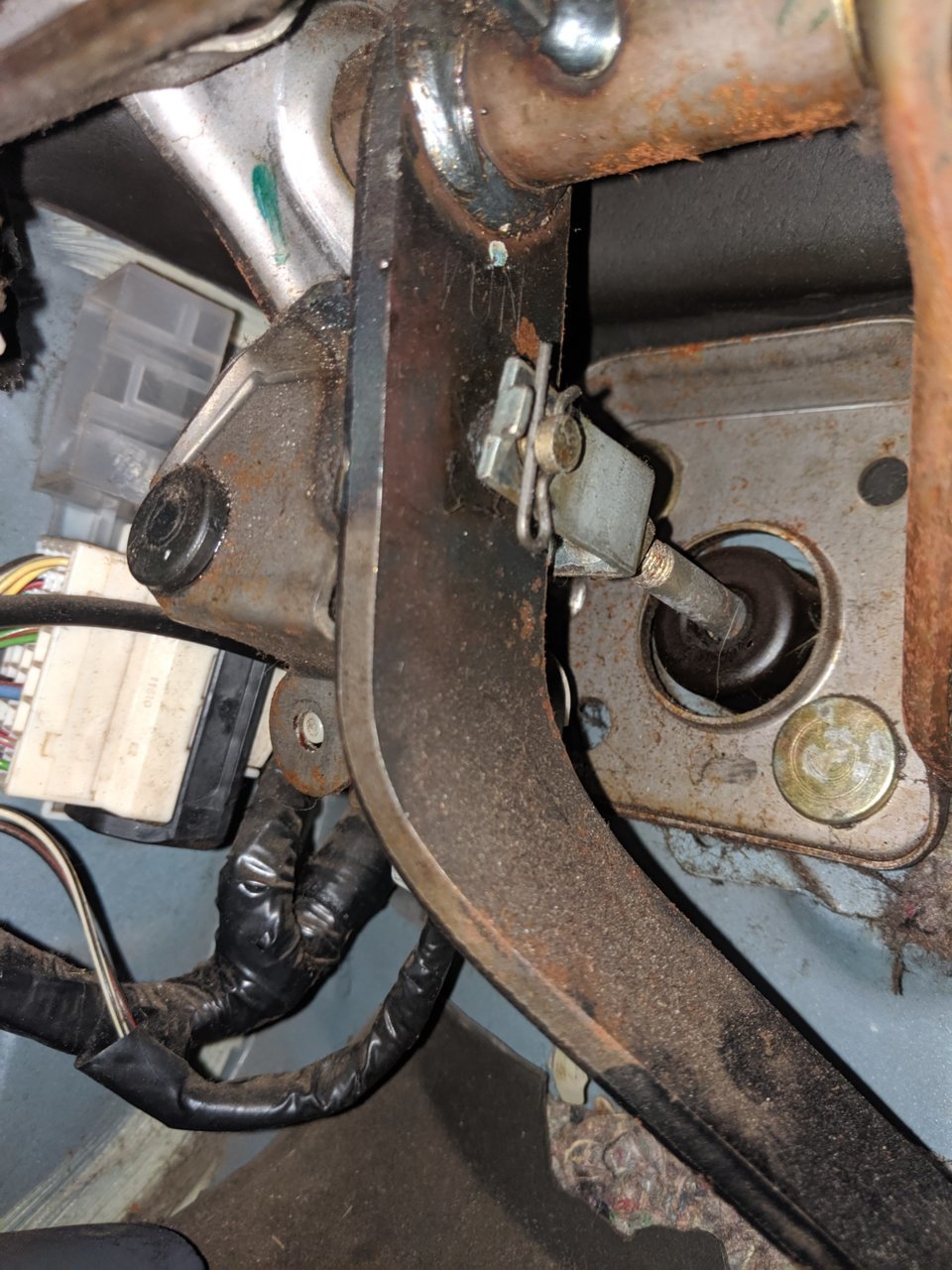

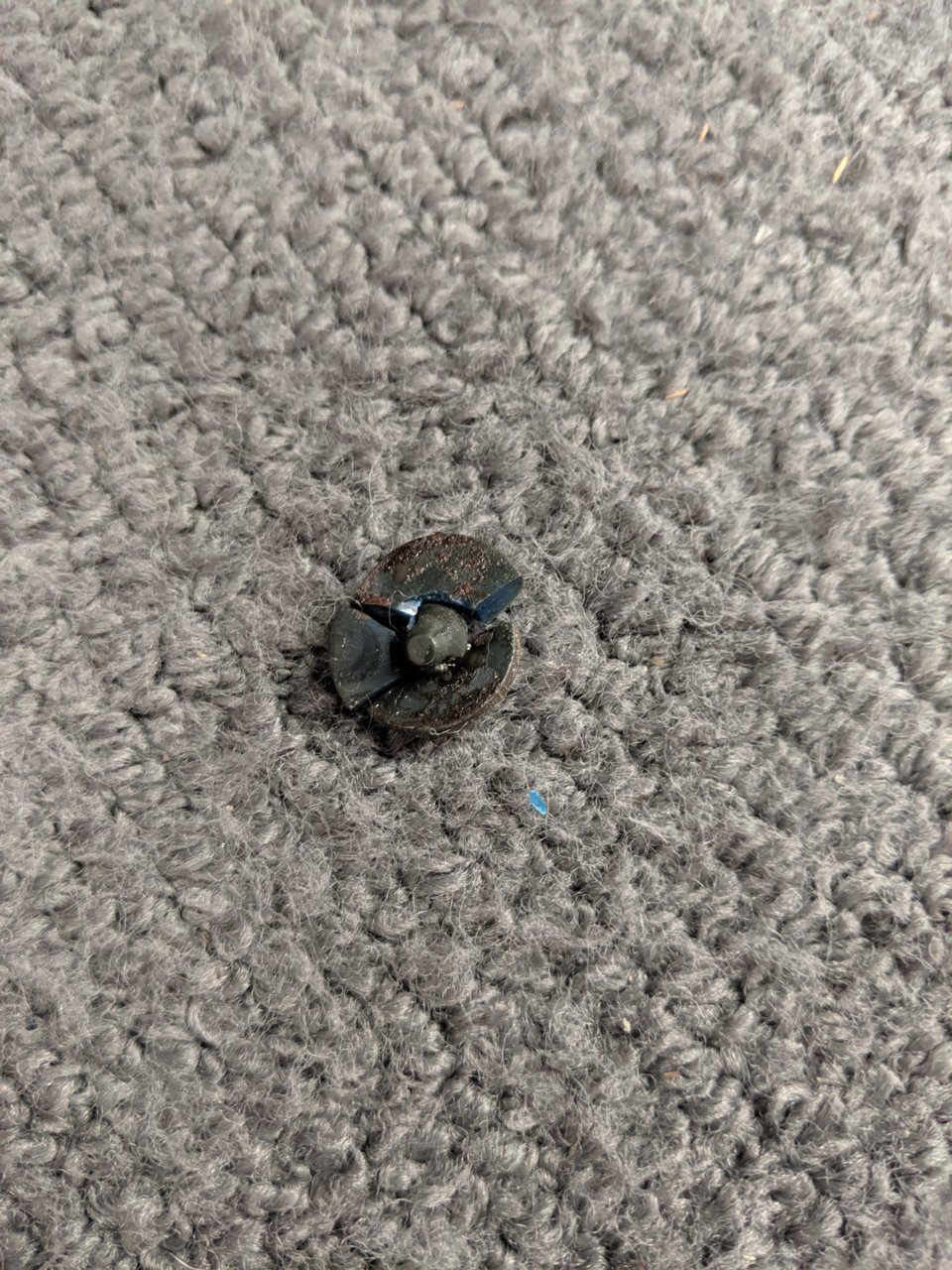

    That was it. The little black piece that engages the switch was broken letting the switch poke through the pad on the pedal that hits the neutral switch. Which is prolly why my Cruise control doesn't work cause then it wouldn't engage that safety switch.
    Actually now that I look at the pic the cruise safety switch may be bad because it looks like that pad on the pedal is still intact
