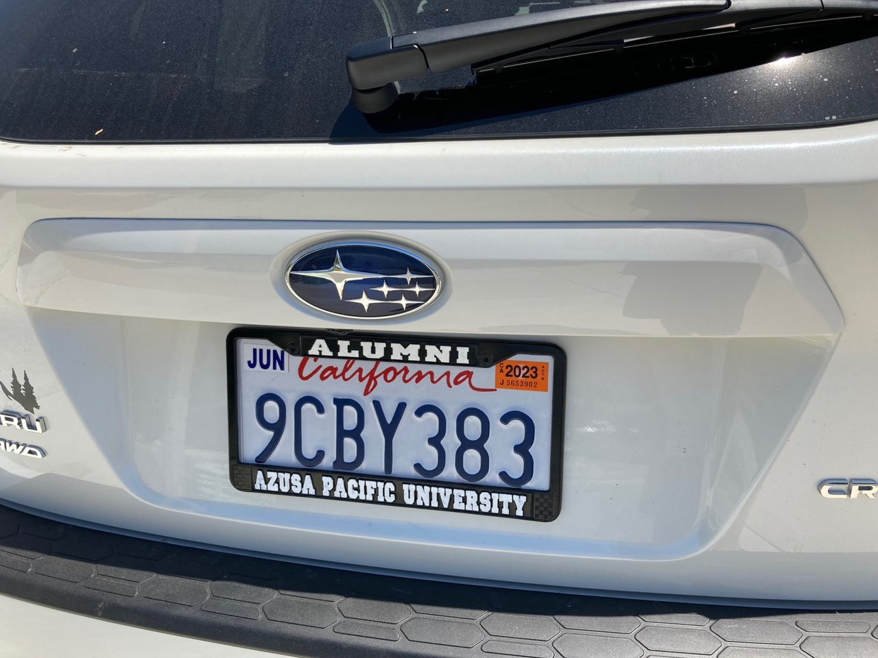

    The plates for my daughter’s new Subie came the other day and she asked me to put them on for her. I have always put our plates on with SS capscrew Allen or torx machine screws backed with nylock nuts to make it difficult for someone to take a plate off as opposed to the usual sheet metal screws used for this purpose.
    It would be unlikely anyone could pull the plate without the proper tools as you can’t get a pair of pliers on a capscrew and the drag from the nylocks make it too difficult to shove a screwdriver in and turn. Impossible to defeat? No, but enough of a pain to prompt someone to move on. For some damn reason, getting your plate stolen is not uncommon, especially where I work. Apparently, if you have personalized plates and the tagged one is stolen, it’s gone forever.

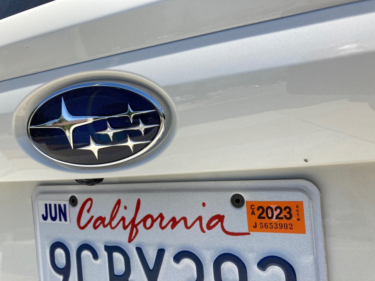

    Anyway, I changed up my plate game a little because my daughter wanted something a little different on her Subie and I noticed a scratch on my own plate when I changed my tags which made me think someone tried a screwdriver on it. I made a simple dimple die with a spacer and used pan head screws. My daughter wanted black fasteners, all flush and wanted the plate frame from her college on the car.
    Cut the dimple with a countersink using a drill press.
    Smoothed it with a bit of sandpaper and radiused the edge.
    Used a pan head screw as the other side of the die and tightened it together.
    Makes a nice dimple which allows the pan head machine screw fit flush. Now I can use her plate frame (which covers the bottom screws)have the look she wants, and have four screws holding the plate. Now I’m going to pull the plate on my truck and the ones on my wife’s Jeep and do the same thing.
    A little dumb, yes, but when I’m set in motion I end up with something like this. It usually starts with, “Please Daddy, for me”. Anyone with a daughter knows what I mean.
