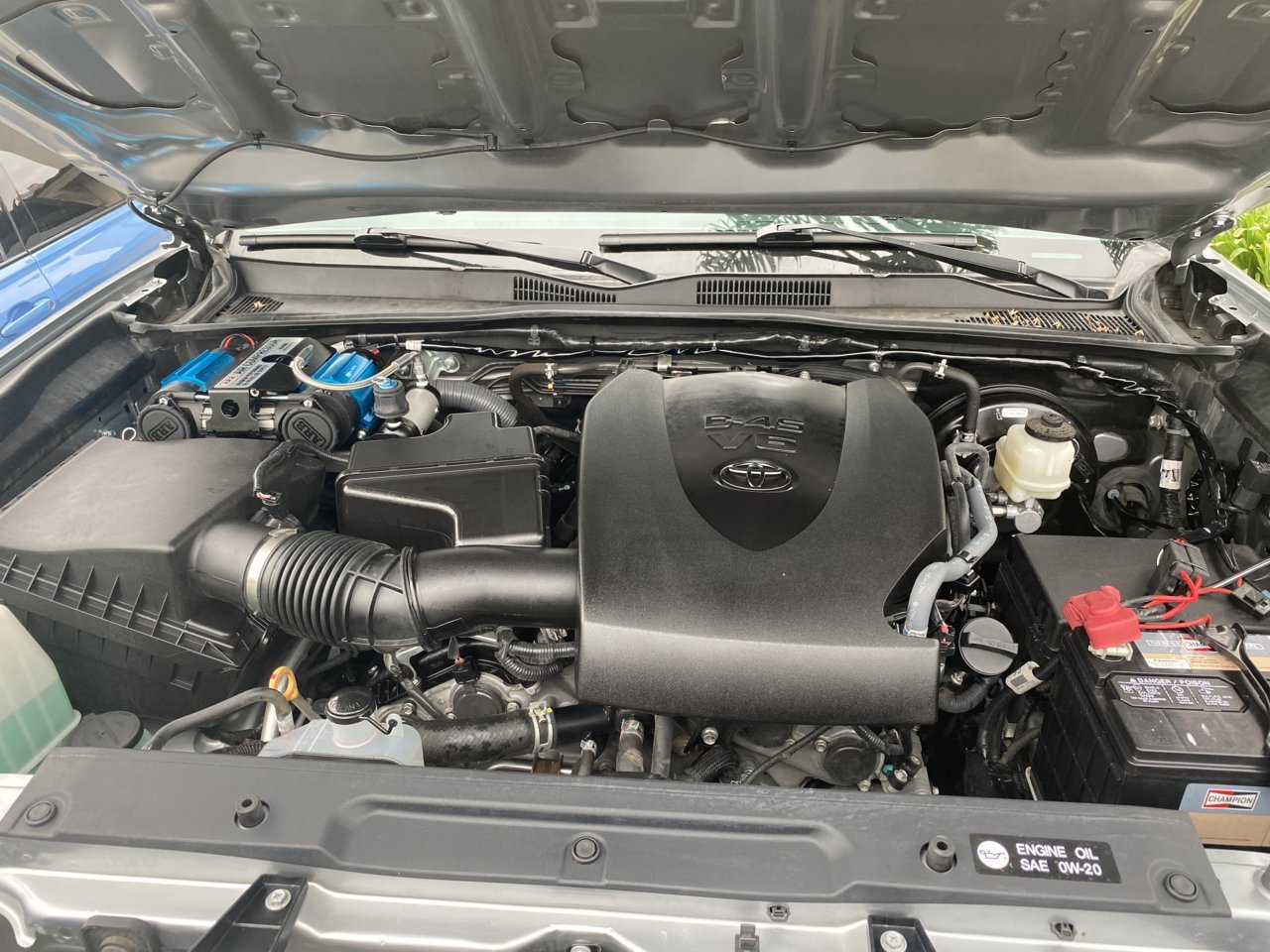

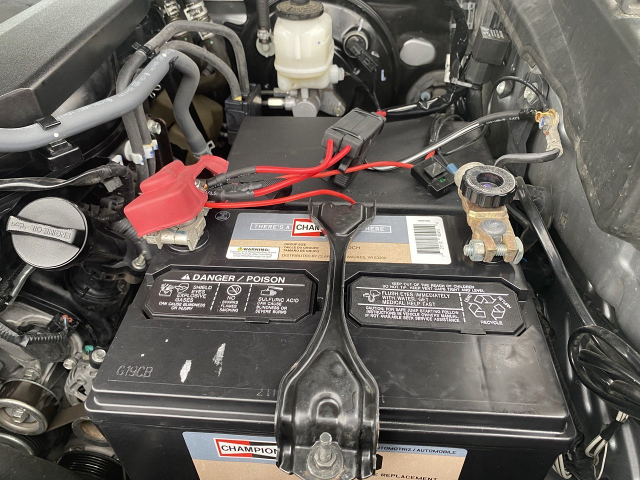

    When I went out to take these pics it started up no issue.....
    26E30BF4-F368-4A28-A8FA-2513CA2311E6.jpg 62B7DDB4-A2C7-44C6-832D-E94772E701EA.jpg

    Screenshot_20211007-182507_Chrome.jpghave you looked at your disconnect terminal? Is it tight and connecting well? Is it a cheap unit from Amazon or a quality one?
