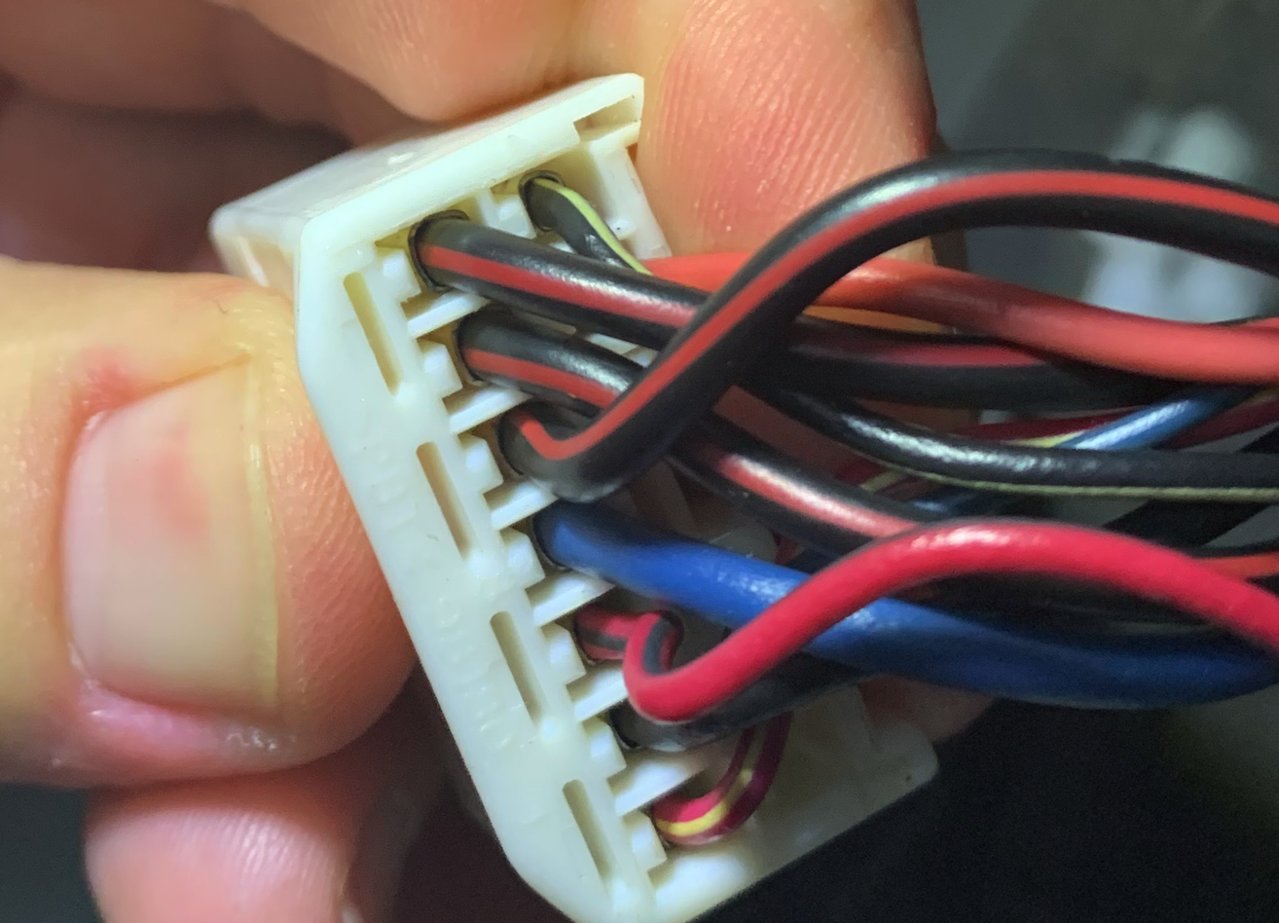

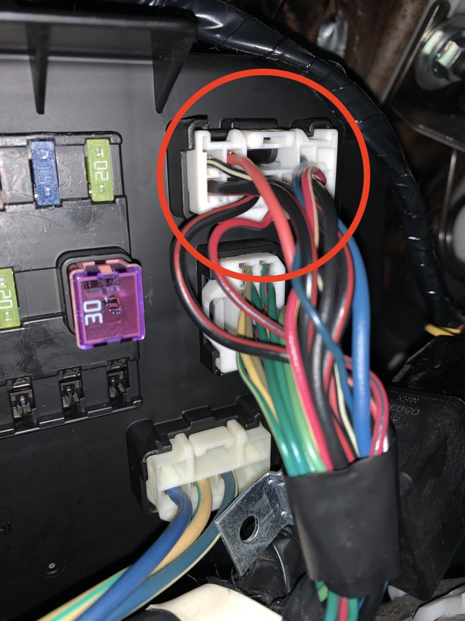

    So I think I found out WHERE the issue is coming from. Its the wire connection in the picture attached, right next to the fuses. I can push on this connection with the keys in the ON position, and the check engine light will come on and turn off, like there is a bad wire connection, I assume. I unplugged this connection and there are no burn marks, so thats good. Any ideas, or anyone ever had issue with this wire connection before?
    Also, when I push this connection and hold it so the CEL stays on, I start the truck and when I let the connection go, the truck turns off (assuming because the power to the ECM is cut due to this wiring issue).

    That's a new one, good catch!
    Is the whole plug loose in the socket or do you only need a smidge of pressure on it?
    Any of the individual wires loose from the back of that connector?
    If you haven't maybe try pushing in on each individual wire and see if just one of them turns the CEL back on.
    You could get it repinned.
    An odd issue for sure! I'm still shuffling through the FSM for that wiring diagram. My copy isn't labeled properly so it's a fun experience.

    That’s connector 1B. The black/red wire in that connector feeds power from the ignition switch to the 15A IGN fuse and the 7.5A GAUGE fuse. Put a multimeter on the IGN fuse while you futz with that connector. If the meter reading drops, you know which wire is the culprit.

    And the body ECU is on the back side of the fuse panel.

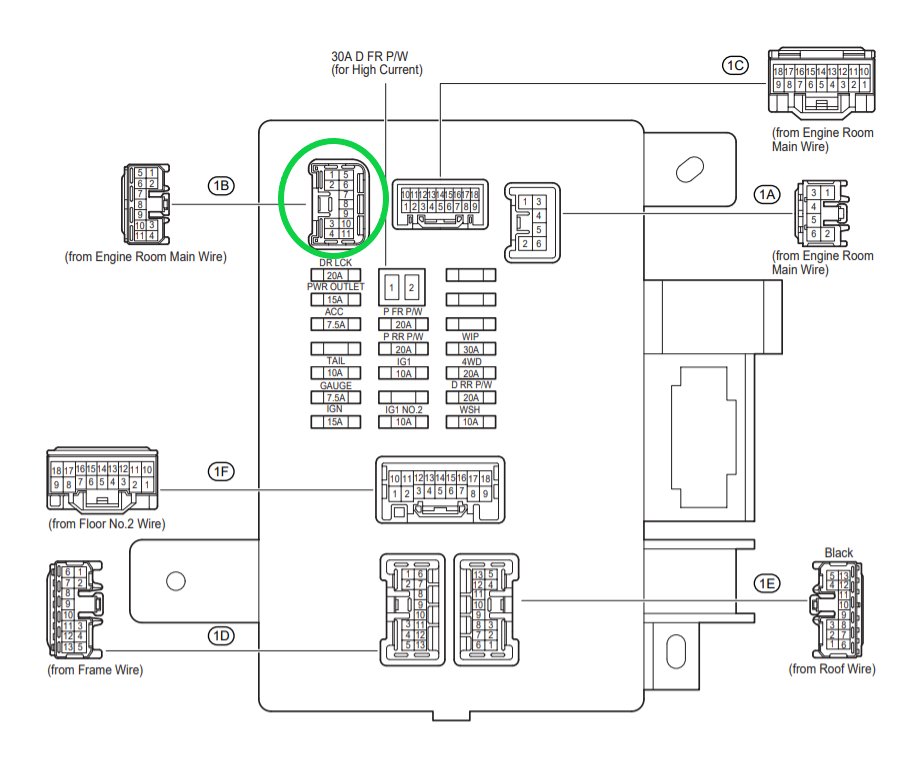

    Alright I was able to track down the correct FSM diagrams and trace the wires off that connector.
    It is designated B1 as @Muddinfun said and @Jimmyh is correct that the body ECU is on the back side of the fuse panel.
    Here's the connector and numerical pin locations circled in green.
    B1 wire pin locations, colours and supported vehicle systems
    1. Unused
    2. Blue ------------ Stop Lamp Controls
    3. Pink ------------ Windshield Washer Motor
    4. Black & Yellow - Turn Signal Hazards
    5. Red & Yellow --- Front Turn Signal RH
    6. Black ----------- ECM, Electronic Fuel Injection
    7. Red & Black ---- Front Turn Signal LH
    8. Blue ------------ Windshield Wiper Motor
    9. Black & Red ---- 15A Ignition, 7.5A Gauge ---- *See Below \/
    10. Black & Red ---- Ignition Coils
    11. Black & Red ---- Fuel Injectors
    Several of those lines run through the ECM so if it is loosing signal/power that could be causing issues with the check engine light and the truck starting. The only wire from B1 that interacts with the Engine Immobiliser System that I saw is #6 for the electronic fuel injection.
    I attached a PDF with the fuse panel locations and layouts.
    *From Above ^
    Location ------ Use ---- Fuse -- Description
    1. ---------- IGN ---- 15A --- Multiport fuel injection system/ sequential multiport fuel injection system, anti-lock brake system, traction control system, vehicle stability control system, SRS airbag system, front passenger occupant classification system, engine immobilizer system
    2. --------- GAUGE - 7.5A -- Meter and gauge, emergency flashers, front passenger’s seat belt warning system

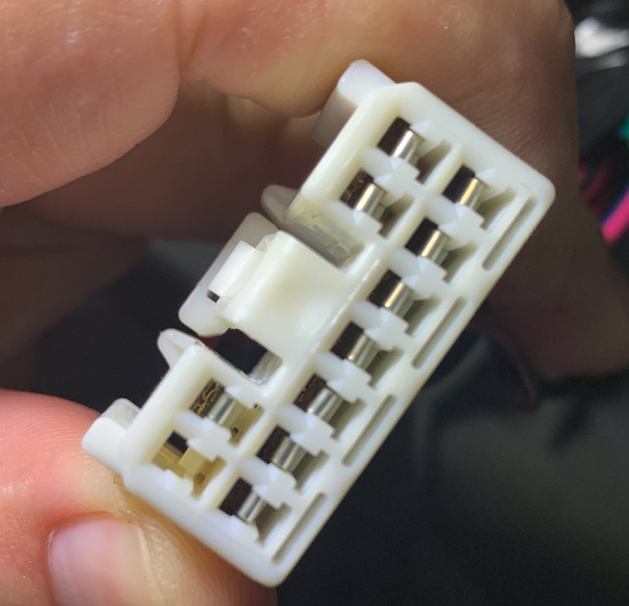

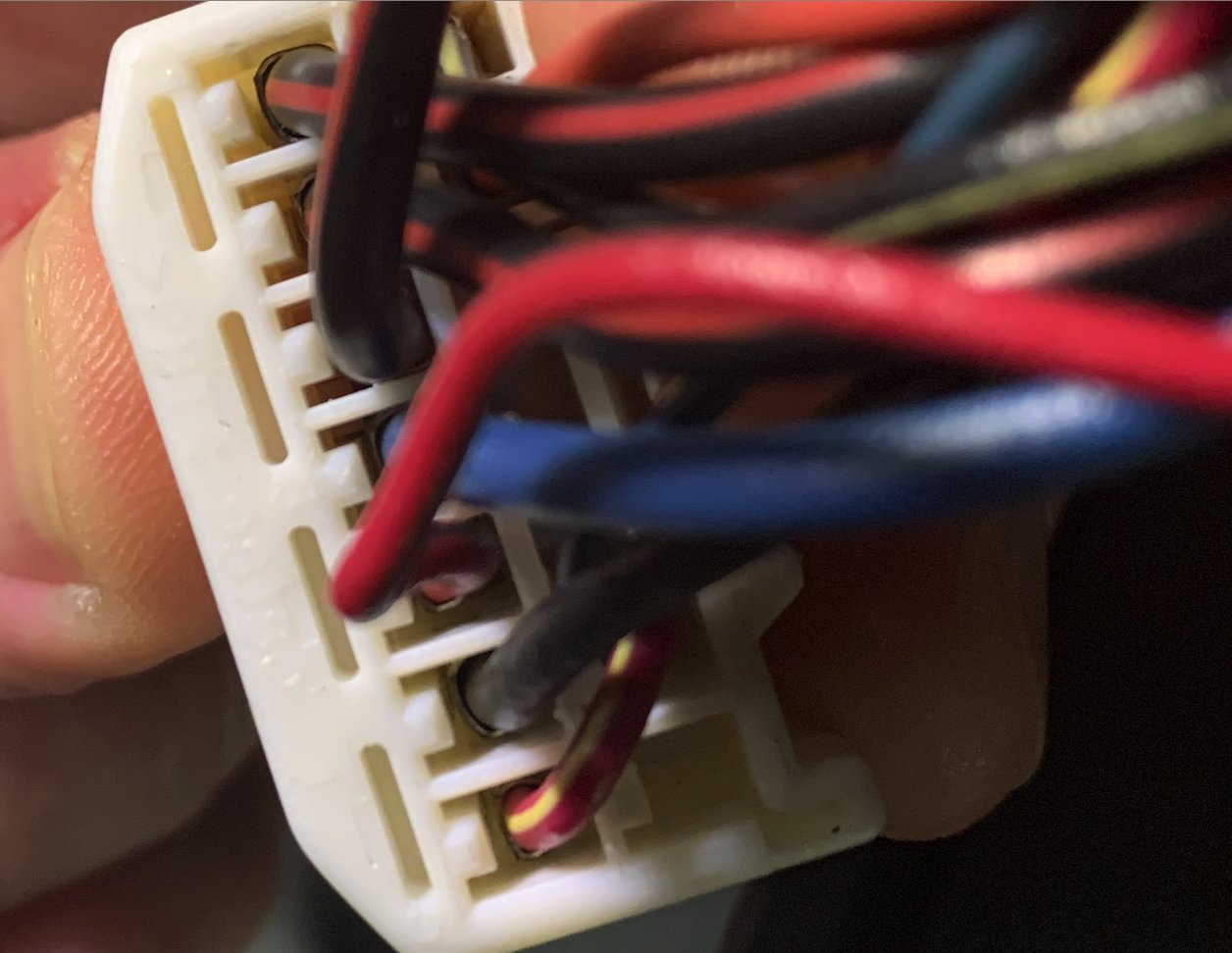

    YES! You guys rock! I was just out there and noticed that one of the wires (around the #9) seemed to be a trigger, then this confirms that. So I still am not sure what the issue is. The wire doesn't seem loose, and I cant get the CEL to stay on, it will turn on, then eventually turn off, like the connection broke again.
