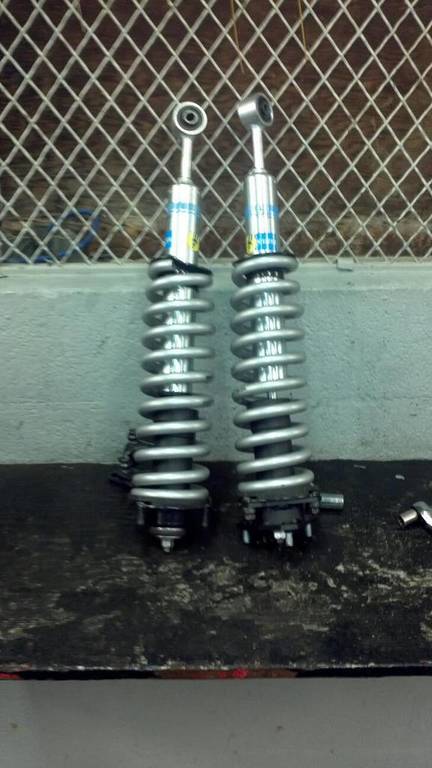

    Bilstein 5100's with Eibach's and Top Plate Spacers

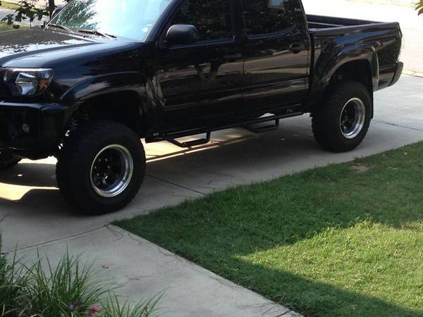

    16x10 ions with some Treadwrights I had in the garage. Was not a fan at all. I had spydertraxx 1.25's all around to clear brakes.THEY DIDNT LAST LONG

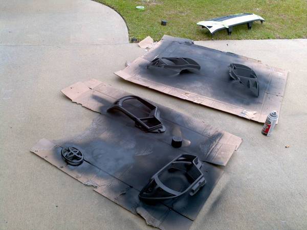

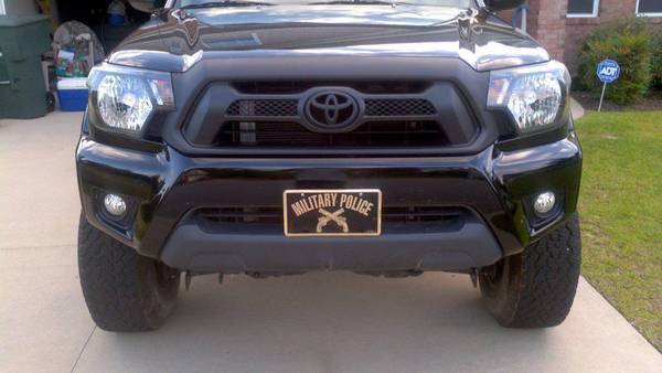

    BHLM complate and platisipped the grille and Toyota emblem

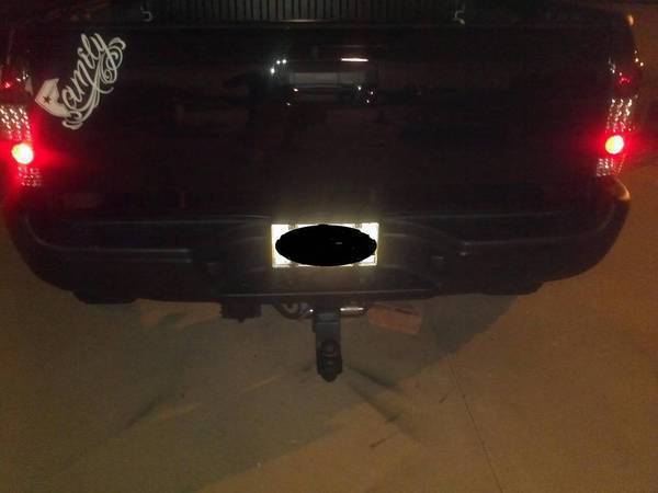

    Plastidipped the rear bumper and added a Famous Family sticker Ive put on every truck Ive had

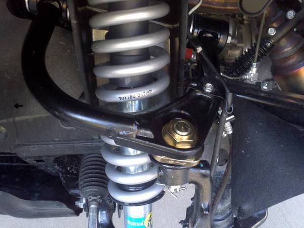

    Replaced the front UCA's

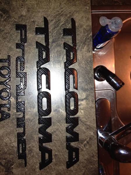

    Had the badges done by a member I found on here

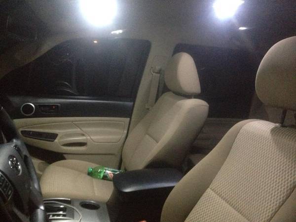

    Replaced the interior lights with LED's from CSjumper

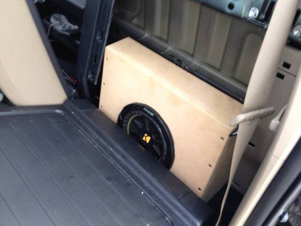

    8" Kicker in Custom Box built by another TW member with 200w Kicker AMP

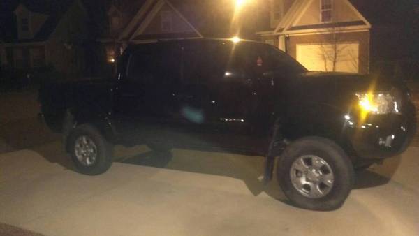

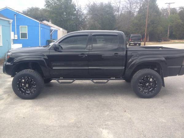

    How it sits today with new 18x10 Moto Metal's and 275/65/18's(21JAN2012)

    What setting do you have the 5100s at? Looks really high

    I have the front set at 1.75 w/top plates and the back is low cause its got a cheap AAL on it that sagged. Putting AP leaf pack on next weekend. I'm taking the eibachs off also and putting the shocks at .0 next month cause I'm going to spindles

    ok cause the eibachs aren't supposed to be up past the .85 setting and the fact you have top plates means youve got 4"+ of lift

    Yea I know. I haven't had the chance to change it with my work schedule. They have been that way for a while now. Funny part is that it's rides smooth and wasnt like I thought it would be but they are coming off during my cycle break. Putting spindles on it.
