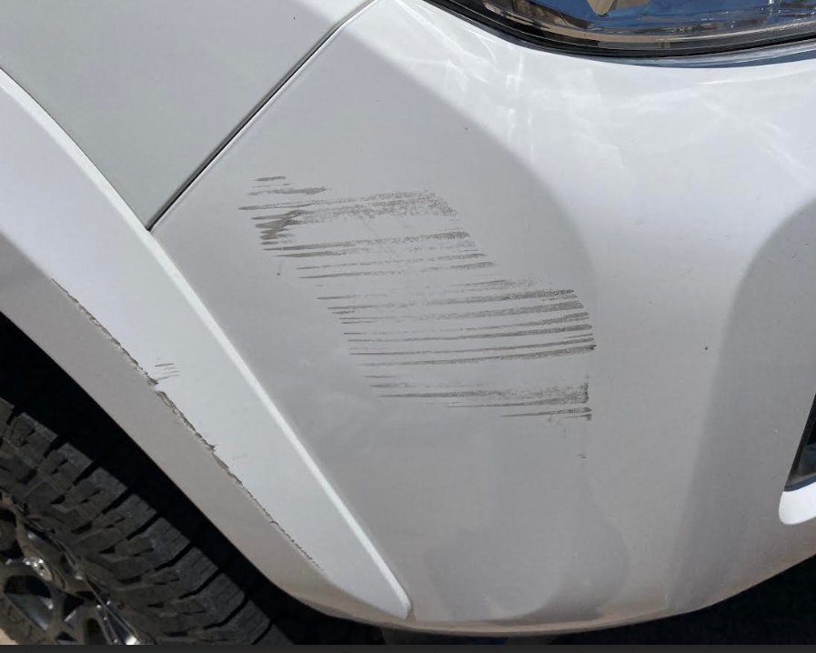

    Yea I know this isn't the end of the world but what pizzes me off is I go OUT OF MY WAY
    to park so nobody can even get near this thing. Still somehow in the last day or two some
    S.O.B. rubbed right into the front passenger fender leaving their scuff.
    Wondering if this will 'buff-out' with some kinda compound. Gotta check later to see if
    there is actual 'fender-bend' in this Q-Panel it's so damn bright outside I can't really tell.

    That look like tire rubber streaks, so it might come off with some rubbing compound and some elbow grease. I'd personally pay a body shop to correct this, they do this all day long.

    I think if that were tire rubber, the scuff pattern would have an arc shape to it as the tire made contact while turning. Looks like a dark grey vehicle got you. See if the parking lot that you were at has surveillance cameras.

    Looks like it should mostly come out. White is probably one of the easiest to touch up and not have it look like ass. Still, sucks you're dealing with it and people need to watch what they're doing.

    Seems to me a tire doesn't make sense due to how high it is... this ain't Hawaii LOL...
    I wonder what I'd pay to get that corrected by a 'pro'. I'll try some compound on it first.

    That sucks. Most of that will buff out with a good medium grade polish and some effort. The sharp edge of the wheel arch trim may have some deep gouges though from what I can see.
    Edit: Meguires 105 followed by Meguires 205 works good for that sort of rash. 205 by itself will get it done with some time.

    As others have said, take it to a body shop or detaling shop.
    As a test, if you rub your nail along the scuff, do you feel the edges of the scratches? If not, it will likely buff out. If so, it won't buff out, but they should be able to clean the paint transfer off and mitigate the visual damage.

    op, I think that will buff out easily

    I had something similar on my truck and I used trim restorer, not sure if it works on this.

    WD40 with Mr Clean magic eraser will clean up 90% of this. Then just rinse, polish, and wax... and wait for the rest of your Super White paint to peel off "naturally" in large pieces, usually starting around the window frame :p
    I suggest Meguiars ScratchX and Turtle Wax Hybrid Ceramic spray wax.

    Good thought I'm gonna just give it a nice slow wash and see what comes off then will try your suggestions.
    It's a 2021 and knock wood no peeling has occurred and it sits outside 100% of the time in direct blistering Arizona heat.

    Try some bug & tar remover first before cutting it with compound. If that's just transfer and not actually scratched it'll take it right off

    Looks relatively light and not too deep from the photo man. I would hit it with some Goo Gone, then some Bug and Tar Remover, Lastly some 90% Isopropyl Alcohol to remove anything remaining, wax and all. If you have a buffing wheel, I'd hit it with some light/Mild cutting compound, then finish off with good heavy duty wax. As long as the fender isn't gouged deep enough it'll catch you're finger nail anywhere when you run ya hand over it, it should mostly clean right up and be good as new. If you don't wanna mess with it yourself, look around you're local area, call a detailer and or detailing shop, talk with the main dude and explain the issue. I can't see it being more than $3-500 bucks at most to make this brand new again. I do the same, and park far enough from the general population... And I currently have a grocery cart/buggy dent on my passenger side... Ugh people SUCK.
