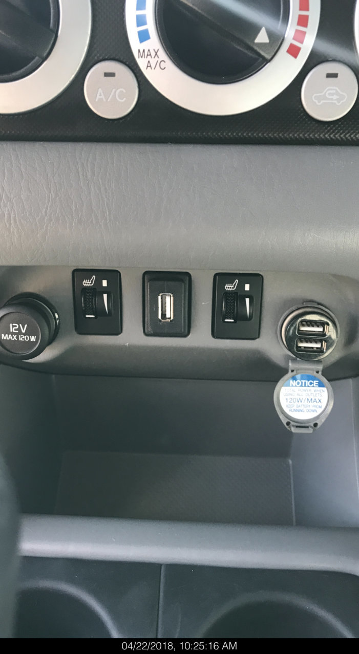

  13. May 9, 2018 at 4:27 PM
    #53
    Slodojo
    Slodojo New Member
    May 9, 2018
    #253023
    2010 Tacoma
    How did you make that USB spot? It looks great!
  14. May 10, 2018 at 2:22 AM
    #54
    TACOMA2NDGEN
    TACOMA2NDGEN Well-Known Member
    Jan 24, 2018
    #242230
    1,421
    ROLAND
    new jersey
    2010 dcsb silver sport trd
    baja squadron pros
    i bought a usb cord off ebay that has a female end on one side that went to the stereo and the other i cut an opening in the blank to make it fit .took a drill bit made a big hole and then with a dremel sanding knob and a sharp knife i just kept triming until it pressure fitted in i ended up just cutting off the tabs on the cord .i was going to glue it in but its pretty tight https://www.ebay.com/itm/AUX-Flush-...e=STRK:MEBIDX:IT&_trksid=p2060353.m2749.l2649

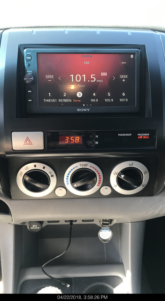

  15. May 12, 2018 at 1:21 AM
    #55
    sbates
    sbates Well-Known Member
    Dec 13, 2010
    #47635
    119
    Steve
    NJ
    2011 Tacoma TRD Sport Double Cab
    Extang Tonneau Cover, aFe Pro Dry S air filter, Weathertech Floormats, De-badged, Plasti dipped Toyota emblem black, Plasti dipped a/c control panel black, 48-led Dome Light, Tailgate Damper,
    I'm very interested in this Sony. CarPlay and Bluetooth is all I need these days. What Alpine amp are you using to power it? Where do you have it mounted? Thanks!
  16. May 12, 2018 at 1:23 AM
    #56
    sbates
    Dec 13, 2010
    #47635
    119
    Steve
    NJ
    Nice looking install. Does the unit not support steering wheel controls or did you just not purchase that harness? Thanks!
  17. May 12, 2018 at 5:15 AM
    #57
    TACOMA2NDGEN
    Jan 24, 2018
    #242230
    1,421
    ROLAND
    new jersey
    baja squadron pros
    i did purchase the steering wheel harness and i hooked it up per direction. but it didnt work for me but i never uses the steering wheel controls anyway its not like the volume knob is over by the glovebox
