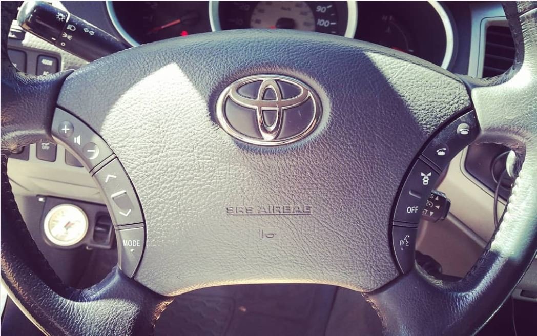

    I'm having the same problem. I just put a Kenwood DMX7004s in my truck this weekend with a Maestro RR and I ordered the 5 button right hand controls out of Japan in the hopes I'd be able to use all of them. But none of the right hand controls are working. Before I called iDatalink I wondered if it may be something physical, whether their is a clockspring for left side only AND left and right, or if maybe the US left hand controls are not compatible with the Japanese right hand controls. I'd love to know what the solution is to your problem, maybe it's the solution to mine.

    Not sure about your Kenwood, but read my previous posts in this thread. I added the right side buttons and the cable that plugs into the left side. A new clockspring isn't needed. I'm not sure what you mean by 5 button right hand control...

    I got the one for the Japanese and Russian market. It has 2 extra buttons whose original use I am unsure of. One says OFF and the other is a picture of the front of a vehicle with two fields emanating forward and outward. Someone said they might have been for radar guided cruise control, but I can't confirm that.
    Also, I got mine working. Figured out this morning when I drove to work and the right side controls didn't light up. I didn't plug the cable all the way in on one side. However, it's worth mentioning that at this time, iDatalink doesn't support their use with the Maestro. You could probably make them work with the SWI-PC if you could figure out what the resistance was for them and write your own software. The Metra may be able to use them as well.
