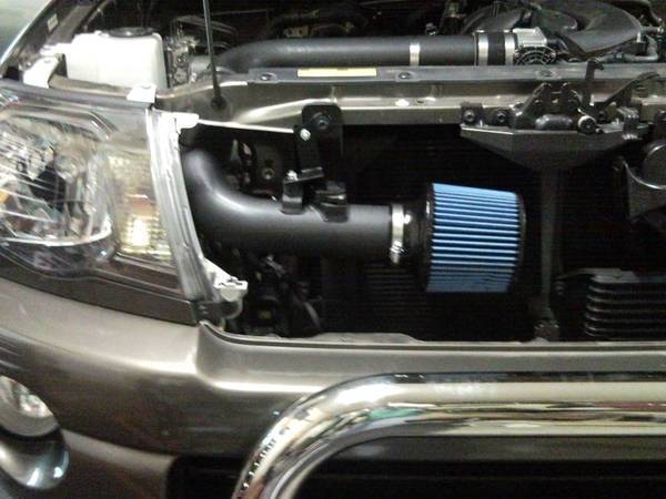

    Long story short, I sucked up some water through my URD intake, and now my AFRs are slightly off
    Here's the unabridged version:
    I decided to go driving through the monsoon this past weekend to a friends b-day party/crawfish boil, about 45mins interstate through the pouring ass rain. I have the URD intake on my Mk1 with a hydroshield. Granted i know the hydroshield is only water resistant, and not water/dummy proof, but i decided to roll out anyway.
    Along the way i could tell some water was being sucked up from the sputtering and AFRs going a lil whack and my Ultragauge letting me know my LTFTs were out of parameter (-8,8). This all was happening right before i got to my destination. So i parked the X and let it 'dry' out.
    When i headed out, i noticed it was leaning out (AFRs were really off) so i pulled into a gas station to dry everything out.
    I ended up taking the hydroshield and air filter off and using the hand dryer in the bathroom, got everything dried off (they were both dripping wet). I used some paper towels to get the water out of my intake tube by the MAF sensor. I asked the gas station clerk if i could take a box off his hands and McGivered it to act as a hard shield so that water wouldnt come in contact with the filter cone. That helped and got me home. AFRs were fine under normal cruising but my LTFTs were still out of parameter.
    Fast forward to yesterday and today. AFRs are fine under idle and cruising, however they are slightly off. During shifting it leans out, and under accel. it doesnt go as rich as it usually does. I dont think (hope) that the MAFS is completely shot b/c then i would throw a P0101 code and be limited to 3k rpm. I would have to believe that after a couple of days that the sensor is dry by now, but its not functioning 100% like it should. Can i just get some MAFS cleaner and spray it clean and hope for the best?
    or is this thing completely shot? Thanks for the help
    Update:Made sure the MAFS and plug were dry. checked the intake tube to make sure theres no residing water (dry) and disconnected the batt to see if that would trick/reset anything. No Dice, same issues. AFRs are reading near stoich even under acceleration

    I tried the CRC Maf sensor spray cleaner (along with disconnecting the batt) and still the same thing. Its weird that the sensor is showing skewed results. It seems like it would b either working or not

    Again, not driving through deep water, just rain. I dont have the heat shield/splash gaurd, but its on order now

    I have a MK1 s/c kit, i promise im getting a lil more than a few hps from my setup lol. I have an injen shield on the way. I know the hydro shield i have on there now is only water resistant, but i will have an actual shield on there soon. I'd really like some help/opinions/suggestions on the MAF sensor situation lol

    I ended up getting another MAF sensire out of another taco with 26k mi. I put it in and drove around. Same issue. I got home and clean the maf with the sprayed it with cleaner and disconnected the batt to reset the ecu.
    Same problem. Now that the MAF sensor has been eliminated in this whole ordeal, what would b next in the diagnosis process to start testing/replacing?

    I went to the gas station and as i was pulling out the truck nearly stalled out and my AFR read 10.0 . I thought wtf, did i just stall out, but i was in first and when i got it going o threw a P0103 code. Which is the MAF signal output high. And i looked at my mass airflow g/s on my ultragauge and it was at 323, so yeh a bit high. And now im idling with AFRs in mid 13s
